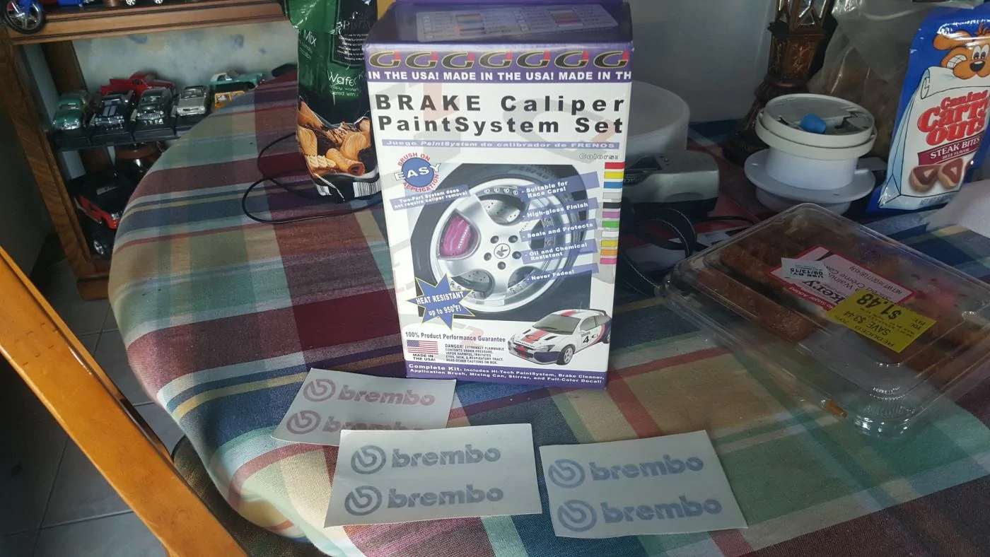

A buddy of mine did these on a cadillac ctsv. I was going to powder coat until he showed me this. Just had to take the wheels off, mask off rotors and spray:
The only issue is he said the blue coating was a clear blue coat, being that the base color on the cadillacs brake was a light silver, the blue showed through pretty good while leaving the V logo still visable. I don't know if we will get the same results on our performance pack brembos. If someone wishes to try it, i attached a photo of the products.
Excatly what I'm going to do:headbang:
