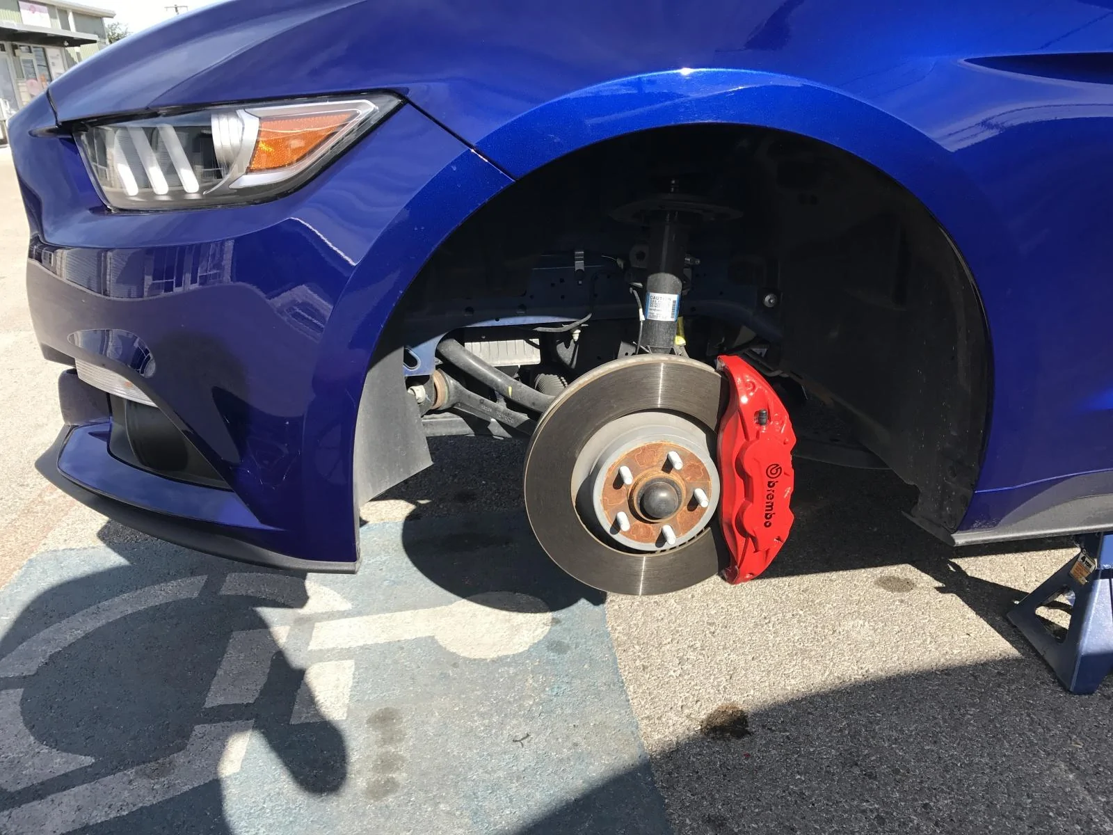

So is it best to just paint the whole caliper then reapply a brembo sticker? It seems difficult to tape off the small thin brembo sticker
That's what I did. Heat tolerant Brembo stickers are inexpensive. You can find them online. :cheers:
