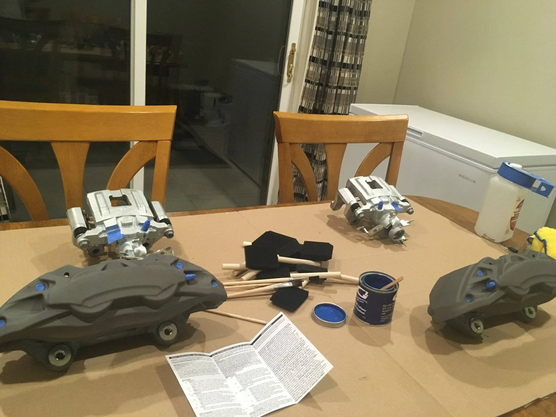

Leave it on, you don't want anything getting in there. Wrap a small piece of outdoor painter's tape around it tightly.

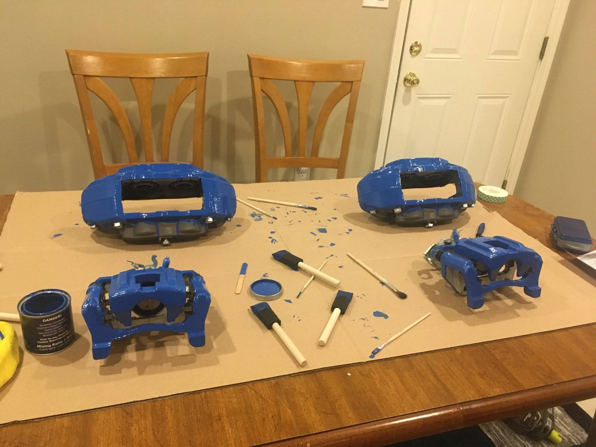

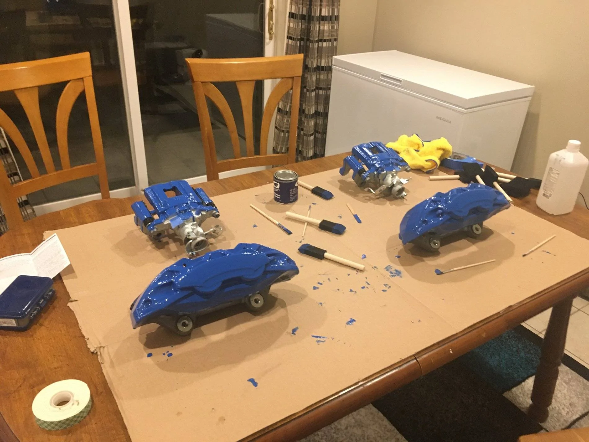

Here we go guys. I’m waiting for the 5 minute after mixing to stir and go on ahead.

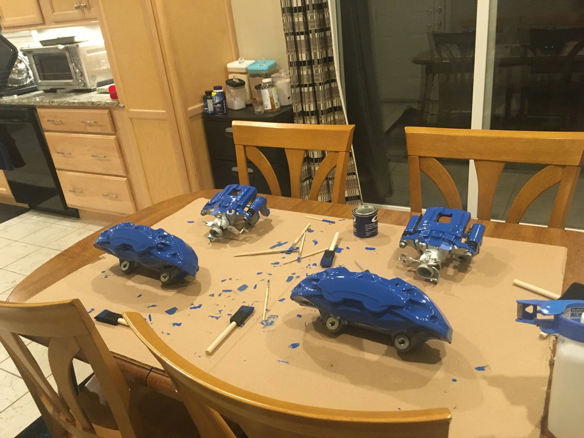

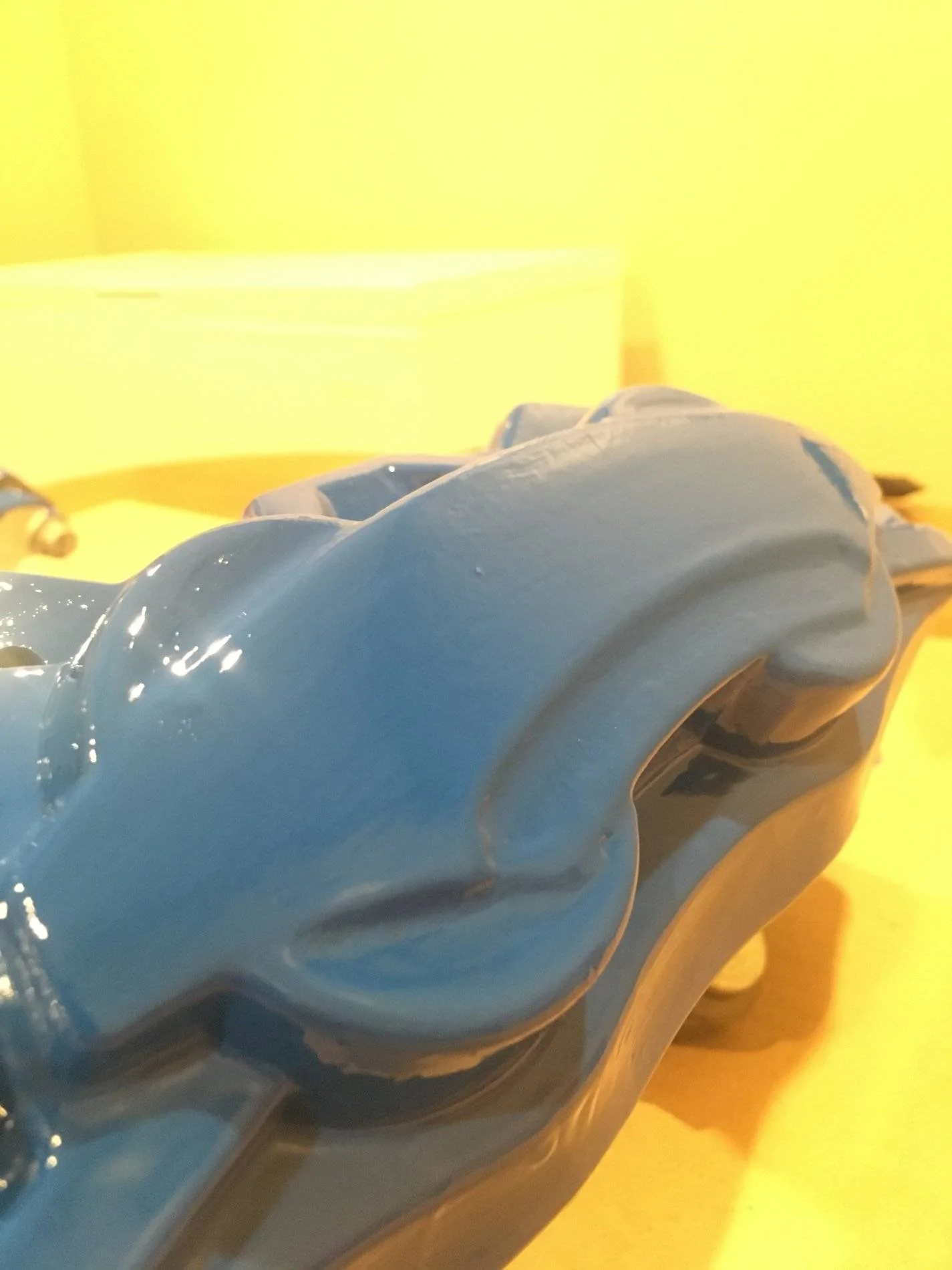

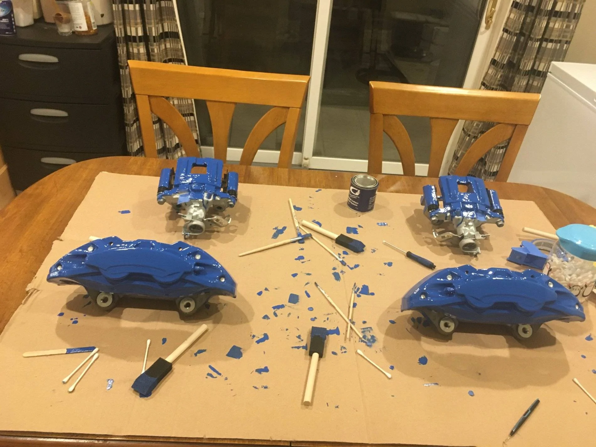

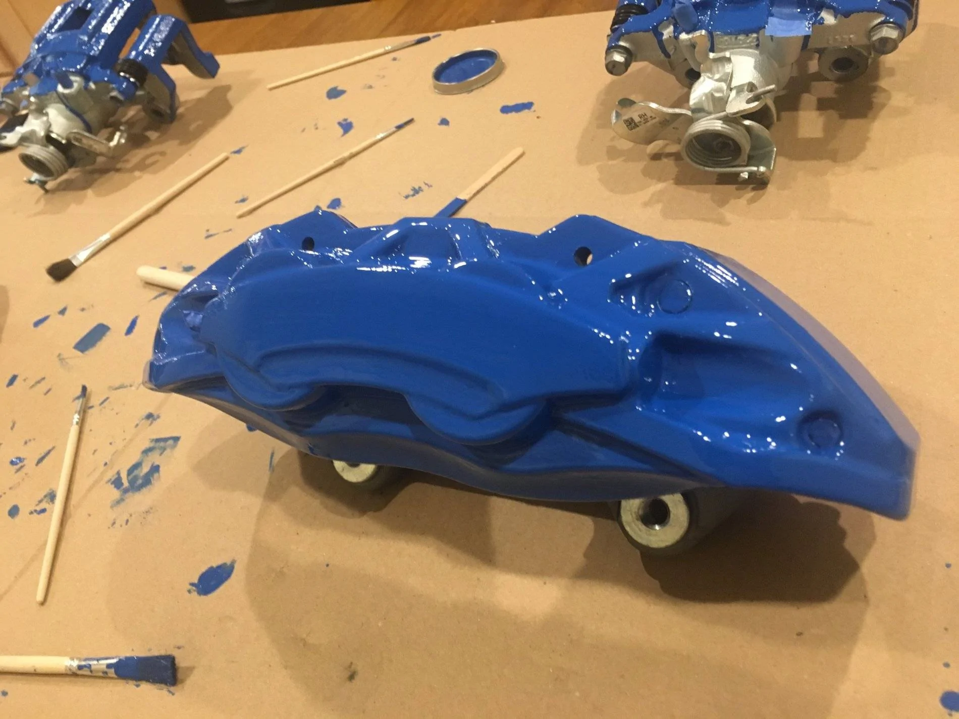

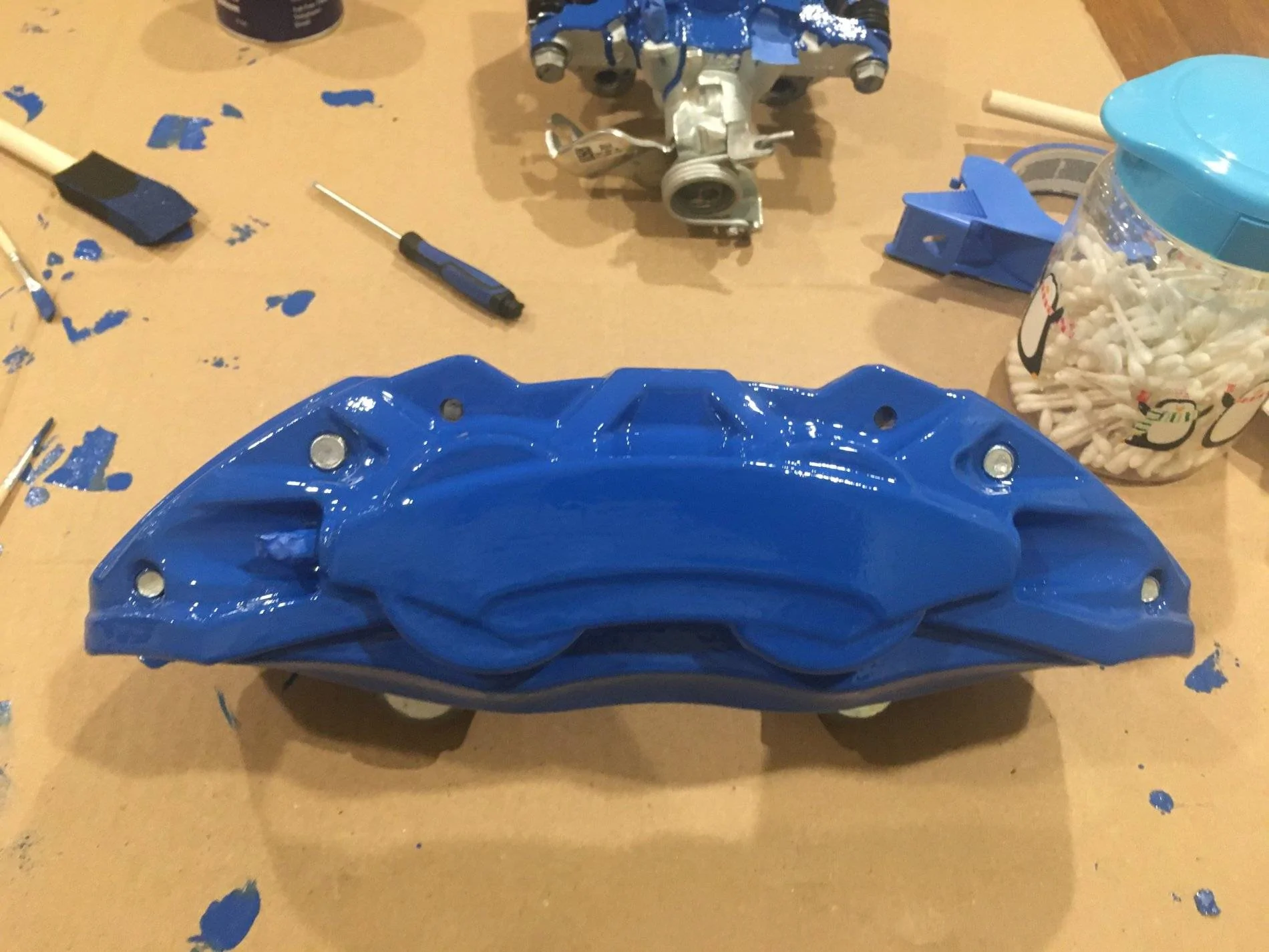

Idk how many coats I have but it’s kinda looking like glass.
Waiting 15 minutes from right now and doing one last coat, I have extra paint but I don’t see a point doing 10 coats?

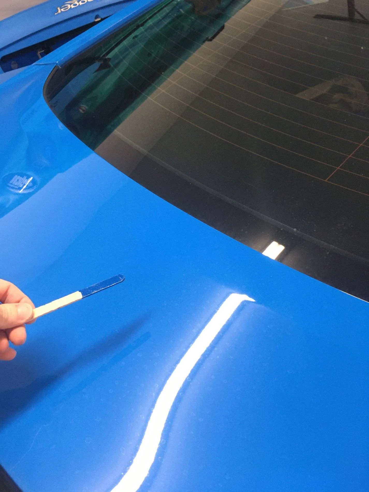

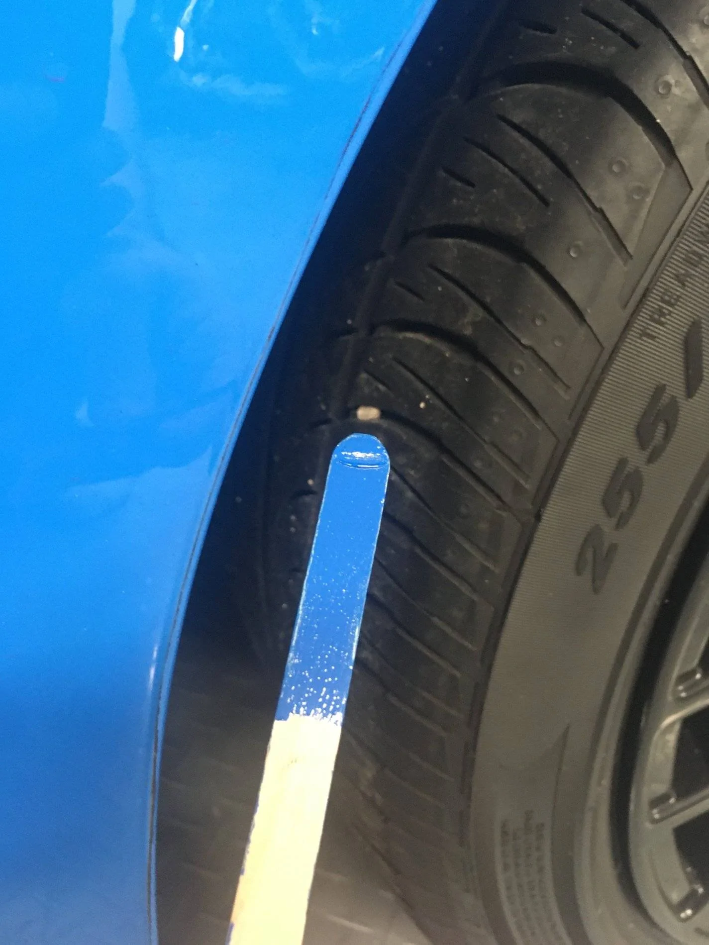

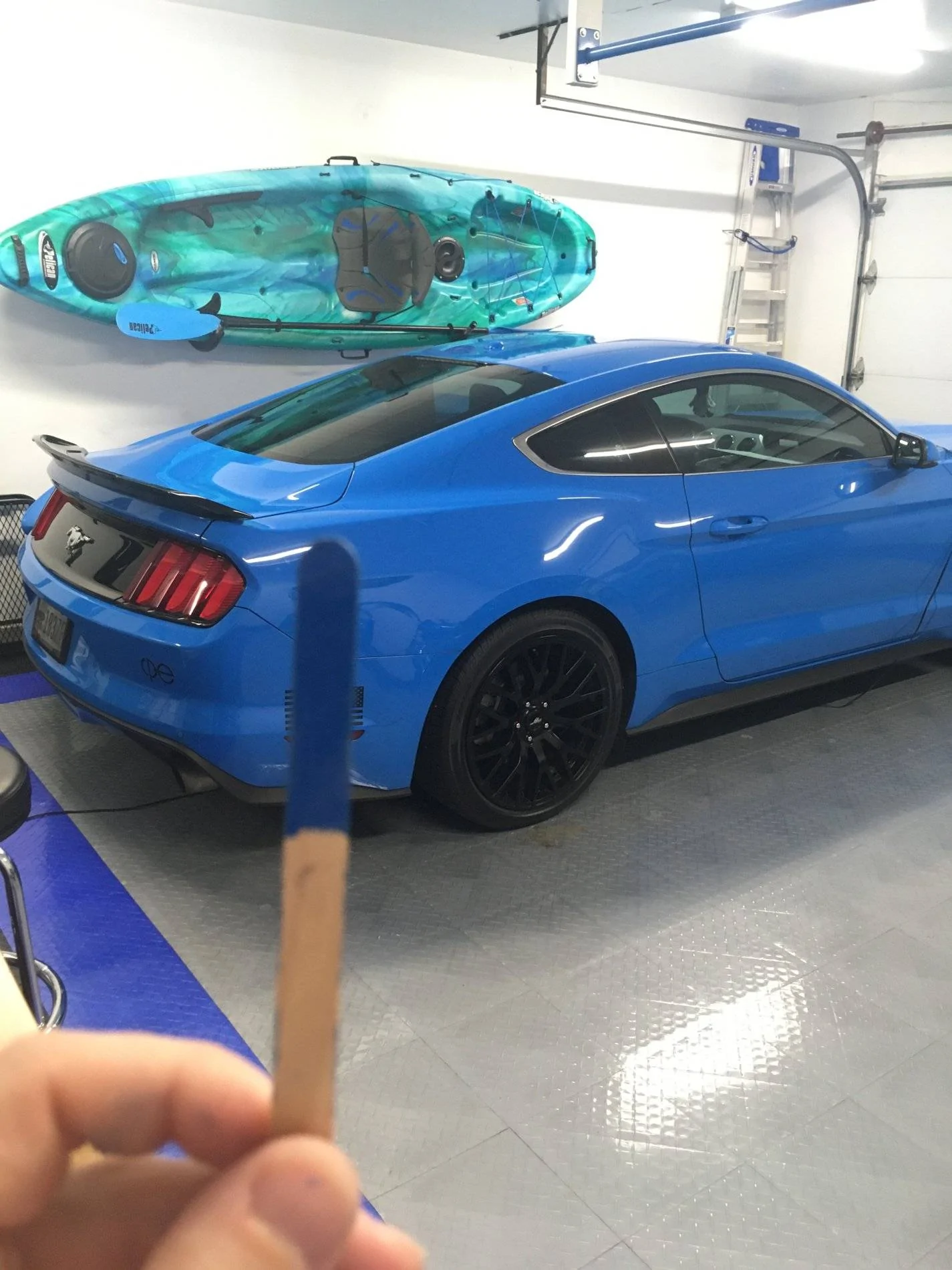

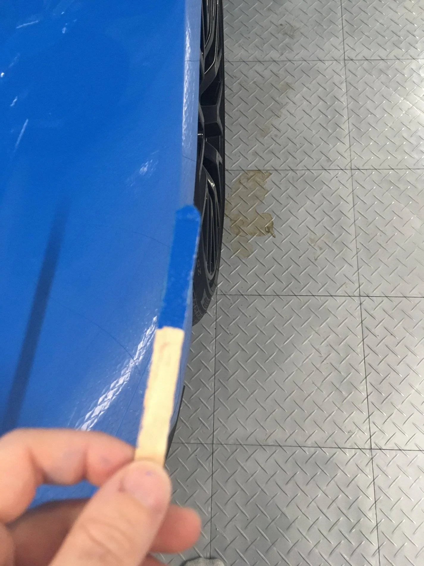

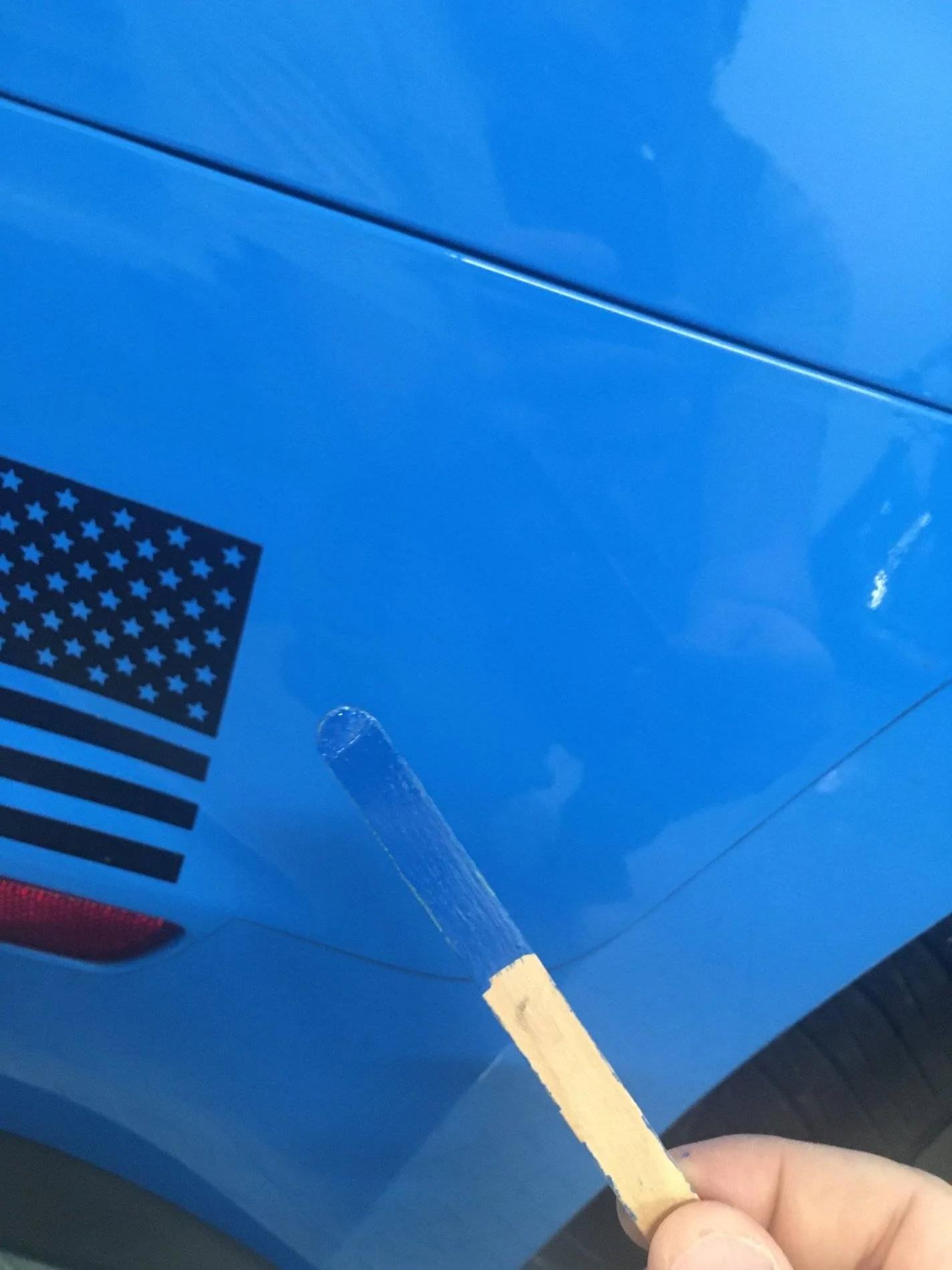

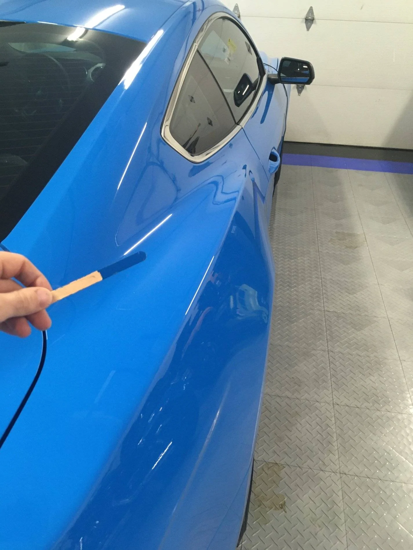

I know, that has passed my mind as I painted, I took the little stick I used to stir and compared, it does not match it on top of car, but on the side in the shade in my LED garage it matches the darker part. It says G3000 on the kit (which is custom color) if it is a flat out wrong match. I will be upset. It may still work though.

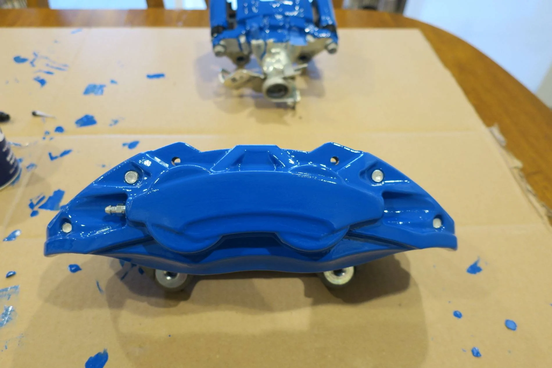

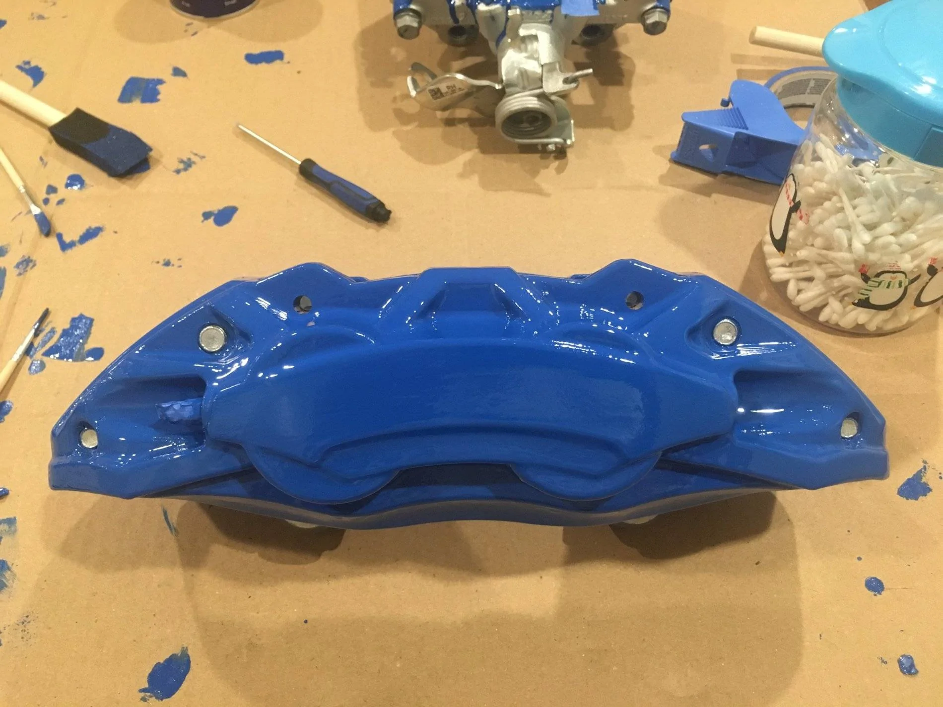

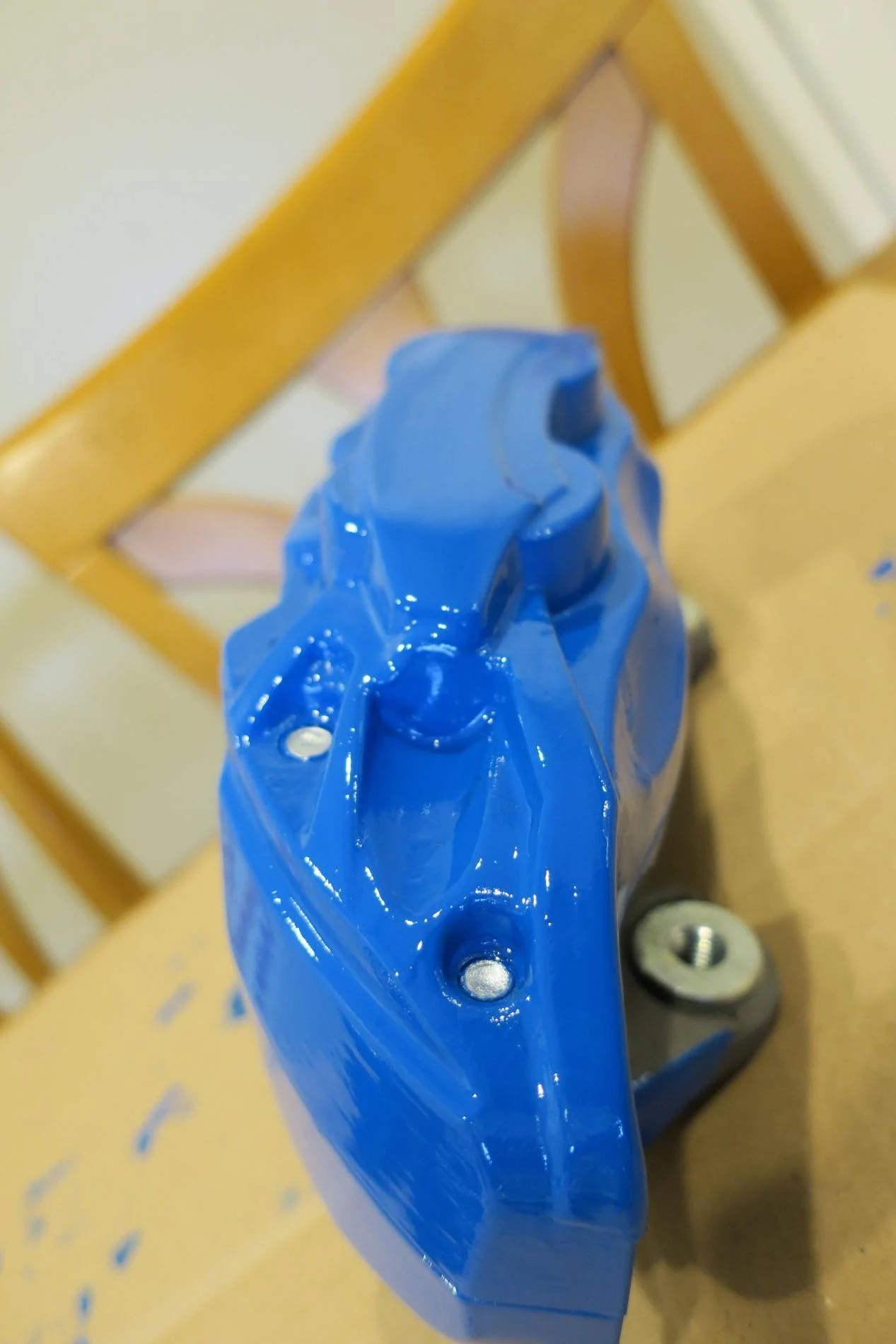

Several photos I just took. I just took off the tape over the little silver pins, and tried to clean them up best I could. Pretty happy with it. Looks nice enough.

Random- I didn’t try yet. Does the black thing pop off or screw off? The bleeder cap
Pops off. Tape it up. If you get it coated in paint it’ll be harder to remove. Absolutely do not get paint on the bleeder valve. Just tape it all up. Bolts too. Will look better for it anyhow

Looks like you did a good job. My other point was going to be to stir and stir and stir that paint all the way through the process. Keep stirring as it settles. That’s how you get a smooth finish. But by your pics you’ve done a great job.
FWIW If it doesn't match exactly, it will not be noticeable because of the lighting behind the wheel and distance between them and the fenders. The eye expects paint to look different depending on light and angle so will assume the difference is from that.
mavisky
Nov 17, 2018
2,401
3,303
Cumming, GA
Kyle
2018 GT350
My orange fury was a pretty close match, but missed the metallic flake obviously. Behind the wheels and out of direct sunlight though the match is solid enough to pass the eye test.
