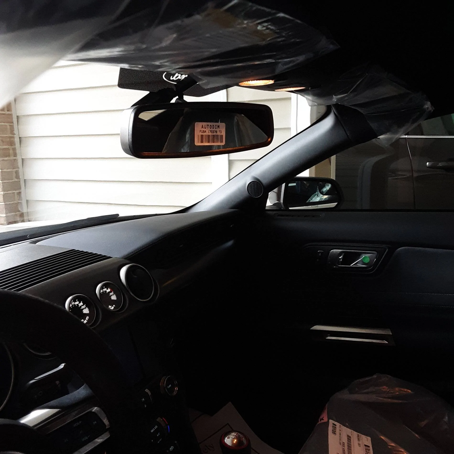

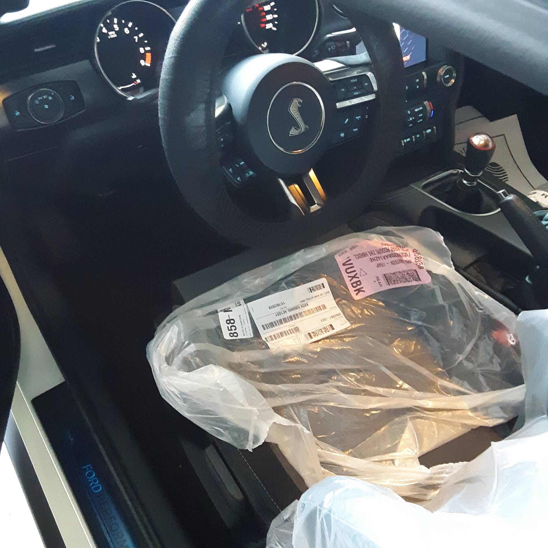

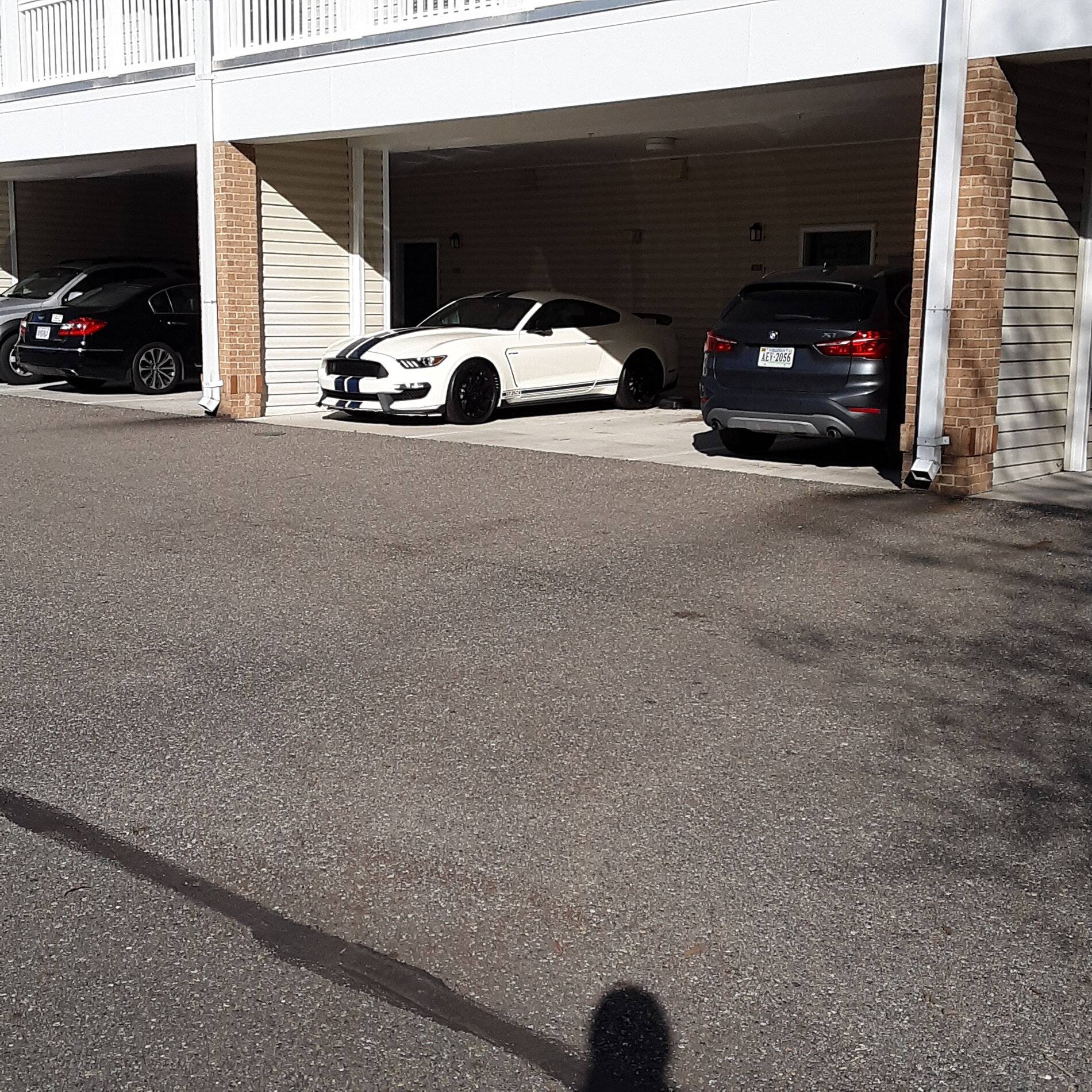

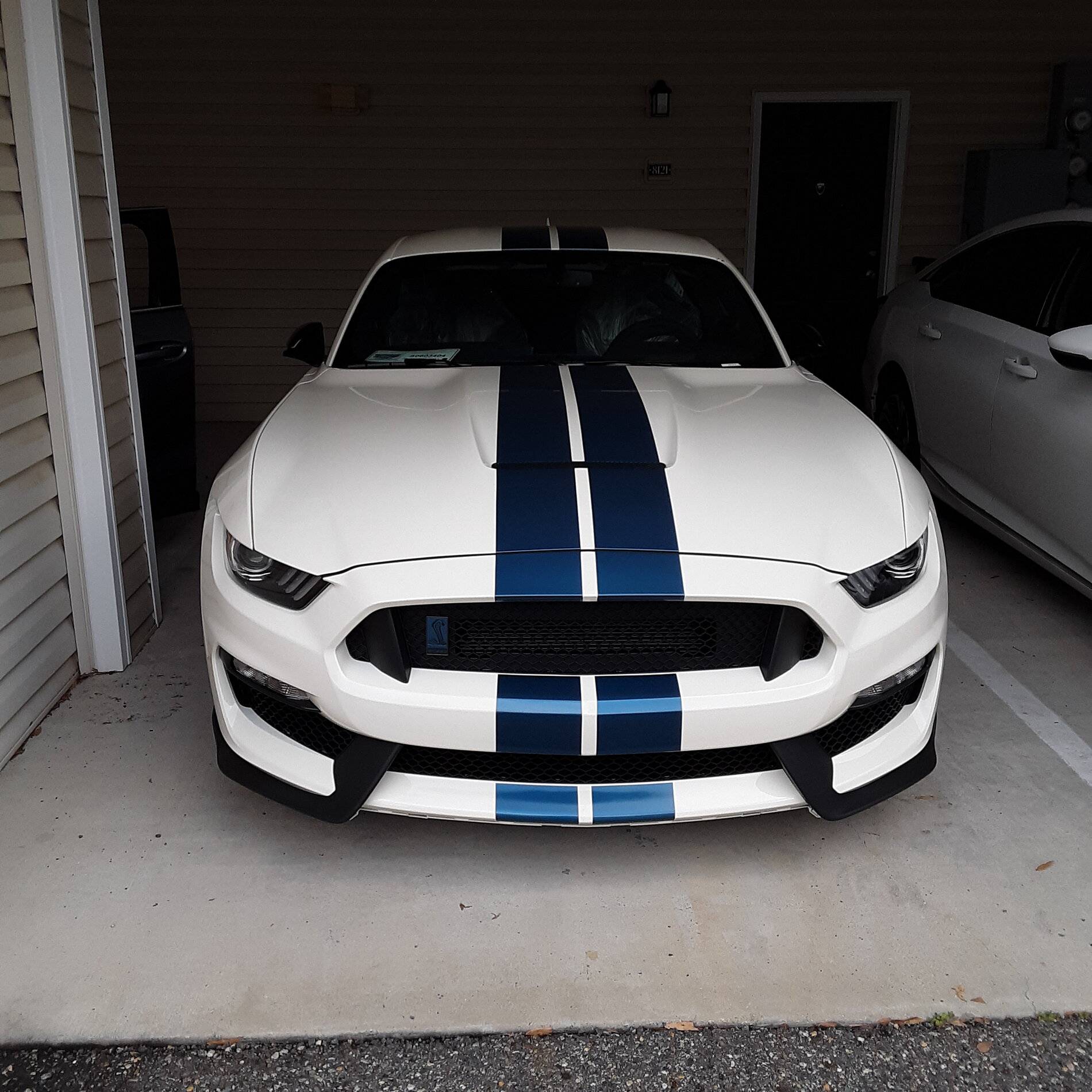

I've only driven my HEP Shelby 350 twice since taking possession(5 miles) and she still sits mostly wrapped in factory plastic lol. This is a fourth car and will mostly sit, but we do plan to keep long term. That being said, she sits in covered, but exposed parking (for next six months) and all future washings would be mobile detail etc (we live in a condo community temporarily) and our permanent residence in Las Vegas will be a high rise with underground parking.
I am not a paint guy, and know nothing about paint preservation or upkeep. Most of our high end cars are/were leases, and went through touchless car washes ...sorry...😳. I notice many members getting paint correction, ppf, and ceramic coatings done. I would like to go down this road, but dont want to throw money away. I Would love to hear what other members recommend and what you feel is a waste of money. I dont have an R, so there are no carbon bits, but are there any areas that need extra protection? I worry the most about the vinyl stripes (going to have painted in Vegas) and reducing brake dust. I am super OCD about glass, and HATE haze/glare little specks etc.! Is there any product that could be applied to keep the glass spotless inside and out? I know the back window in the Shelby is almost impossible to get to lol. I appreciate any advice or pics of work that has been done. I am in the Hampton Roads area of Virginia, if anyone has a preferred shop? I will post a link of the shop I am considering. I plan to stop by and get a paint education and of course a quote. I am sure they will say the paint needs correction, full PPF and nine coats of ceramic.
Thank You!

Here's from my experience doing PPF, ceramic coating, and paint correction to my HEP. Do not wrap the stripes or side stickers in PPF. When the time comes to remove the PPF (due to chip damage or age), they will also remove the stripes and stickers. There's no way to remove the PPF without also peeling the stripes and stickers. They remove the PPF with a steamer, and the heat will also peel off your stripes. The stripes on the HEP are very expensive. Just those on the trunk and bumper plus the side stickers (if you choose to also protect the rocker panel with PPF) are about $1500 dollars.
See if you can work with an installer that can avoid wrapping the stripes in PPF. Most brand names like XPel have pre-cut pieces that don't cover the sticker. The installer needs to assure you that comes time to remove the PPF, they can remove the film pieces next to the stripes without affecting them.
Ceramic coating is good for both paint, stripes, and PPF. The only downside is that you need to make sure you don't let water beads dry on your car and they are either wipes out gently with a microfiber towel or you use an air blower. The ceramic coating causes the water to beads up and if it dries, it may leave permanent watermarks.

Also if you cover the stripes and the rest of the paint in one piece of PPF, there will be an air margin visible between the stripes and paint. That's because the stripes create a small vertical edge with the paint. It's a few millimeters, but it is visible if you get close to the car. Looks worse on darker color cars than on the HEP Wimbeldon White. That's another reason not wrap the stripes.
But keep in mind that PPF edges will collect dirt and it will be visible against the white color of the car until your next carwash. If I have to do it all over again, I'll most likely just do paint correction and ceramic coating and skip the PPF altogether.

I will absolutely leave the PPF alone near the stripes, thank you for that information! To be honest the PPF (if not tracking or daily driving) seems like overkill? This is assuming a high quality, multi layer ceramic is used?

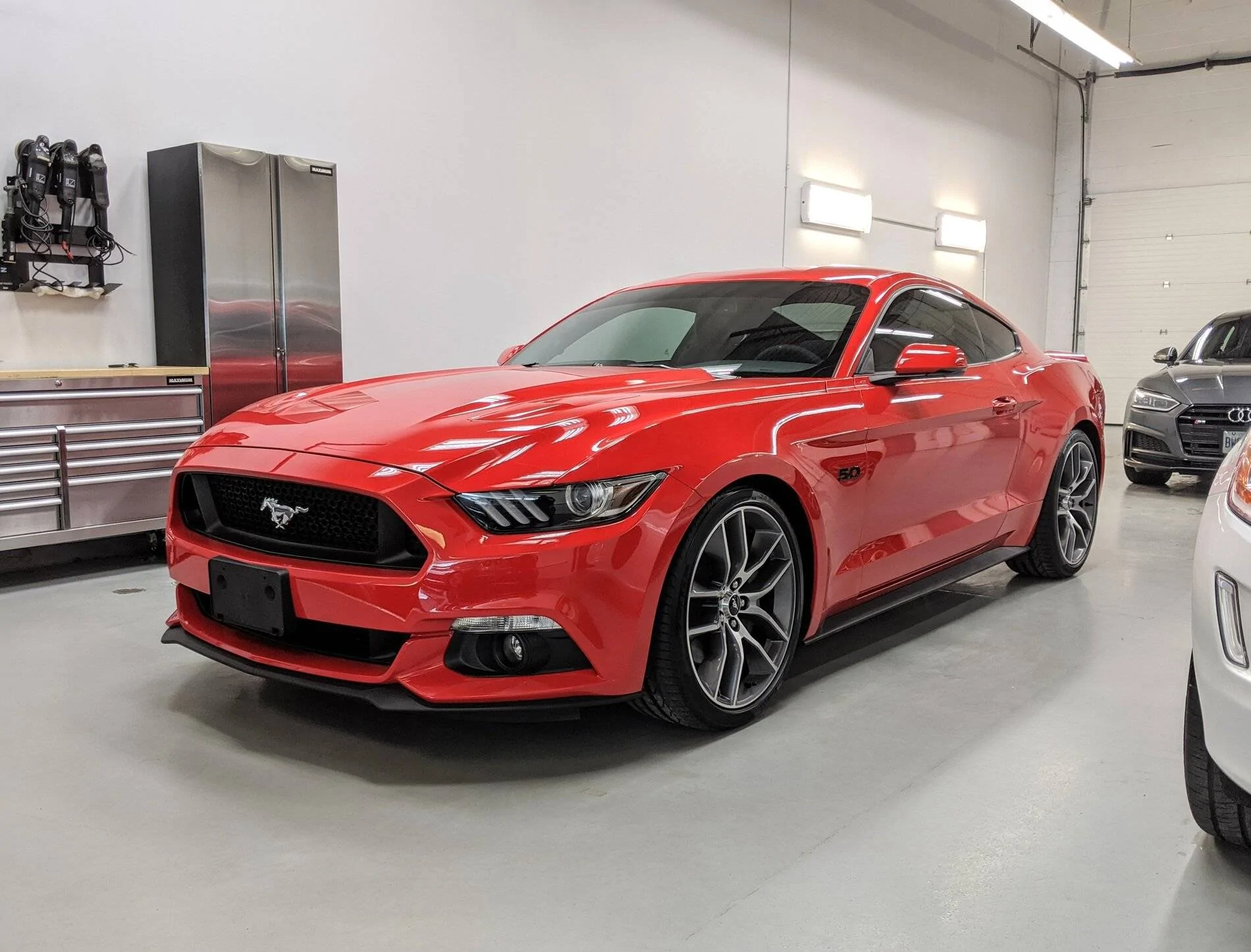

Ceramic is a sacrifical layer microns thick. It won't prevent paint chips / scratches. It aids in keeping the car cleaner / easier to wash / prevents swirls if using proper washing techniques as well as stops water spotting and clear coat etching. However it's not indestructible.
The paint on these cars is quite shitty. It's actually brittle. On my infinitis the paint will indent / chip but on the mustang it's almost like the chip explodes out of the impact area.
First have the car paint corrected. Regardless if it's brand new this is the first step.
After that I had my entire front end ppfd. Entire hood / bumper / front fender and lights.
The lower door portion / door sills done.
Impact area in front of and behind the rear wheels.
Side mirrors
12" strip on the leading roof edge and the A pillars lining up with the 12" roof strip.
After all that cquartz finest reserve ceramic was applied to the whole car as well as another c quartz product that's made to go over PPF.
This will mitigate most / all of the rock chips your going to get.
The material I had applied was Stek Dynoshield. It's better than expel ultimate or any of the other shit regardless of what your installer will tell you. It's a bit harder to install which is the primary reason your going to get these answers.
Stek also is self healing and has a smoother surface than xpel / 3m. Stek looks like polished clearcoat nice and smooth you can't even tell its there, where as xpel/3m has some orange peel look to it. I've had all 3 on various vehicles and it's Stek or nothing for me.
It's not cheap but neither was your car.
End result, the pictures even tho amazing don't do it justice. The car literally looks like a wet piece of shiny candy.
