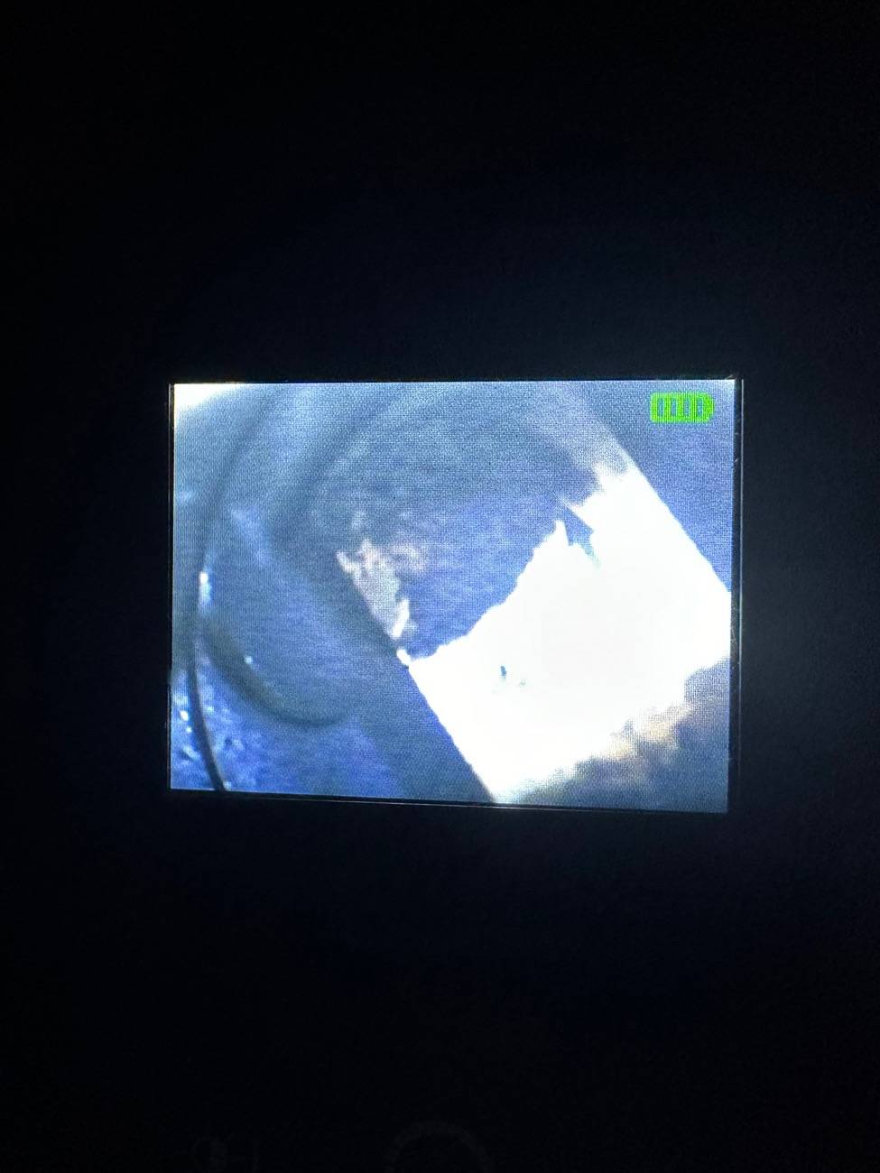

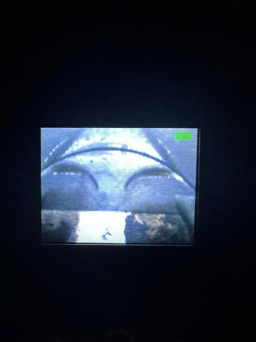

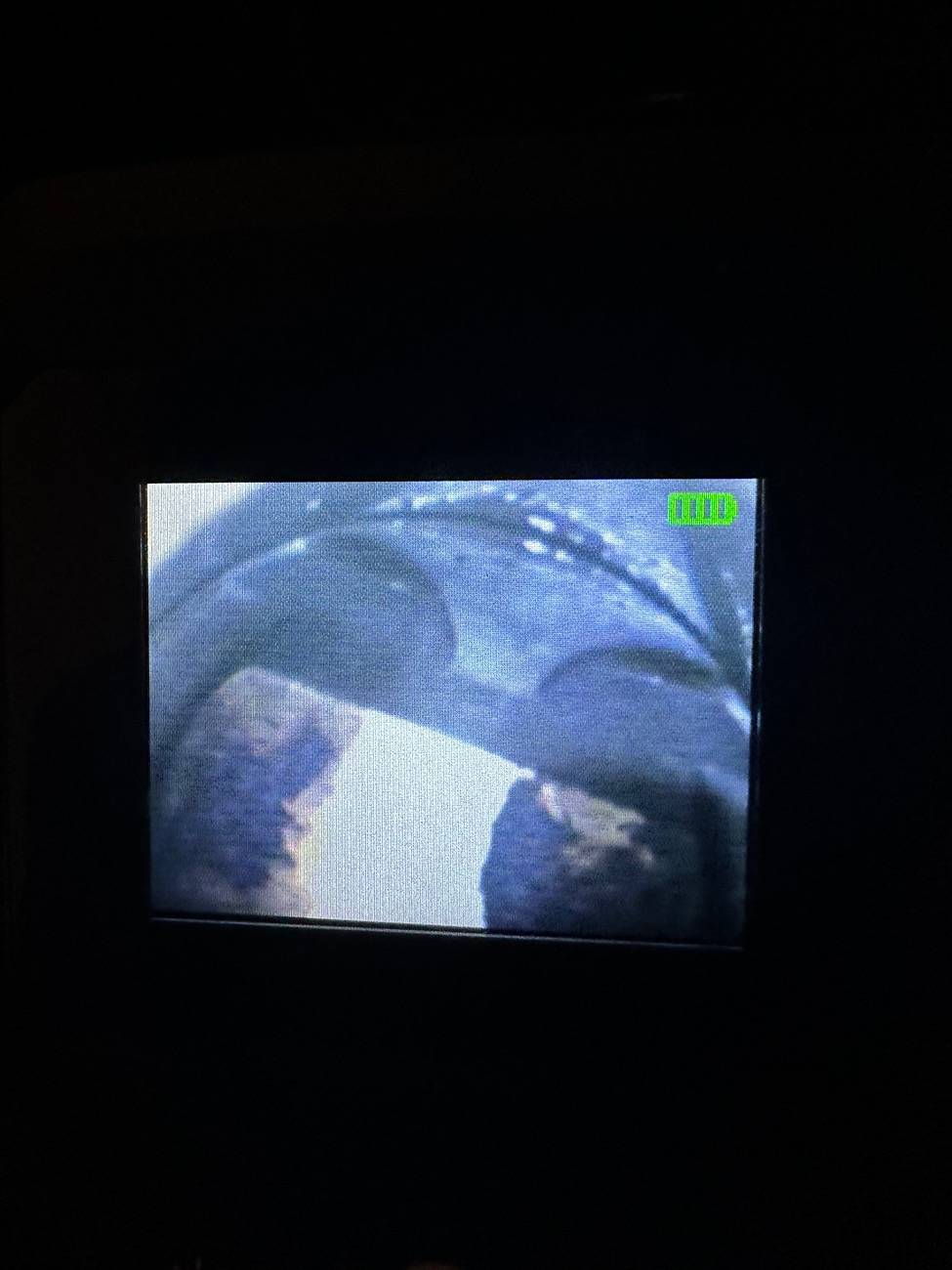

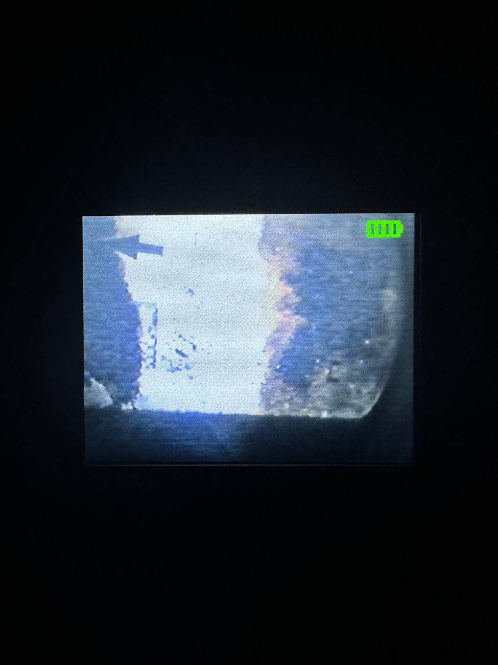

Got the piston a bit lower and got some better pictures. Looks like the last picture is potentially where the ringland failed on the top? What about the excess amount of soot?

If the compression is that low, that could account for the discoloration. Not getting a clean burn. I don't see anything that screams broken ringland yet. It could be a bad ring itself or a valve issue. Next step is probably pull the head and get a good look.
