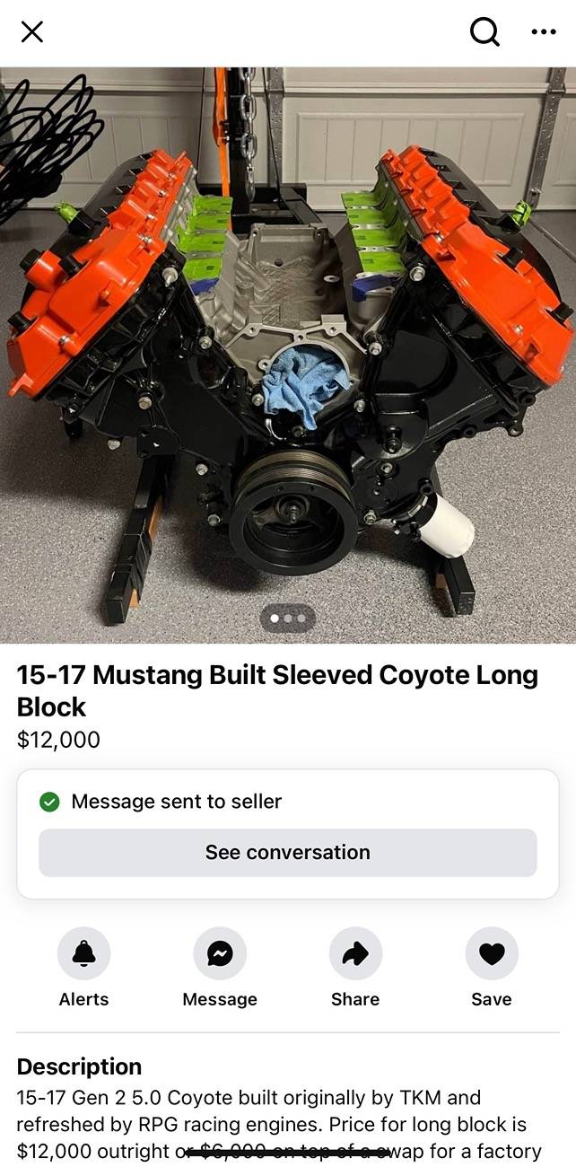

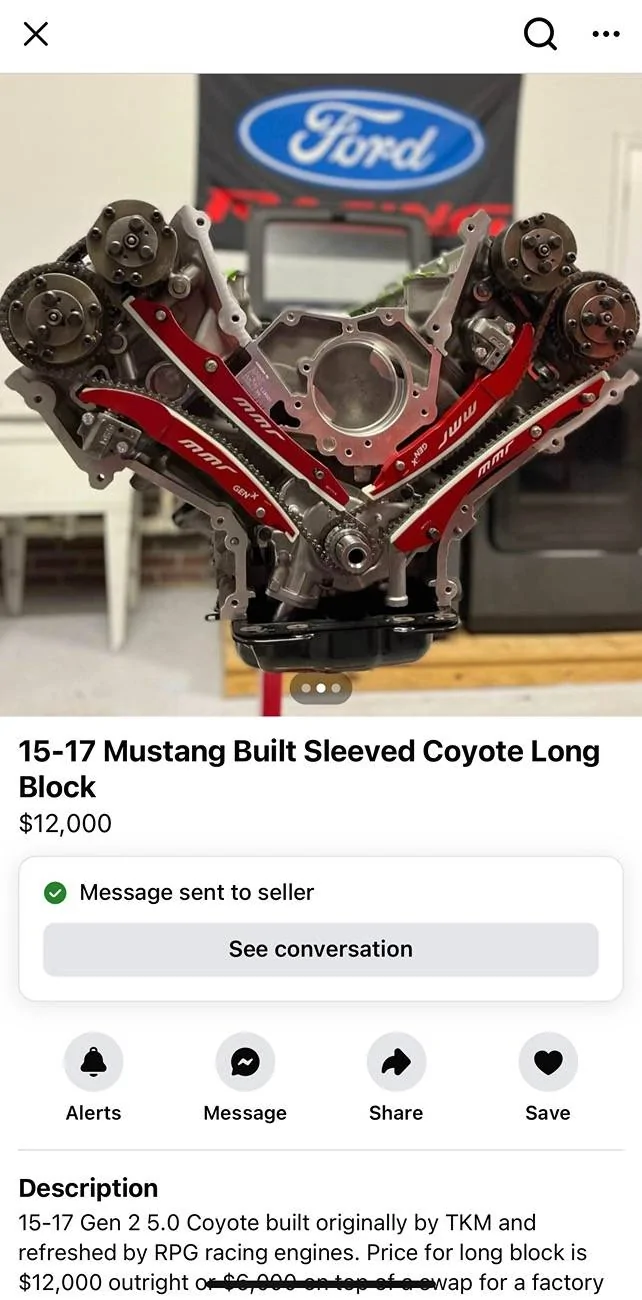

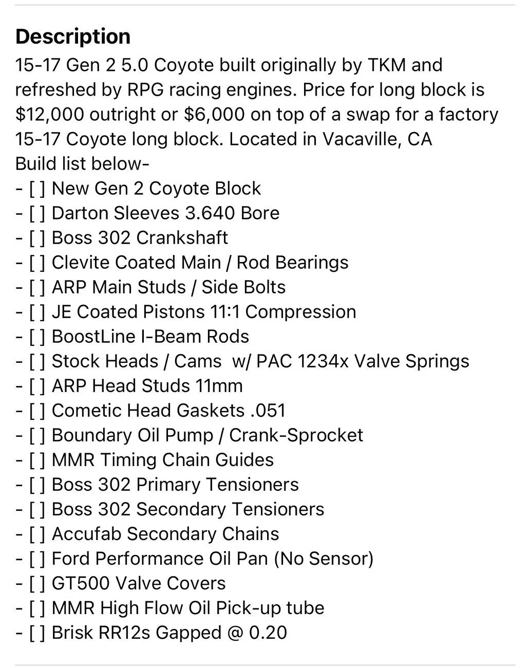

I actually just found an engine local to me that may be a good idea. If I picked this up, pulled out the current engine and threw on a factory gen 3 block and sold the current engine I’d be in less money on a built long block than I would on just a built short block.
