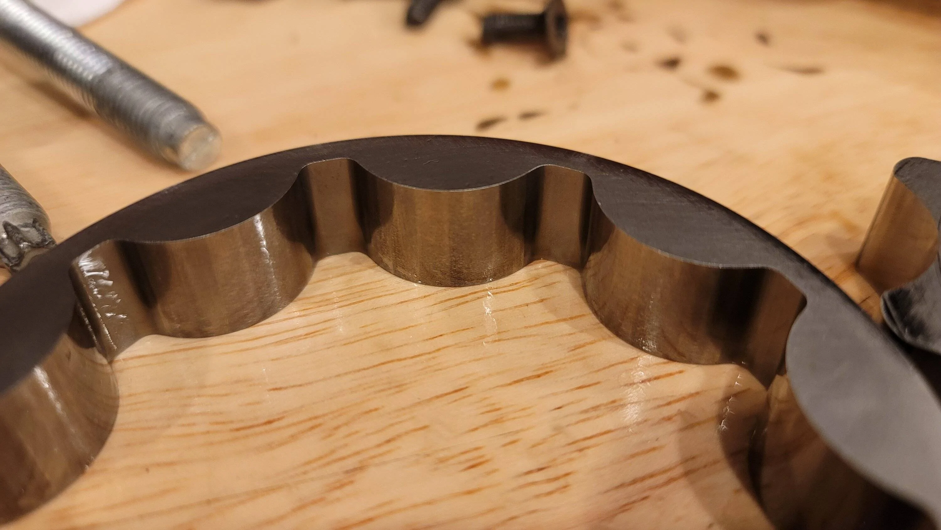

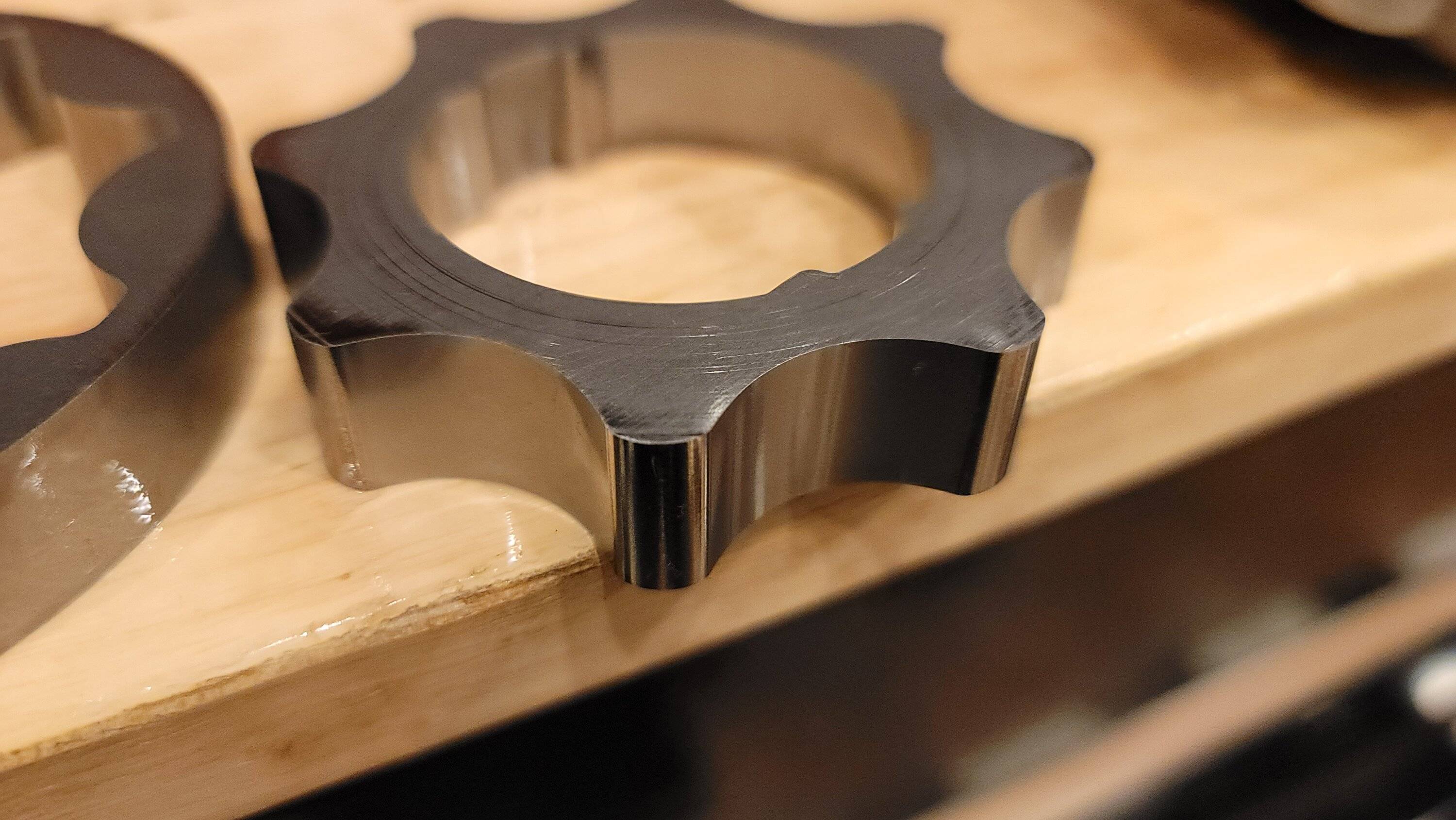

I've ran Boundary for a while with a bunch of low 9sec passes. Chewed up and scored badly (pics in my build thread). Appeared too soft for the application in my untrained opinion. Now running Ford Performance gear with quite a bit of low 8 sec passes. FP says forged units produced by oem manufacturer. I pulled them recently to inspect, look perfect!!!!
