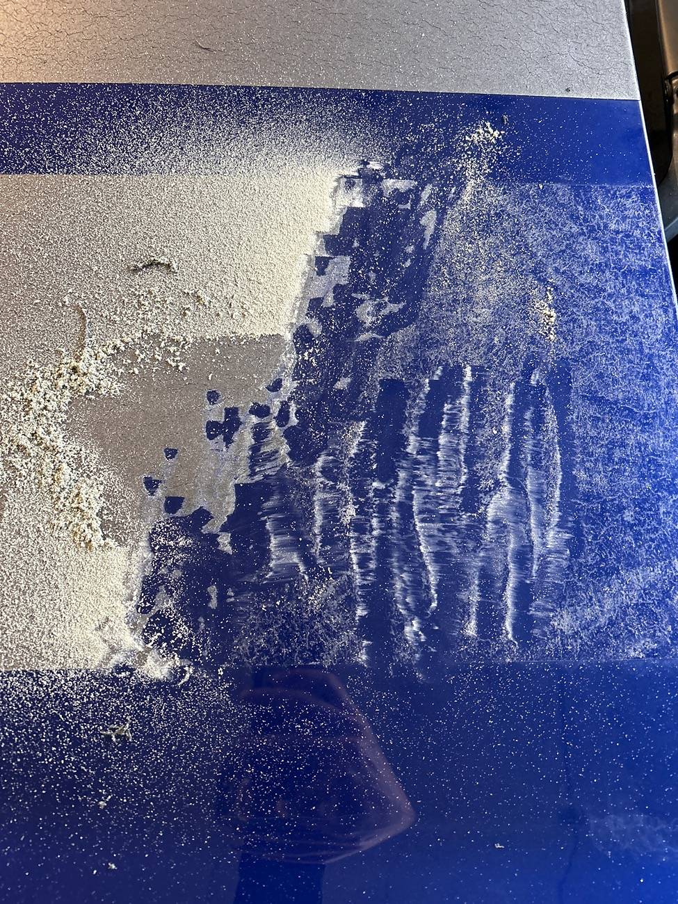

I’m going to lose my mind scraping my old vinyl stripes that are cracked and baked on. Picture is from an hour of work. Any tips to make this go quicker?

After wasting 3 hours I bought an eraser wheel and now I won’t kms :) Thanks for the tips. With how baked in these are, heat didn’t really affect anything. I’ll end up buying some cheaper ones online to do the rest of the stripes and report back on how those compare.
