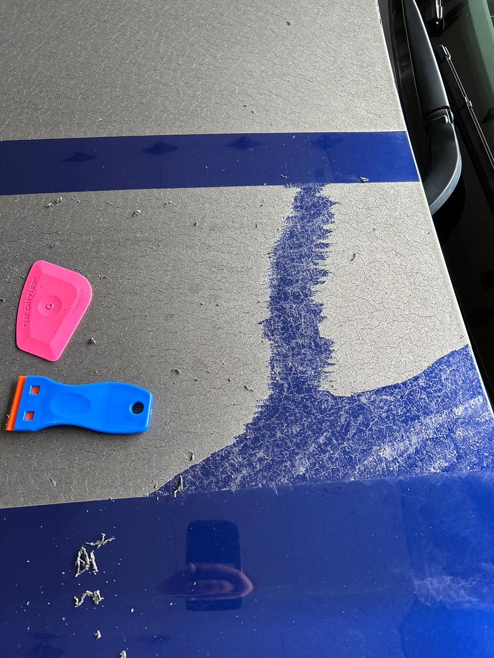

I’m going to lose my mind scraping my old vinyl stripes that are cracked and baked on. Picture is from an hour of work. Any tips to make this go quicker?
I used a hairdryer, then cleaned the glue off with mentholated spirits.. then Wash the car with a good carwash, to wash the metho off. Then polish.
