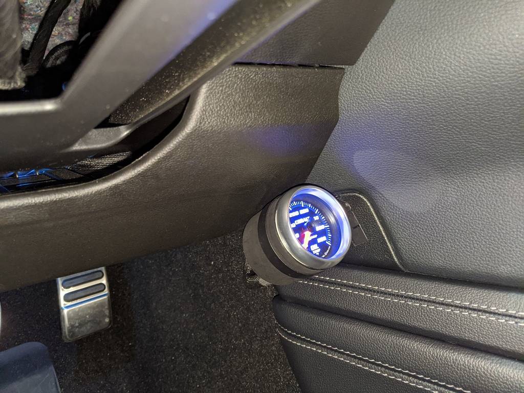

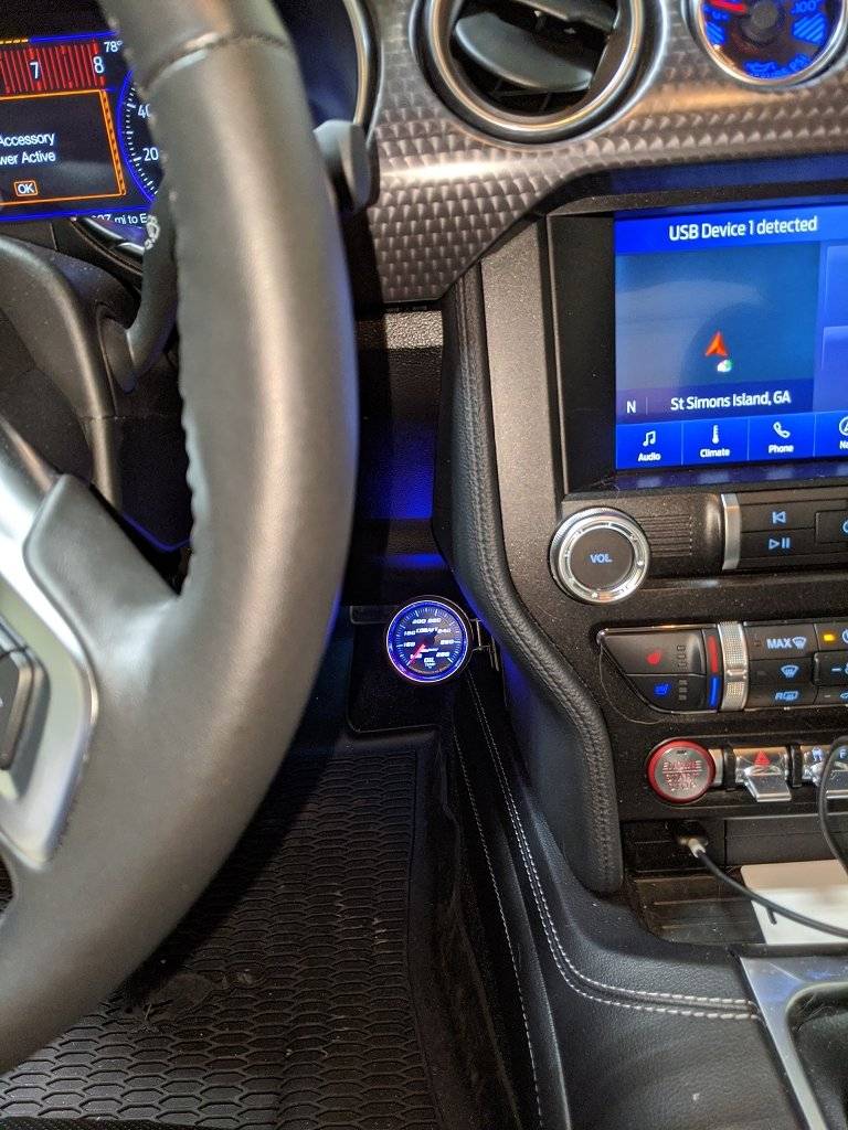

I would like to install a real oil temp gauge in my 2018 EB PP car. I have the Mishimoto oil cooler installed, and like others noted on this thread, it appears to have little to no effect on the inferred oil temp shown in the gauge cluster. A couple questions for those who have installed a real gauge with oil temp sensor;
1. What gauge did you go with?
2. Where and how did you mount it?
3. How do the actual oil temps compare with the inferred oil temps?
Thanks.

1. I have an AutoMeter Colbalt oil temperature gauge.
2. No problem for me where I mounted it because I use it to confirm oil is hot enough to run hard.
3. My EB does not show inferred oil temps

Interesting, so for the 2020 EB HPP they installed a oil temp sensor and converted it to a real gauge? You are lucky, all of us regular EB and V8 owners get stuck with the stinkin' inferred oil temp gauge.
Thanks.

No it does not come with the sensor. The AutoMeter gauge comes with a sensor. I installed a Mishimoto filter adapter plate that has a port for the sensor.
