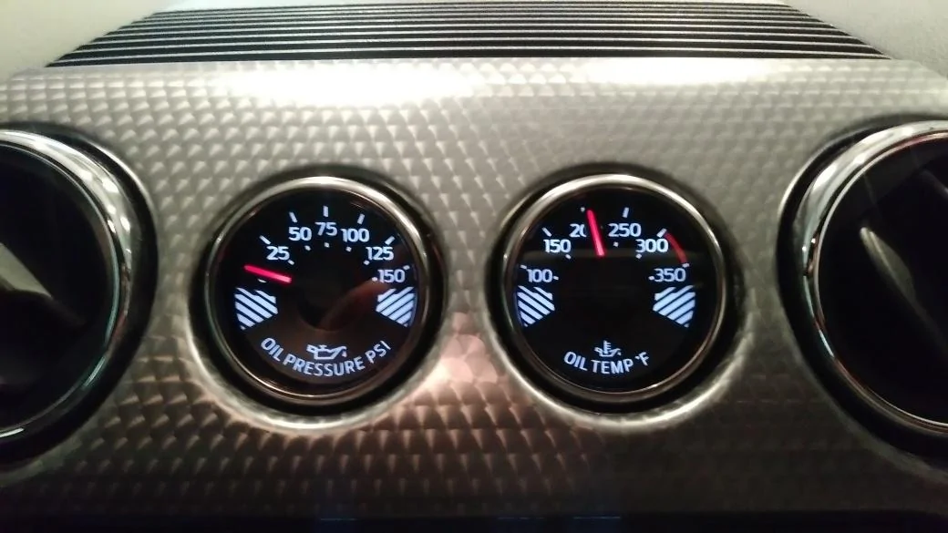

Change the center PP dual gauge module to a GT350 one. 2nd gauge is oil temp instead of useless vacuum. Plug and play, no programming or mods required. Gauge is smart enough i guess. FR3Z-10849-E. Got this idea from Brevees.
I can't tell, did you swap the shiny trim from your vac cluster over to the temp cluster? It looks like the trim ring piece can be removed with just the screws.

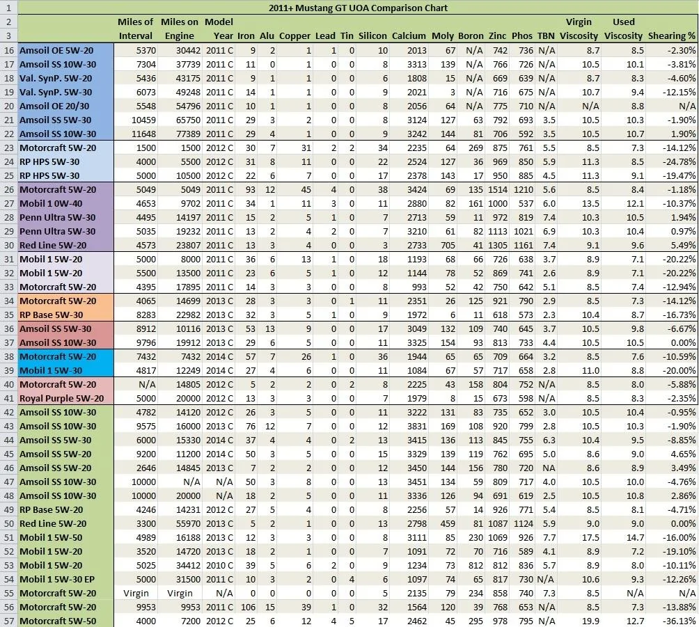

I used this UOA (Used Oil Analysis) data summary to help choose an oil. Note that Motorcraft and Mobil 1 seem to shear down quite a bit.
Ouch!
Thanks for the info. What was the source?

Ouch!
A different Mustang forum (svtperformance), which will not link from this one because it must be viewed as 'competition' or something.
