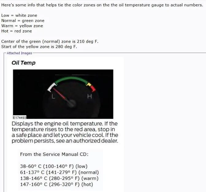

I have a real oil temp gauge (and also an aftermarket oil cooler) and on track at a very hot 90+ degree day, my 5W30 oil did not exceed 260* at worst, more around 220-240*.
The GT350 oil temp gauge is a calculated value; as is the virtual gauge on the dash. I had it and the calculated value is relatively accurate so long as you have not changed any element of your cooling system.

I still think people are overestimating the need for such (implied) precision here. As long as you know where the red starts - and agree that it has been well-set - you should be perfectly fine.

You seems to be one of those person that always want to be right, regardless of the facts and always want have the last word
Re read my original post..... The only reason we know at what temperature the red start is because DickR was nice enough to post the info from the FSM...NOT because the gauge indicate it.

I would think the oem sensor in the '15 up is just as good. In fact if it gets too hot it wouldn't surprise me if it would throw a check engine light.
As others have mentioned, there's no oil temp sensor. It's a calculated value based on run time, load, coolant temp, etc.

Snipped from a thread about the same subject.
