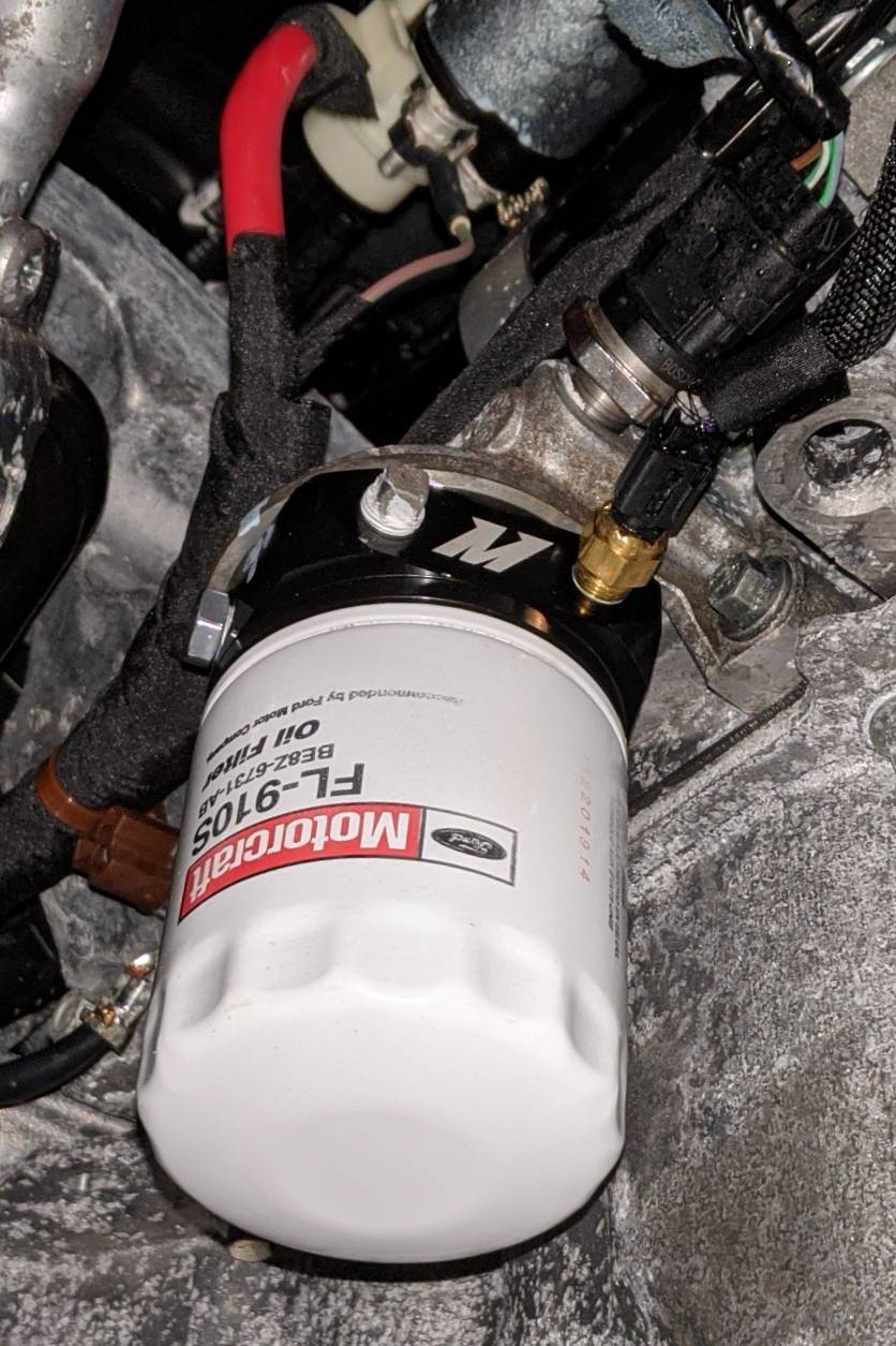

No it does not come with the sensor. The AutoGauge comes with a sensor. I installed a Mishimoto filter adapter plate that has a port for the sensor.
OK, then the oil temp displayed in the factory cluster is probably an inferred temp as well. The problem with the inferred temp is that it will not change when you install an oil cooler (as I did as well). The calculation is not aware of the additional thermal capacity, so it just keeps calculating oil temp as before. This isn't a problem until it hits the "yellow" range (280, I believe). Then the ECU starts pulling power. This is a bummer for HPDE events.

I would like to install a real oil temp gauge in my 2018 EB PP car. I have the Mishimoto oil cooler installed, and like others noted on this thread, it appears to have little to no effect on the inferred oil temp shown in the gauge cluster. A couple questions for those who have installed a real gauge with oil temp sensor;
1. What gauge did you go with?
2. Where and how did you mount it?
3. How do the actual oil temps compare with the inferred oil temps?
Thanks.
I have this
https://www.autometer.com/2-1-16-oi...gqsindMg3_1fEgOYJ6vRKIF5Lu0ZszWxoCurUQAvD_BwE
I mounted it to a side pillar
https://lmr.com/item/ATM-12135/mustang-autometer-a-pillar-gauge-pod-15-17-12135
This pillar I'll tell has an ok fit. Not perfect :)
Hope this help

No it does not come with the sensor. The AutoMeter gauge comes with a sensor. I installed a Mishimoto filter adapter plate that has a port for the sensor.

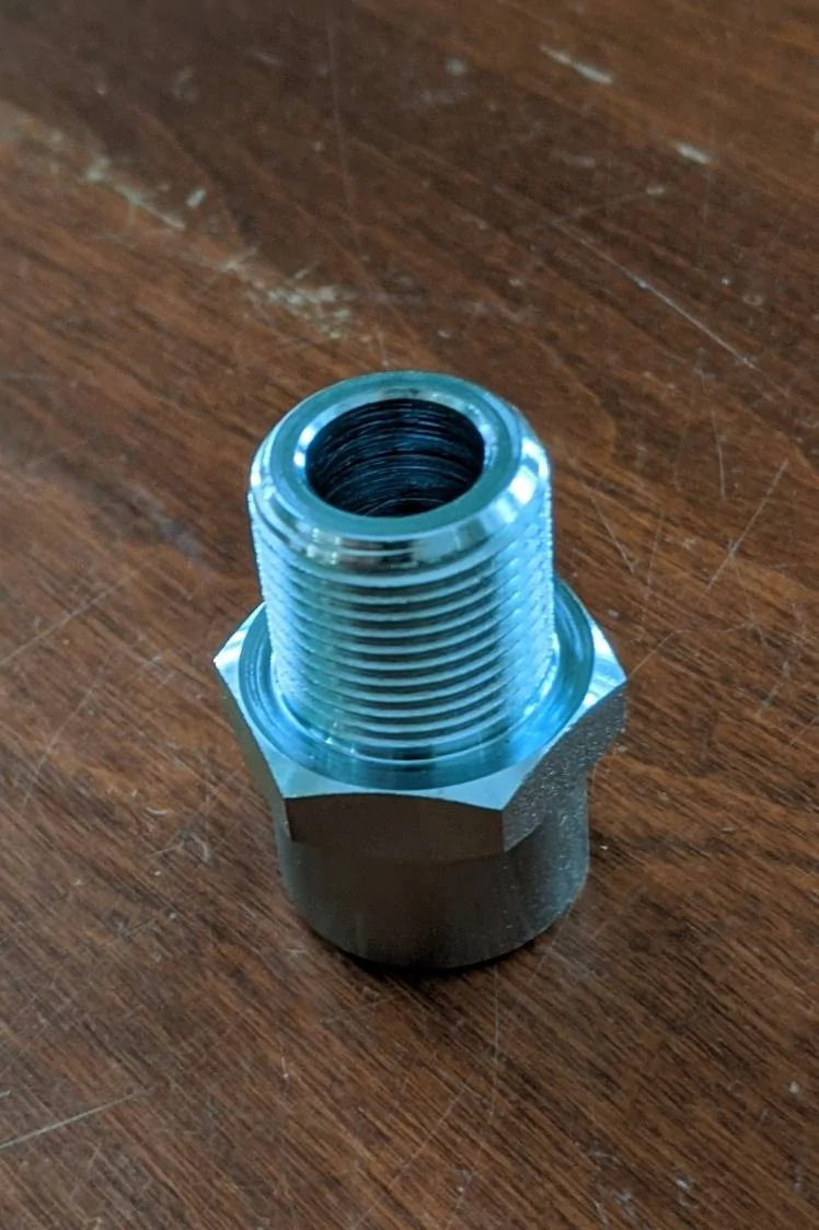

Jim,
Do you know if that Mishimoto filter adapter will also fit on the GT? That sound like a great solution to get accurate oil temps. Has anyone ever put one on a GT? The adapter is about the only inexpensive way I see to get a real sensor to record oil temps given the stock oil pan is composite and does not have a bung for a sensor.
JJSSI
Dec 10, 2019
159
78
St Simons Island, Georgia
Jim
2020 EcoBoost HPP w/Handling Package, 2004 Boxster S, 2013 Jeep JK,
Chuck,
I don't have first hand knowledge that it fits but I think it would. You could email them and see what they say.
You need a 26mm deep socket for the install.

Chuck,
Jim
Yeah, looks like a simple install. Have deep sockets.

I thought about mounting on the pillar but the wiring was easier where I mounted it. I installed it mainly to make sure the temps were in the normal range before I would run it hard. Will not need to be checking it all the time so that location is fine for me and I will rely on coolant temp as my primary.

Jim,
I looked on their site and they say it is universal and will not have a complete list of vehicles.
However, if the thread pitch is the same than it should work as long as there is room to hang down further.
I think the Mustang GT filter is 3/4" so should work on the GT as well.
Just out of curiosity, what do you use the 26mm deep socket for. On their site they list allen's but that is all they list.
Just trying to get a good mental picture of the install procedure.
