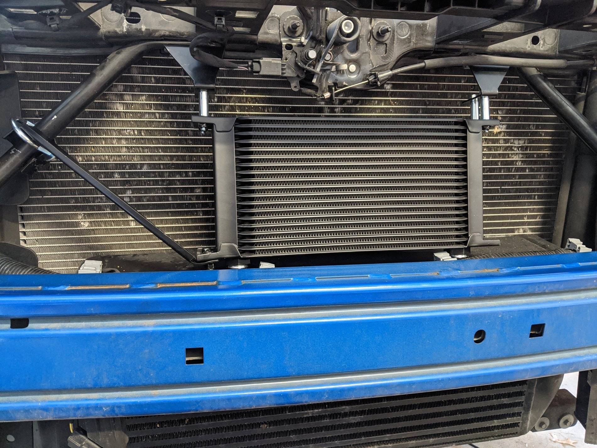

I can answer this. The answer is, no. I added the Mishimoto oil cooler to my Ecoboost. Absolutely no impact on the oil temp at HPDE events. Now, I'm certain that the actual oil temp has to be at least a little cooler. But the ECU has no way of accounting for the increased thermal capacity, so it just keeps calculating oil temp the same as it always has.

The Mishimoto kit comes with the Mishimoto sandwich plate, with the NPT fitting for the sensor. But as you note, installing a sensor and a real temp gauge will not impact how the ECU reacts. In reality, it will probably only frustrate me more if it confirms my suspicion that the actual oil temp is 30-40 deg cooler than what the ECU thinks. I have read that the GT350 uses an inferred temp as well, but it also has an oil cooler from the factory. So it's calculations are based on the thermal capacity of that system. But if you modified it, it also would not know it. It seems really dumb for Ford to skimp on installing a oil temp sensor in all these cars.
