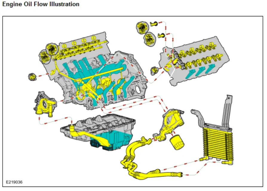

An internal leak could be the issue. But relative to a restriction increasing or decreasing pressure, that is dependent on whether the restriction is before or after the pump...or before or after the point at which you are taking readings.
That what I was thinking. I know there's no restriction before the pump but I wonder if it's in between the pump and oil filter housing where the sensor is.

Not yet. I confirmed oil pressure is in fact low so it isn't an electrical issue. I pulled the pan and the pick up, seal and oil squirters look good but at that point Benny told me to talk to ford warranty before i tear anything else apart. I had three kids graduating this may so I had to put it on hold while I got through a preschool, High school and college graduation plus all the celebrations. Lol. I spoke to ford this week and basically I'm on my own. This weekend I need to get the ac working in my clapped out civic. It's hot out here and I never thought I'd still be driving that thing! After I get it going I'll get back into the mustang.
Right now I'm getting 8-10 psi at idle (spec is 10-15) and I should get 30-40 at 2k but mine isn't climbing to 30 until 3k rpms. It also only shoots up to 55psi at start up and I know before it would shoot up to 90ish for a second.
I'm thinking it has to be a blockage before the sensor or a bad seal down stream. Correct me if I'm thinking about this wrong but if the blockage was past the sensor then I'd still have good pressure up to the sensor right?
Not sure on OP, but for you -- the gen 3 cars have a bypass that reduces oil pressure in low load situations.
You should make sure your bypass is not staying open -- that would cause exactly what you are describing.

Something like this could cause similar problem
When I tore down my gen 2 for OPG and phasers I found what appeared to be part of a safety seal foil that comes on new bottles of oil. It was just resting on the chain tensioner.
I could absolutely see that piece making it to the PU tube and causing a restriction.

I tried swapping the bypass solenoid with the one from my old engine to verify the new one wasn't defective but nothing changed. Other than that I haven't found any troubleshooting procedures for the bypass related to the oil pressure code I have.

If you replaced the oil sensor and still have the same psi issue, it’s most likely not the sensor. Also most sensors on a Ford and other vehicles can be tested with a multimeter by probing the contacts. If the specs come in higher or lower to the Ford operating spec for that sensor then it’s bad. Usually if the result is within 1-5 points of the Ford spec it’s still good. Always test a sensor first before throwing parts at any vehicle…. Same is true with O2 sensors, MAF sensors, etc. All sensors have a certain operating spec and any can be probed snd tested at the connector on the sensor before pulling it or wasting money….
