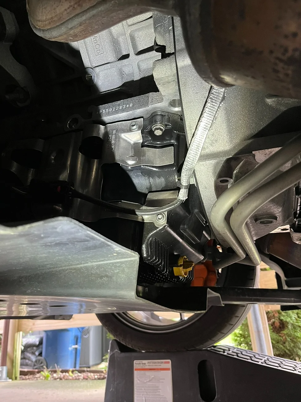

Just wanted to give everyone a heads-up on something I found with my Mach 1 that might be worth keeping an eye on.
I took my M1 in for a noise issue during deceleration and initial acceleration. The dealer diagnosed it as a lack of grease on the driveshaft — same issue another member mentioned previously.
Before bringing it in, I decided to inspect things myself and noticed the area around the drain plug was wet. On closer inspection, I found oil around the top edge of the pan on the side. Dealer says the issue is the pan gasket and it’ll need to be replaced and they can’t get to it until October.
Not thrilled about having to wait that long or the fact that they’ll need to disassemble part of the front of the car to get it done.
Might just be my car, but it could be something worth checking on yours as well.

I am using the OE plug, initially I thought that might be what it was, but oil is on the side of the pan and above the plug. Since the oil level hasn’t changed since I first noticed it and the dealer didn’t clean it, I’m going to pull the belly pan, clean it and see if it comes back.

I actually pulled the belly pan, cleaned everything, and changed the filter since the dealer didn't do any of that. Today or tomorrow I'll reinspect as the oil started at the front corner near the filter.
