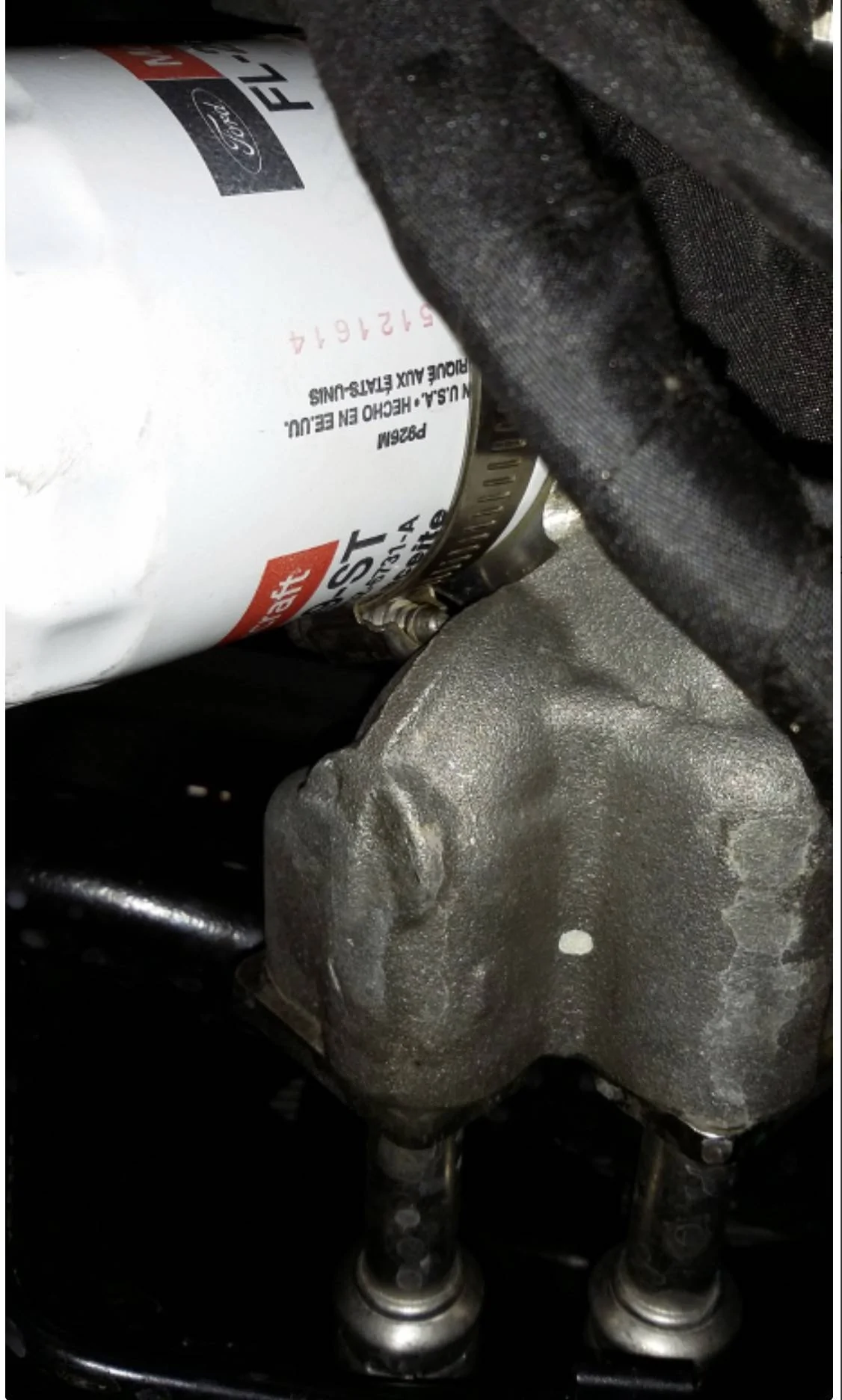

Lessons for all for the umpteenth time:
1). DO NOT LET ANYONE ELSE TORQUE YOUR SPIN ON FILTER UNLESS YOU WITNESS THE TORQUING YOURSELF
2). USE A BAND CLAMP ON YOUR SPIN ON FILTER
And position that band clamp like Tank did so the band can't spin.
Yes, position the clamp like in the pic but it’s not my pic!
I’ll give credit in the post :like:
(Photo courtesy of @Zombo who lifted it from somewhere else:clap:)
Agreed. Last time the dealer changed my oil (not by request) I specifically asked if the tech torqued the filter and was told yes.
I checked it when I got home and it took 2 full turns to 18 pounds
