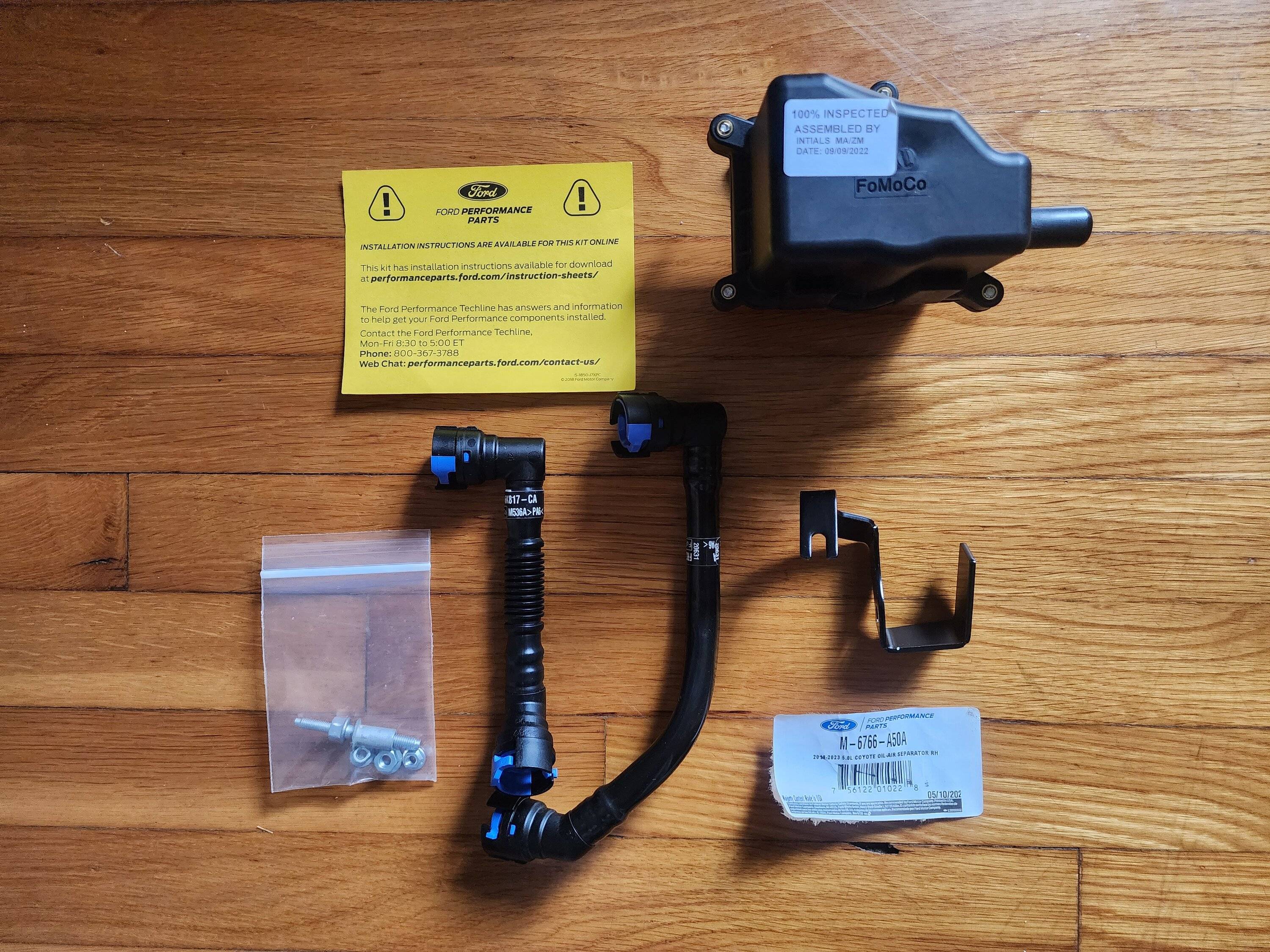

Obviously you never tracked your car and have no clue why a separator AND better valves covers are needed on BOTH sides when pushing the carResearch leads to this:
DI injected : Yes
Turbo : Yes
Mustang GT is Port and DI: No need.
Unless Beat it to hell?: maybe
Daily with mild track : No
Still on warranty: No
Gonna leave this here:
“The PCV system includes an oil separator, designed to catch oil before it it drawn into the engine, and return it to the sump.
When these systems work properly, there’s no need for a catch can.
(Fitting a catch can is like taking Panadol for a brain tumour. It’s ineffective, but might make you feel better.)”
“All modifications come with what engineers call ‘feedback effects’ - inevitable changes to the system’s response flowing from some modification to the system.
(For example, upgrading to stiffer springs and stickier, low-profile tyres improves grip - the primary benefit. The feedback effects might include reducing the margin between grip and slip - meaning a sudden transition from grip to sliding, with less warning. Especially in the wet.)”
“For this reason, curing ‘maybe/nonexistent’ problems is a bad idea. Curing the nonexistent problem of oil blow-by with a catch can, which pressures up the system and blows a seal, allowing sump oil to escape could have the nasty feedback effect of catastrophic engine failure, and you will not be covered by warranty. In fact, engine modifications generally (and modifications to related systems) are a great way to give the manufacturer justification to deny a warranty or consumer law claim in the event of a major engine failure.”
Separators do not pressurize the system…. Where do you got this idea from ????
Denial of warranty due to using separators is 100% bs….
Do you have any facts or examples ?????
