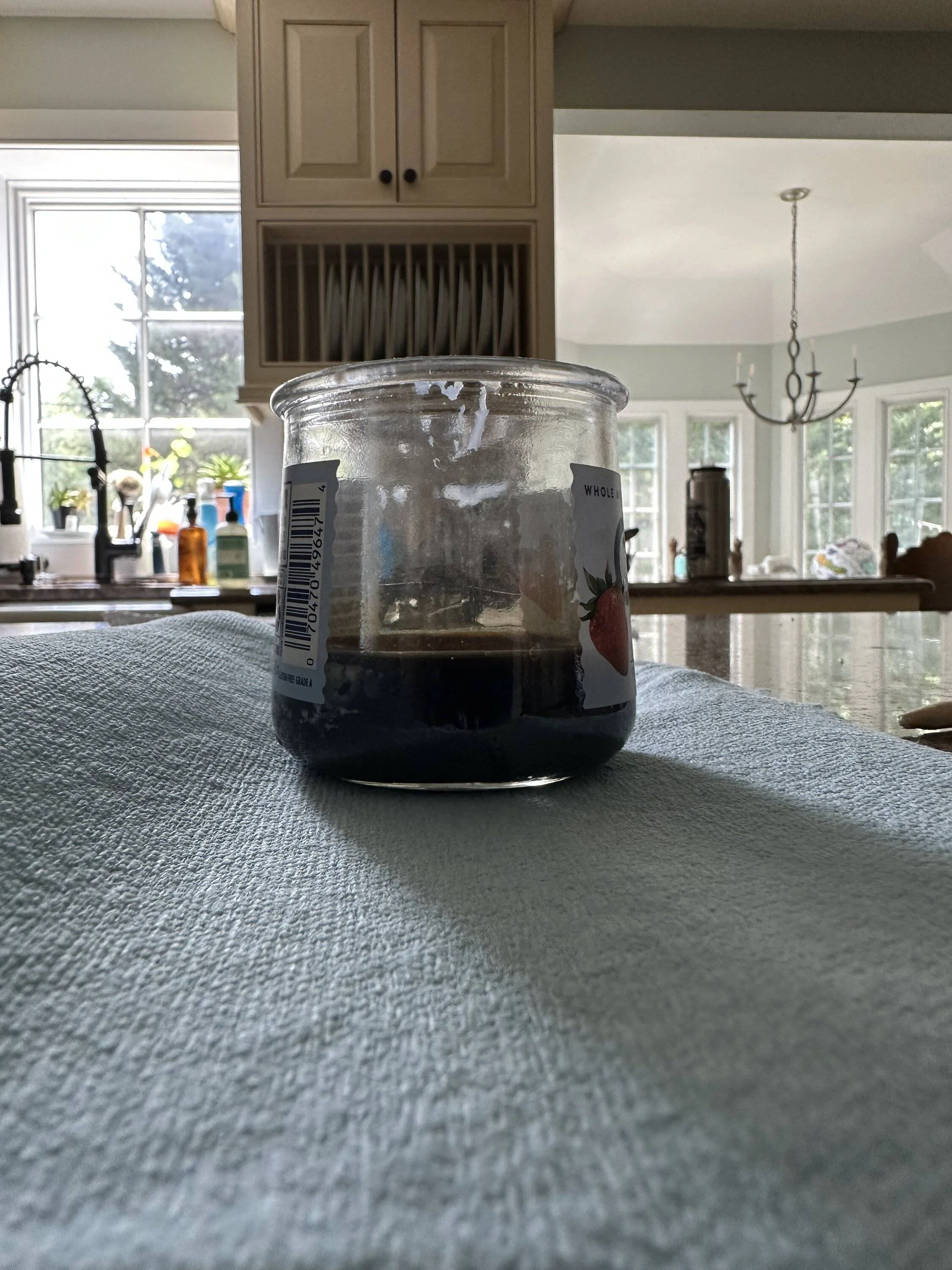

Do you really need an oil catch can on your DD? Yes. Yes you do. Here’s mine after 10k mi. It’s my daily with spirited driving no track time during these two oil changes.

Is that after one or both oil changes?
That's a lot of oil.

That's the total after 10k mi. (2x oil changes at 5k mi.). I forgot to check it after the first oil change. It might be more than expected because I added a bottle of Ceratec during the first oil change.

On a port injected engine that amount of oil would be nothing. That would pass through the engine without harming anything. 10,000 miles is like driving from New York to Los Angeles 3 1/2 times, so it's a very small amount.
However if it's direct injected only, any amount of oil sticking to the back of the intake valve is bad. A catch can is way easier to maintain than having to pull the intake off and cleaning the back side of the valves.

I check and empty my catch can every 4000 miles, collects about 2 oz's.

The container has 5 oz on the label (which would be filled near the top). Given this is over 10k mi interval, the blow-by seems to be less than yours @rcald and within range of "normal"
