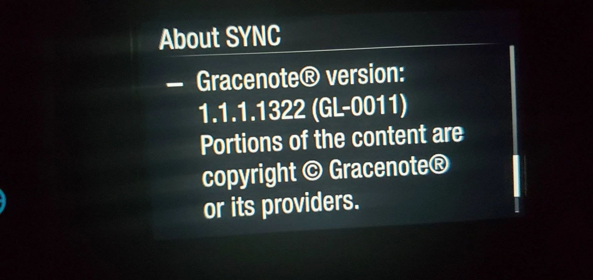

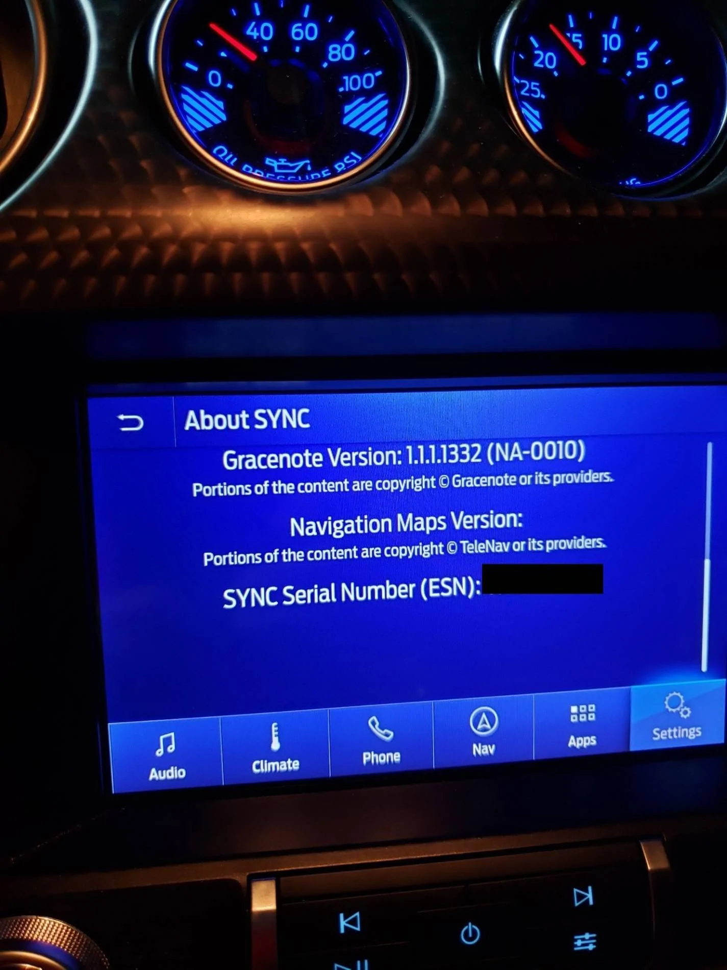

GL-0011 for gracenote?.. Haven't seen that b4. You in the US? Can you post your IVSU screen?!
I'm not sure what an IVSU screen is.

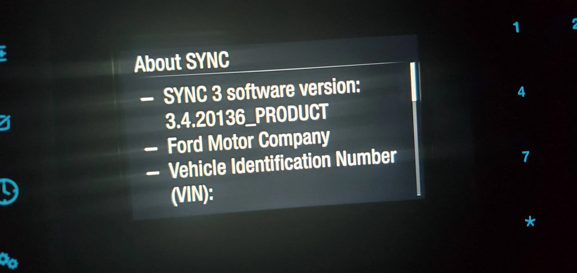

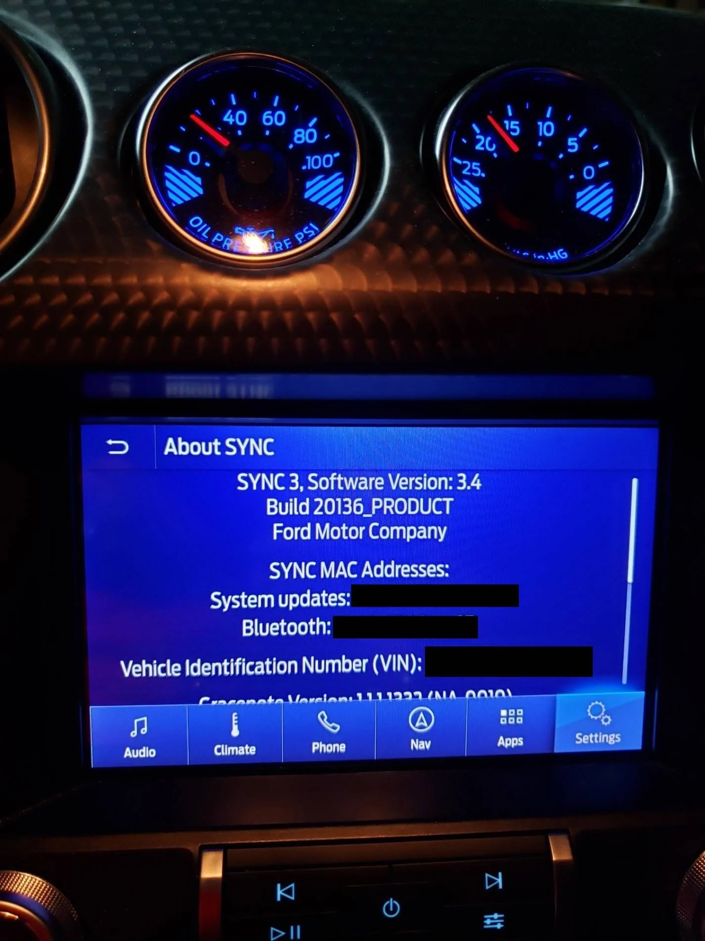

Ok. Downgraded with Cyan to 3.3. Factory upgrade to 3.4 with today's update a success (other than infinite reboots so I PULLED OUT after the third reboot :facepalm:) Now just need to re-install nav, but I don't really care since I use Android Auto when I want Nav.

Press hold FF and CD Eject buttons -> End Test -> APIM Diagnostic -> IVSU version
I'm not sure that the Base Radio has a CD Eject button.

Just curious why you didn't just upgrade to 20136 from CL Sync Downloader?
Breee
Jan 13, 2020
2019 Mustang GT PP1 A10
:like:
I've been on that version for a few weeks, but I wanted my car to be "official" with the XML upload to Ford that you send post-upgrade so they know I'm updated. I dunno... I have OCD :crazy:
