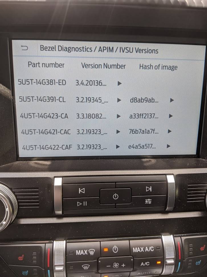

@el-guapin do my files/versions indicate 3.4 sync and 1.19 maps?
