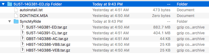

Just came back after a 40 minute drive. The system recognized the stick then nothing. No reboots, nothing. Still on 3.3 19052.
Came someone please check their stick and see if I have the correct files?
Never mind. I must still have the map update on my mind. I opened the zip file directly onto the stick. I'll try again tomorrow.
