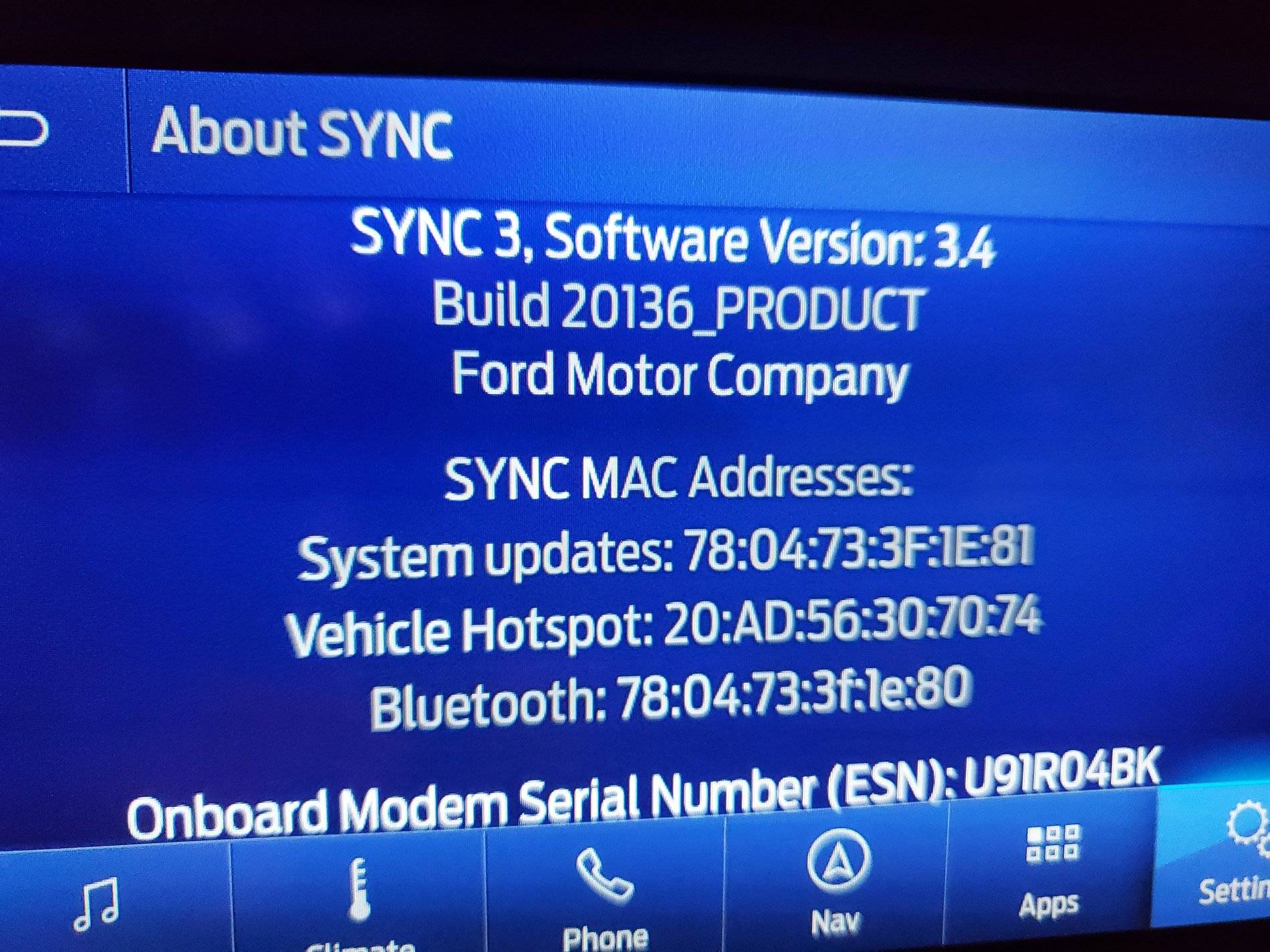

This morning my visitors flew home, so went into the garage to rectify my "no navigation voice command" issue. I used the download the software person sent me to erase the maps....it actually deletes your navigation from the system. After using the tool and confirming that the screen now said Navigation failed; I installed the Sync 3.4 update. It took about 15 minutes (I stood in the garage and had a beer so I could catch it before it began looping). After it said update complete, I got out of the car and locked doors for about 5 minutes. On startup, it showed I have Sync 3.4. I have the new USB with the updated map files they resent me, so I will upload them tomorrow or the next day. Instead of driving around for almost 2 hours, I'll probably put in on the charger this time. If the maps install and show correct version, I will consider this saga completed.
