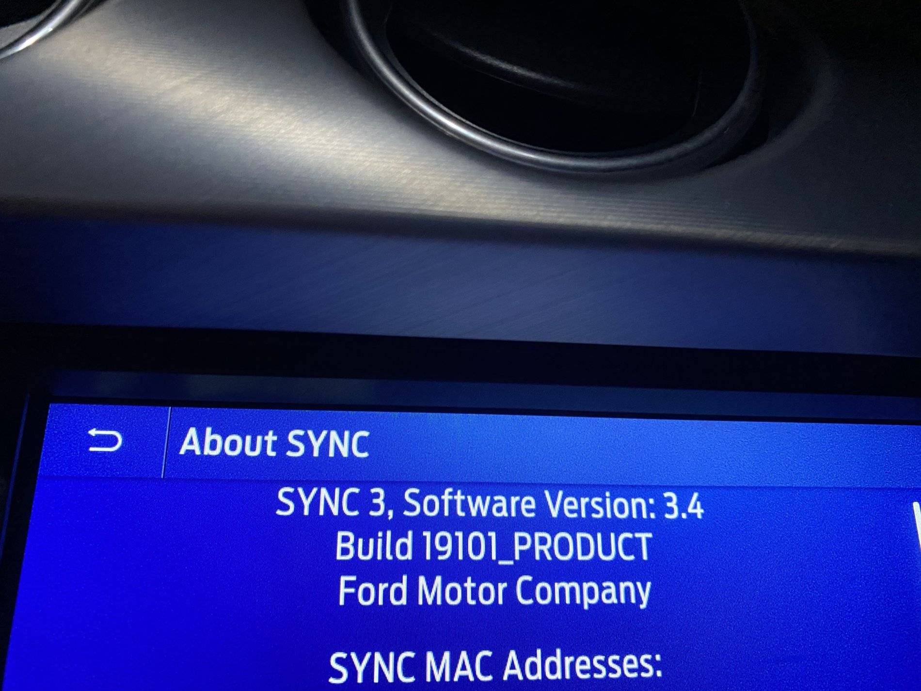

    I just installled it I am on 3.4 !!!!!!!! 2018 GT 7E786C61-0893-4EDD-BC4B-E539E9C2EFA8.jpeg

    Count me in as a 3.4 user! I had already swapped a MY16 sync3 screen and apim previously to get CarPlay working. I used the instructions listed to take mine from 3.0 to 3.4, which is something that ford would never allow. Everything works as it should with my nav maps updated and 3.4 feels a lot more responsive. I did not do any apim firmware update.

    Updated tonight 3.0 - 3.4 using that guide. Only did the 19101 build. Might up to 19274-but not sure what gets updated.
    I mainly did it so I can get Google Maps directions in android auto onto the dash.

    from my reading 19274 is mainly bug fixes. I went ahead and went to it immediately after 19101 so I don’t know specifics. I do know the bootloader is blacklisted on 19274 so you won’t be able to backdoor in and flash packages anymore like usb 1 in the instructions accomplishes.
