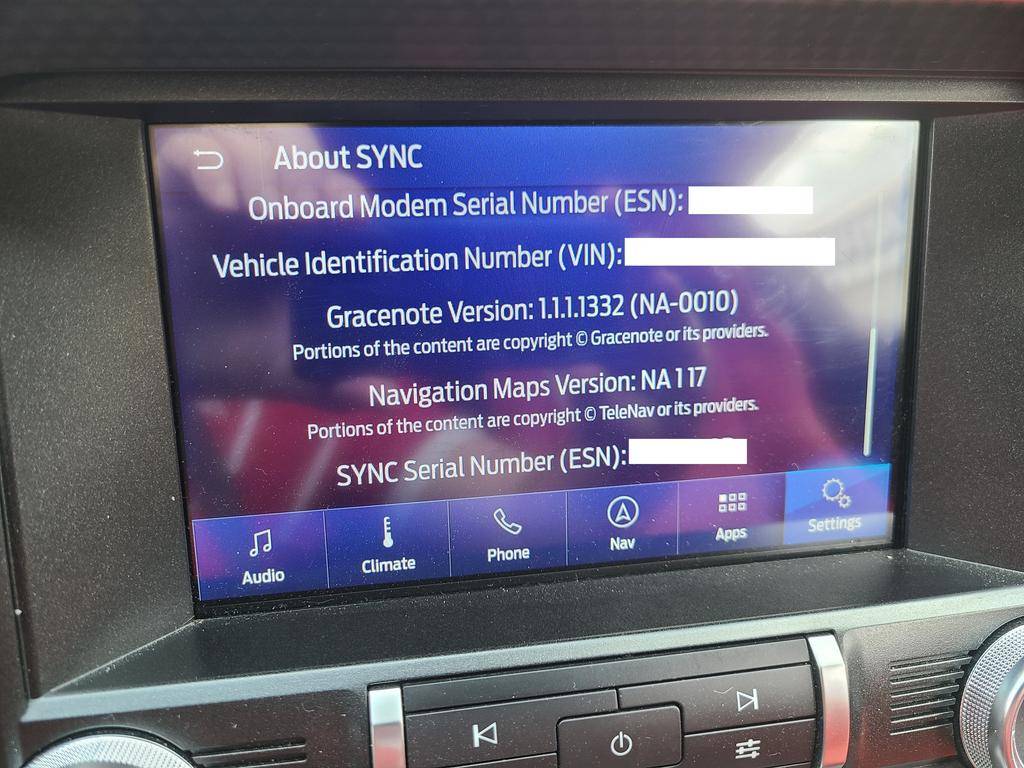

This was probably the most flawless update for me, I have my trusty 16gb exfat USB stick, booted up car, and placed usb stick in and took about 15 minutes and also went back to the site to confirm my upload from 3.3 to 3.4
But the next part was better than expected. I went to download my complimentary map update, my 2019 had 117 so I got a complimentary 119. I put it all on the same stick of course deleted and reformatted, along with license file etc.
I placed USB stick in and started car and I had to go to work, so my drive was only 20 minutes though, when stick was in it warned do not turn car off or pull out stick. I could not wait so I left the stick in and turned car off. and locked doors and went to work (I could see the usb flashing still....)
I returned to car at end of shift, started car and could see already see it now at 119 maps version and the updating notification popped back up and stick continued to be reading/writing. When I got home and parked, message popped up saying 1st part of installation finished and will be rebooting for next part and keep stick in port. I decided to be patient and waited around 15-20 minutes in my driveway, and then it now said update complete and remove usb.
No issues so far so on my side, I did not need to keep car on the entire time for map update? It was able to continue as long as you did not remove the usb stick and waited for final message saying that installation was complete and now instructed to remove usb, might be misleading to some since it quickly at beginning of update did change the map version in the settings menu, might give false sense that it was updated already, but the install seemed to need to do more install phases still.

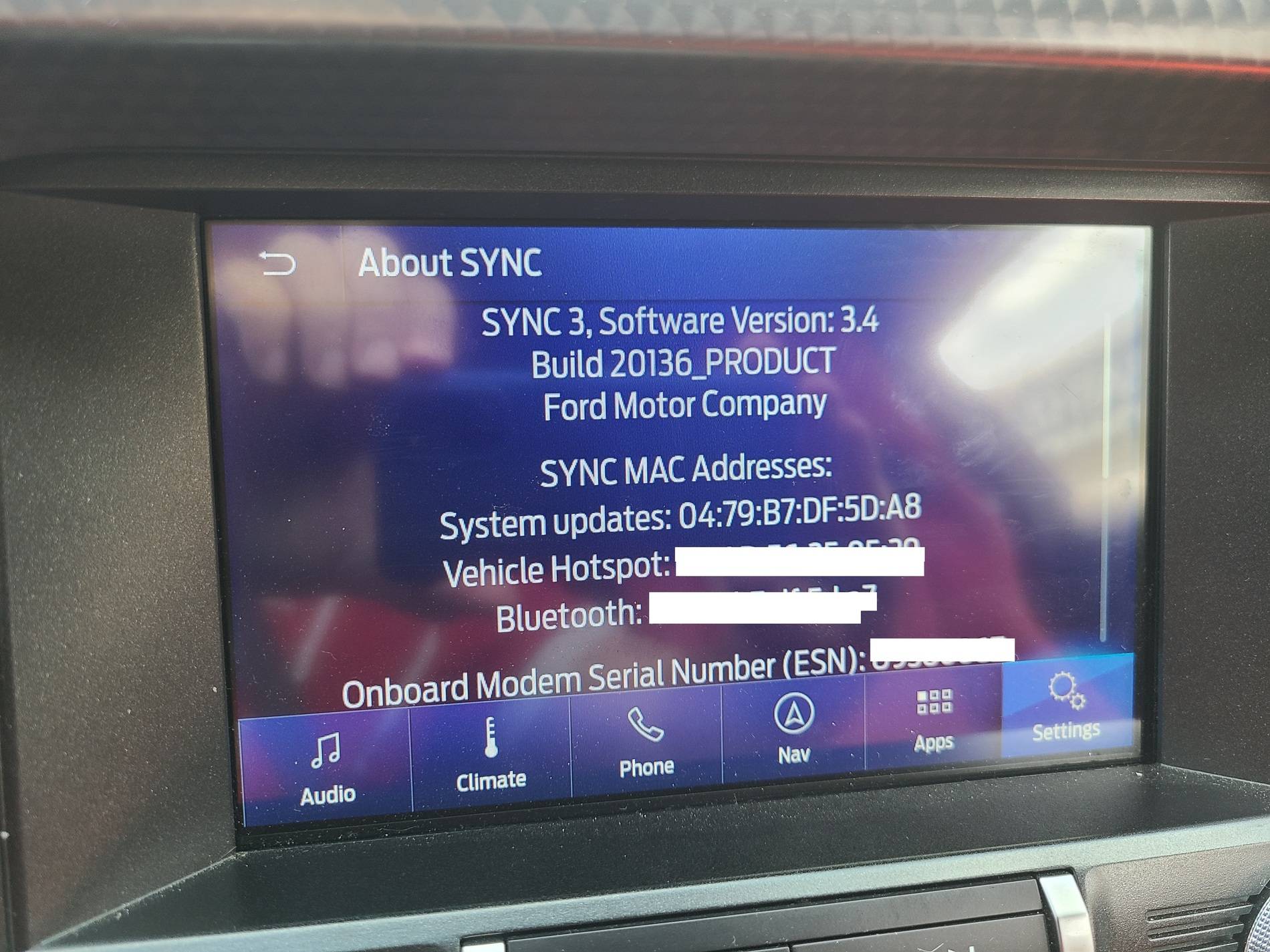

I updated my car today to 3.4. Zero issues downloading it and updating the car. Let it do it's thing while going for a cruise around the neighborhood. Took about 20 minutes.
