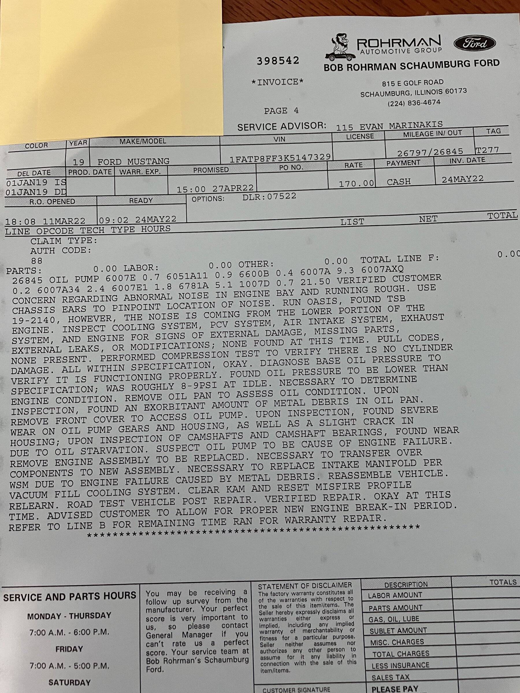

I just had my 2019 GT engine replaced (covered under warranty) because the OPG failed. My only mods were exhaust. I’ll add a supercharger in a couple of months and will definitely replace the OPG and CCS.

I’ve got an a10. I don’t know exactly when it failed. We discovered the problem when I brought it to the shop to install a supercharger. While investigating the car, the mechanic noticed some clicking from the engine. Further investigation led to the discovery of metal shavings in the oil. The mechanic recommended that I immediately take the car to the dealership. I did. The dealership investigated the car and determined that the oil pump housing had a ā€œslight crackā€ and there was an ā€œexorbitant amount of metal debris in [the] oil panā€. The dealership replaced the engine under warranty.
I love a story with a happy ending! 😊
FYI - I have posted a similar note on another forum — mainly because I was excited to get my car back and also because I thought that people would be interested to hear that this can happen even if you don’t mod your car and that the dealership voluntarily replaced the engine. I did not have to beg, threaten, or cajole them.
Here’s a picture of the most interesting part of the invoice.
I just realized that this post doesn’t directly relate to the OP’s question because, strictly speaking, my OPGs did not fail...
