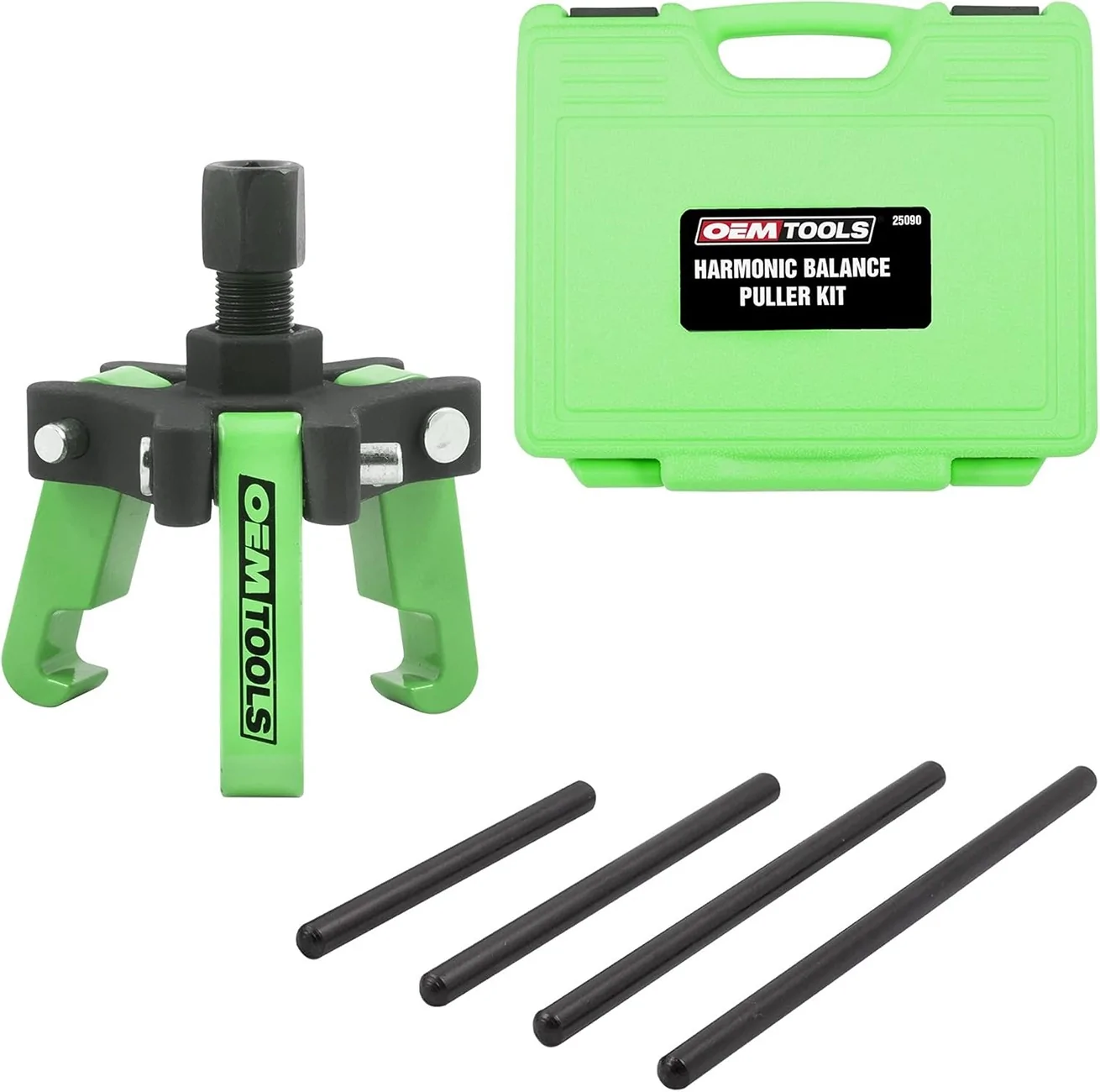

I have this and it pulls stock balancers with ease.

That is definitely the style you need with the rods that foxcoupe has in the photo.
I have this one too, works fine. Get yourself a large rubber band to go around the backside of the jaws so that you aren't trying to hold each one in place, while the adjacent one folds down

OEM Tools ordered.
