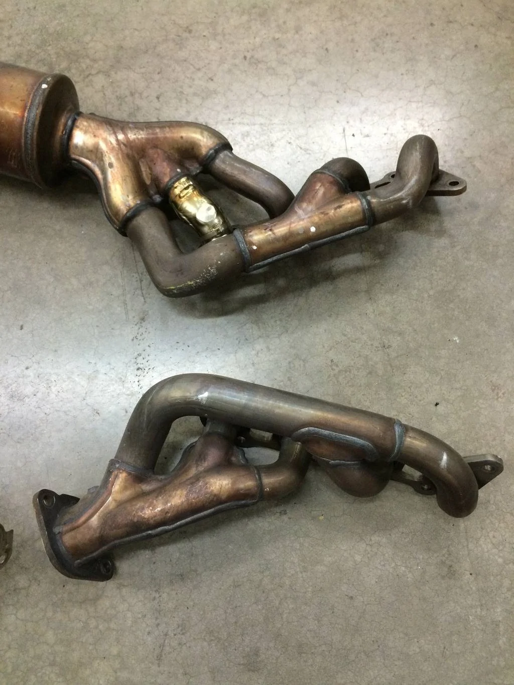

I found this picture online which claims to be the stock 5.0 GT headers. I can see how LTH would flow better but the questions is do these flow good enough. My car has no problem hitting the redline with the stock manifolds so I think they're good enough for my driving style. That plus I've watched a couple video's about installing headers and that looks like a job I'd leave for someone else's car.
To put this another way, ROUSH supercharges the 5.0 on OEM headers and they warranty the car meeting 50 state EPA requirements.

Save your money. the days of banging, cursing, bleeding to get a set in and gaining 35-50 hp are long over.
15hp at power peak maybe. If you can find a set that is tuned to pull the exhaust gasses out of the cyl. (scavenging).
Engine bays tend to be too tight to fix headers that will do this well.
Some like the "ting" sound they have.
It isn't like it used to be where the oem's left a bunch of power on the table, choking the engine with log exhaust manifolds.

I’ve read some things about A/C lines and cutting studs and all kinds of headaches. I’m a machinist so I it’s not like I couldn’t make anything work but is it really worth it? In line with my original question, if the OE headers do the job with forced air how deficient can I possibly be with bolt ons.

Tech specs lists GT,GT350, and GT500 with a very general “tubular stainless steel headers”. Been trying to find the actual dimensions. I’ve read that they may be routed differently to avoid other components, but are the primary sizes different?
I’m no mechanic but I’m not really buying the school of thought that “you gotta get headers”. If the factory headers are equal or at least close between the GT, 350, or 500 I can’t see spending the money on aftermarket headers on my coyote when they can handle the flow of the voodoo or predator engine.

Headers made a tremendous difference back in the day when cars used to be equipped with a log-type exhaust manifold, usually heavy cast iron. The two things you got was big weight savings and much improved performance in the upper rpm range. Even modern manifolds can be improved up to some extent, but they are much better optimized than they used to be.
