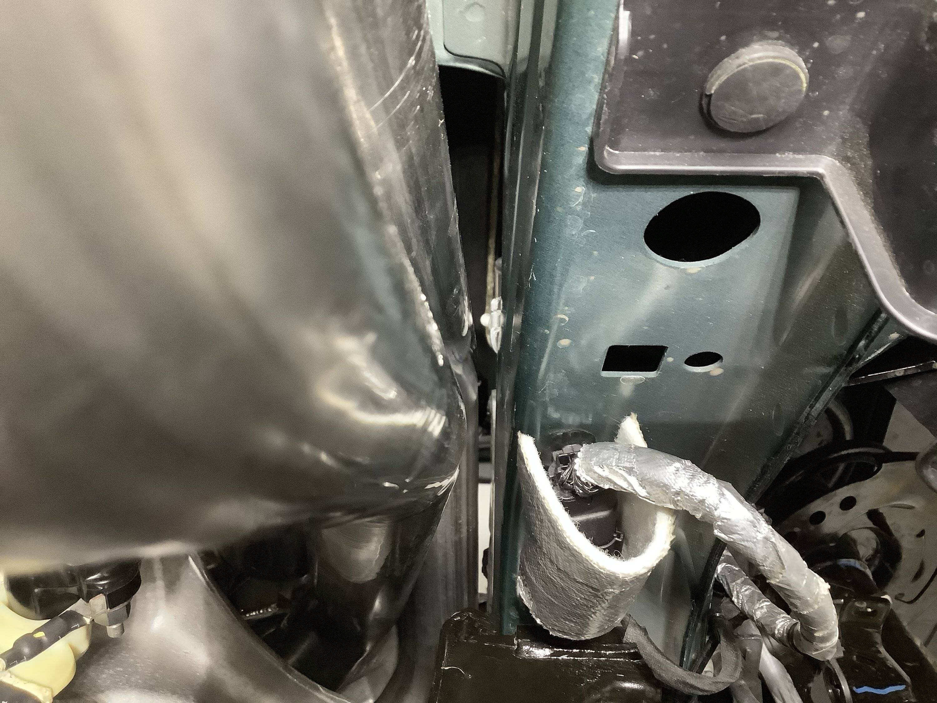

they said that the passenger side header is hitting the chassis.
is there something needed to be done to adjust and fit it?

I just installed a set of Stainless Power 1-7/8 headers on my MACH1. (on jackstands no less) and didn't have any issues with fitment. The tab holding the AC line does need to be unbolted and rotated upwards, and I went a bit further and used a metal ziptie to pull the AC line towards the fender a bit to keep it from tapping the header. Then, loosen the motor mount nuts (the top ones, not the mount to frame bolts) and use a long prybar to press between the aluminum motor mount and the body of the car to shift the motor over to the drivers side as much as possible.
The shop should have already had these nuts off the mounts, and the motor jacked up

Did you by chance purchase the ones with 2” primaries? If so, that could be the problem.
one solution would be to dimple the primary that’s making contact with the chassis in a vice. Heat the primary up until it’s red hot and then tighten the vice to make it look clean and professionally done.

Oh okay. The same method of gaining clearance can be used on 1 7/8 too.
FYI, I read a thread where a shop beat and kinked a set of headers to see if it hindered performance. The test revealed that beating and smashing the header primaries did not result in a loss of power.

Yes! Getting ample clearance will save you from lots of aggravation such as, chasing false knock, rubbing a hole in the header primary etc. This is how I would approach it if I were in your shoes.
Another thought is to ask your mechanic if lowering the engine via Steeda or BMR adjustable motor mounts will give you the clearance needed without having to massage the header primary tube.

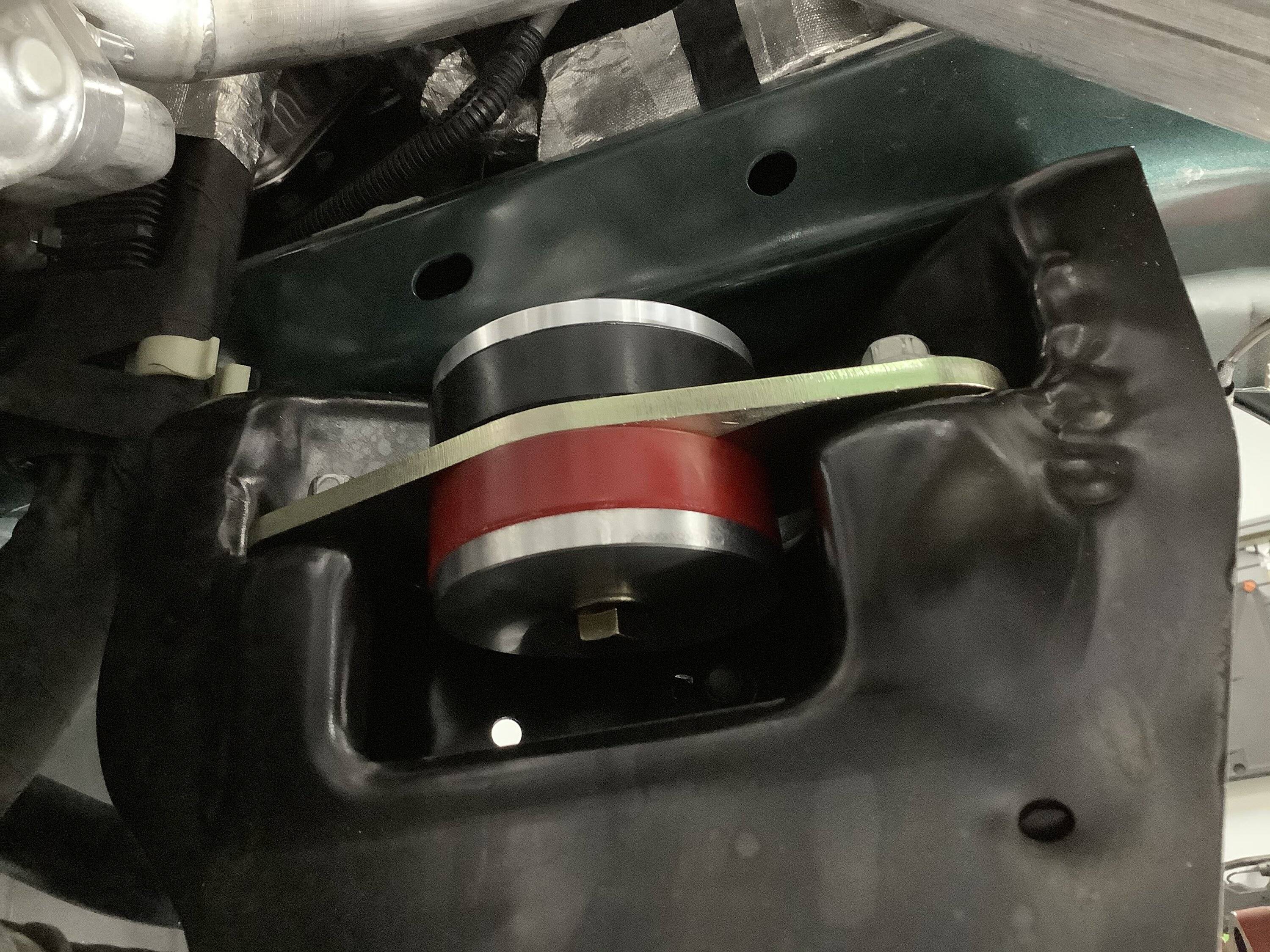

good to know. thanks for this!
I used the Steeda adj. motor mounts on mine with my headers to lower the engine 1/4”. Different brand of headers, but I have plenty of clearance on the passenger side between the primary tube and frame.
In5am0us
In5am0us
Jul 28, 2022
58
New Jersey
Dylan
2020 Mustang GT Premium
I’ll show my shop guy these pics for sure
