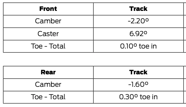

Don't mean to hijack OP's thread. I'm getting an alignment tomorrow on mine.
Main goal beyond handling and grip (which the PP2 has plenty of) would be reasonable tire wear. I do a fair bit of mountain carving and as delivered the tires have been wearing more on the outside. The car doesn't have enough camber stock.
On previous relatively heavy front engine rear drive cars (with macpherson struts) I'd go -3, 0 toe front and -2 slight toe in rear. Worked well. I realize alignments aren't one size fit all but I was also looking at the '19 GT350R "track" settings (attached) and noticed it calls for a little toe in up front. Wasn't sure whether to go with that or not on the S550 platform.

I can't speak to the toe in. But I am basically running that alignment now. Spring rates similar to GT350R (BMR handling springs, Ford Performance dampers). I'm not running quite as much toe as they are calling for, but it feels great..
-2.2 front camber, 0.00 toe
Caster 6.9
-1.7 rear camber 0.20 toe.
Works extremely well for back roads at higher commitment levels.

I guess between 0 toe and half a degree in per side I'd be really splitting hairs either way.
How's your tire wear?
