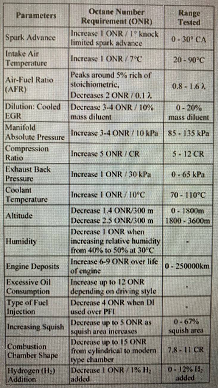

That chart is kinda worthless without the caption.
What does it mean?

1 ONR is one octane number. Top row is spark advance at knock, so 1 octane number is worth 1 deg timing advance when knock limited. This was found to be true between 0 and 30 deg timing. It’s a really useful chart and I’ve found it aligns well with the oem cal.

I understand that. BUT what is the control octane number ?
