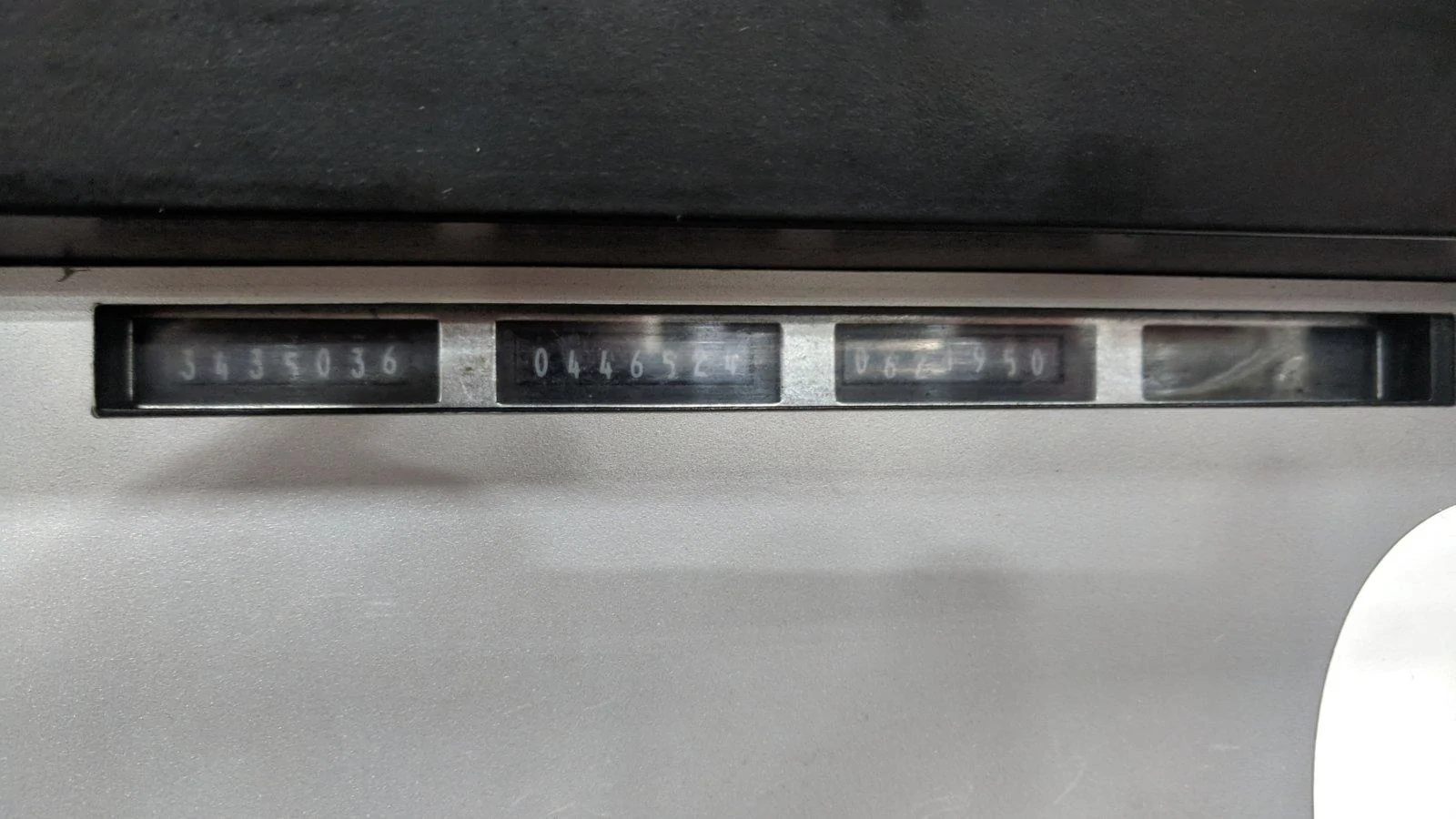

Another tip is most pumps have gallon counters. You can usually tell if the station sells a lot of premium or not by that. Here's an example. This pump had regular, premium, and diesel. Premium was in the middle, regular on the left, a 6 or 7:1 ratio is actually pretty good and this station is top tier and I usually get very good results.
