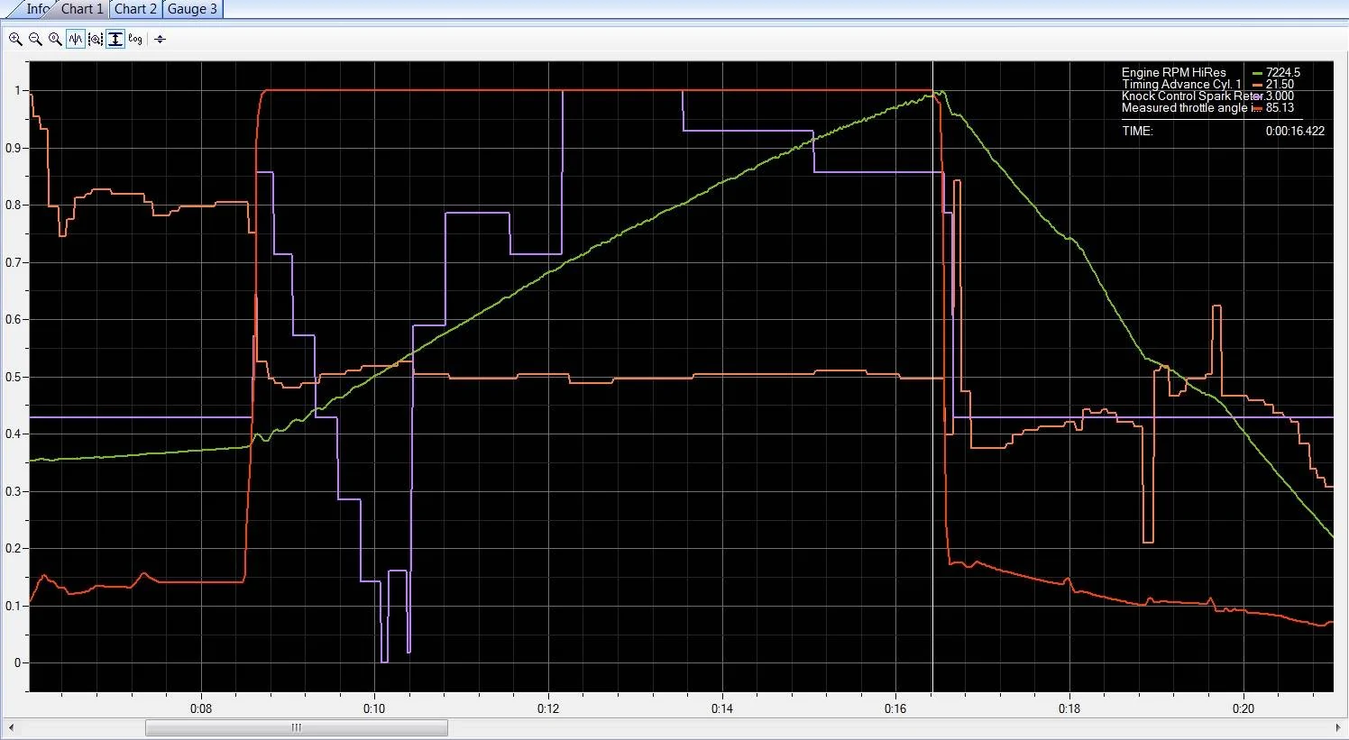

What do you load tunes with? Post a log

That's... going to be hard to read LOL

Lol need a magnifier for that legend
The ECU pulls based on severity. Stepping from small correction to larger happens. Takes more removed to stop the detonation than if you never detonated at all. The adding back in portion is very mild in stock settings and often doesn't get back to normal by redline. Ruins a whole gear
The false knock events I've seen (based on running e85 and stock timing) is usually a small reduction or blip on the line or a massive one that maxes the reduction allowed. You can feel the last one pretty easily. Either way extra octane will confirm. Costco gas cost me 3 degrees during wot and 4 in certain part throttle spots. Quick Trip and its perfect.
