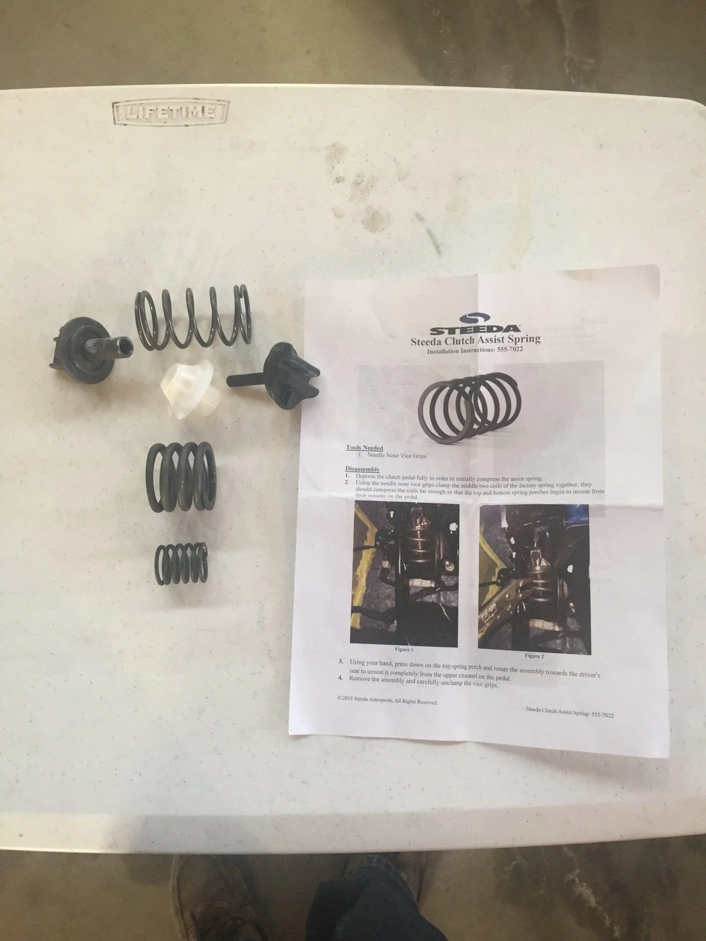

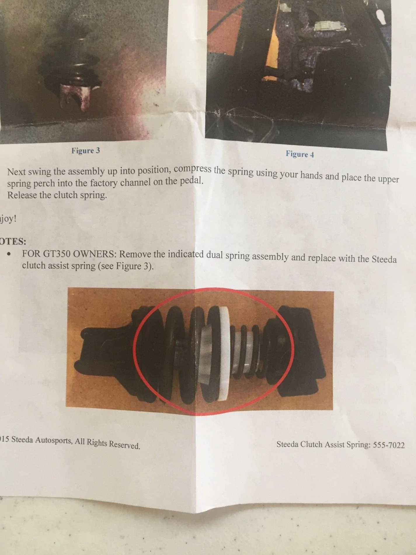

I got the new one installed yesterday but won't be able to test it out until the snow and cold end.
The removal was just as I've whined about, came out with a twist and shout. I have no idea how I'd reinstall the original without creating some kind of special tool. The GT350 large spring gives you very little to "visegrip".

I'd like who ever says it's a 5 minute simple install to come over, crawl into my drivers side floorboard and prove it. I bailed on it until I finish losing weight, fresh out of a Yoga class and feel like figuring out how this is so simple
YMMV
I have change mine so many times from being indecisive that I can literally do the swap in less then two minutes. The first time I ever did it though it took me much longer. At least 10-15 minutes to figure it all out.
I have had my car now for about 9 months and I'm still undecided what I like best. Stock or steeda or no spring. I think no spring is my favorite but unfortunately rolling like that I have like a half inch of play in the top of the pedal if you just touch it with your finger. So ultimately I don't know if that's harming anything so I keep going back and fourth from steeda to stock.
Honestly like stock just fine and I like the ease of clutching. The only reason I disliked it and changed it was 1-2 shifts are horrible.
If I can put it in for awhile without touching it I'm sure I could master that one to two shift after awhile and may go this route.
I also would like to try that one dudes idea with the toyota 60# spring - see how that is.
