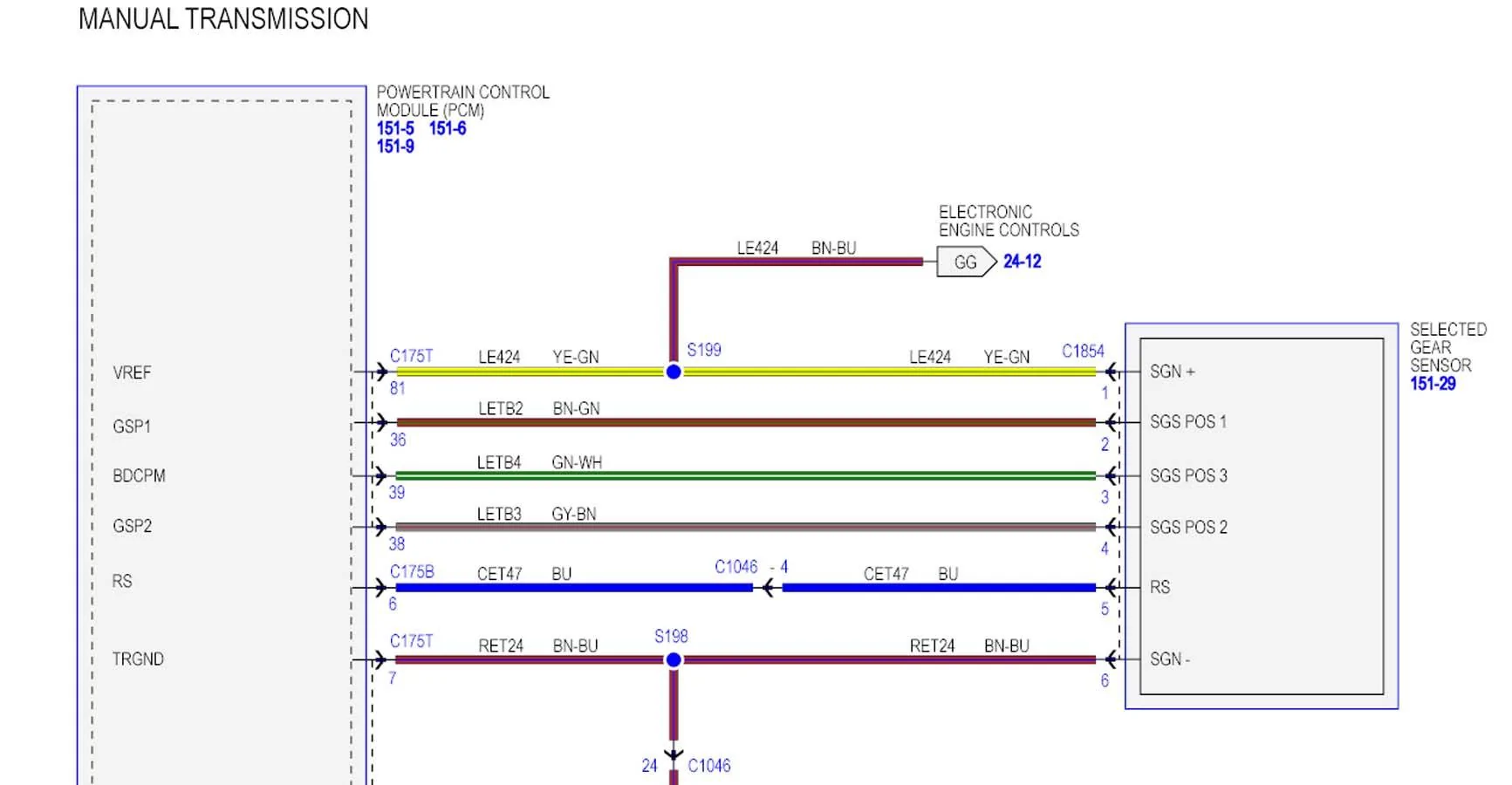

The 2019 service manual shows a gear selector component with a 6 pin connector in the electrical section. It appears to be located on top of the transmission, I hope to get a photo of it next time I am under my car.

Here is what the 2019 service manual shows: so we have the usual power and ground, three gear sensor wires, and the mysterious RS.

3 bits express 0-7 gears. which value is 'reverse' I don't know. RS could be reverse too.
VRef = Reference Voltage (5 or 12)
Gear Sensor Position 1 = input shaft speed
Gear Sensor Position 2 = output shaft speed
RS = Reverse Sensor
TRGND = Ground
BDCPM could be a neutral sensor. The only acronym I can find is Brushless DC Permanent Magnet. Knowing the gear selector is between gates would prevent the computer from displaying anything except N.
There's also that C1046 connector in both RS and Gnd.
