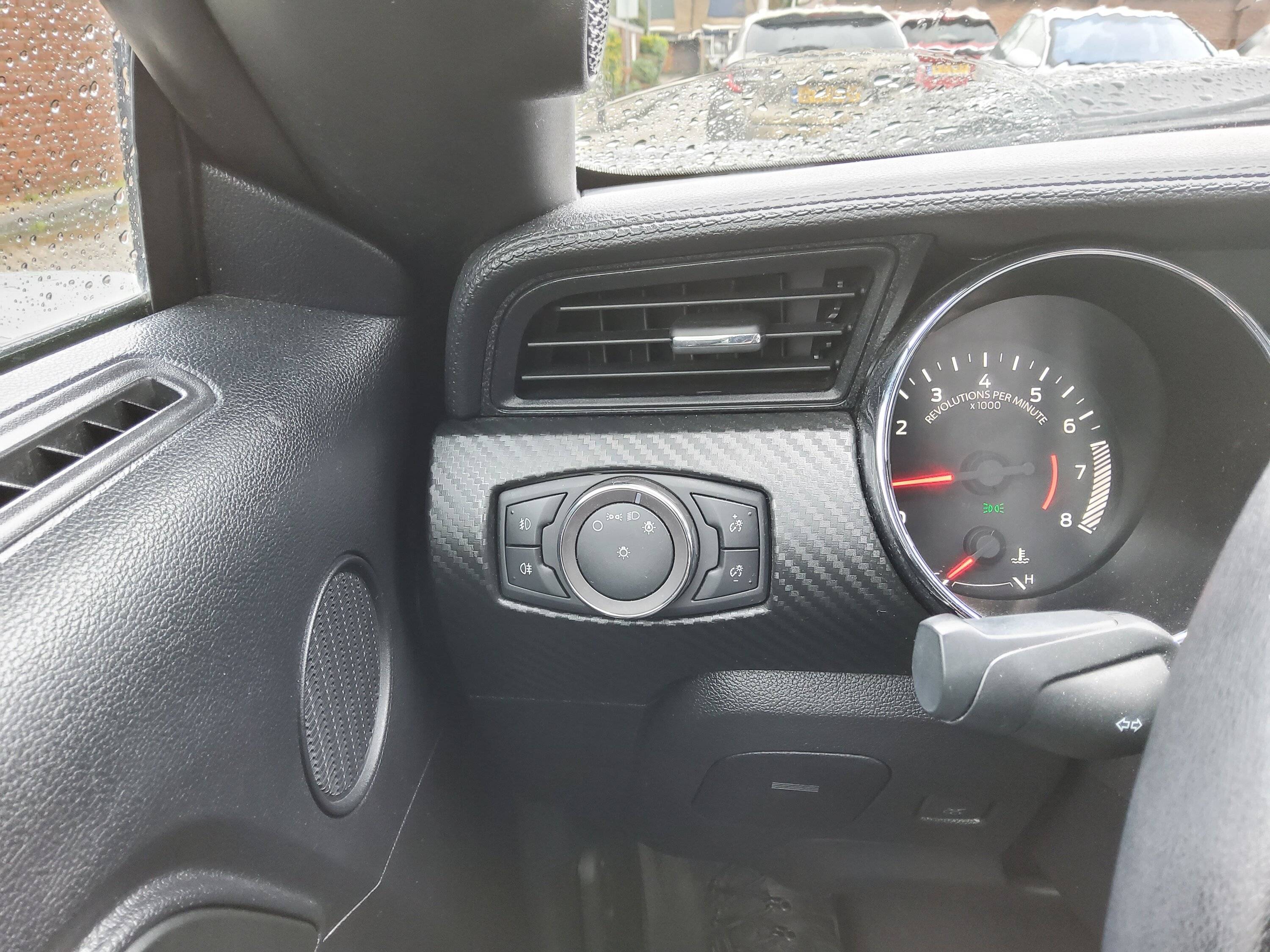

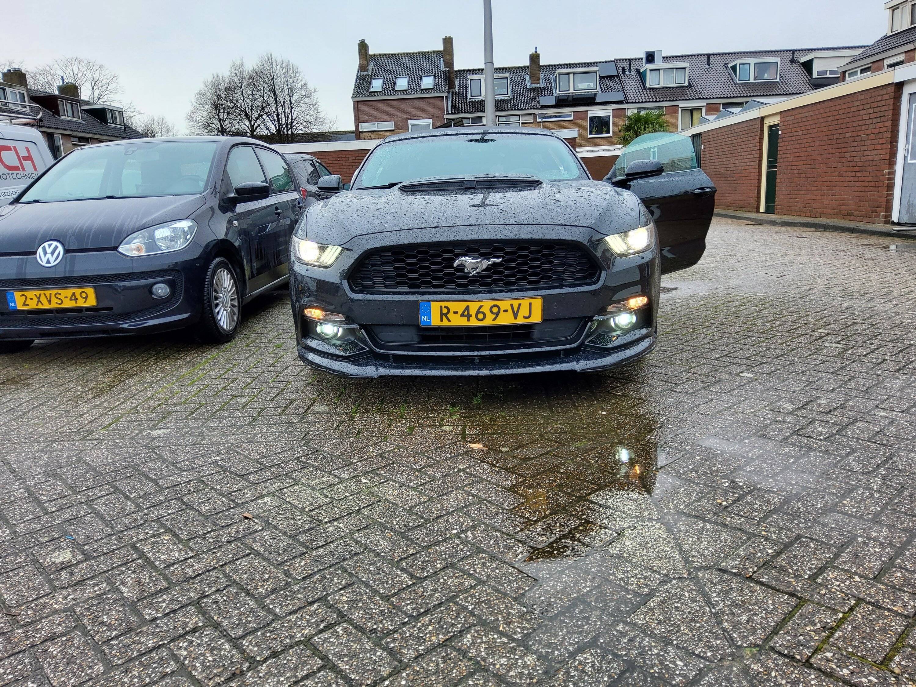

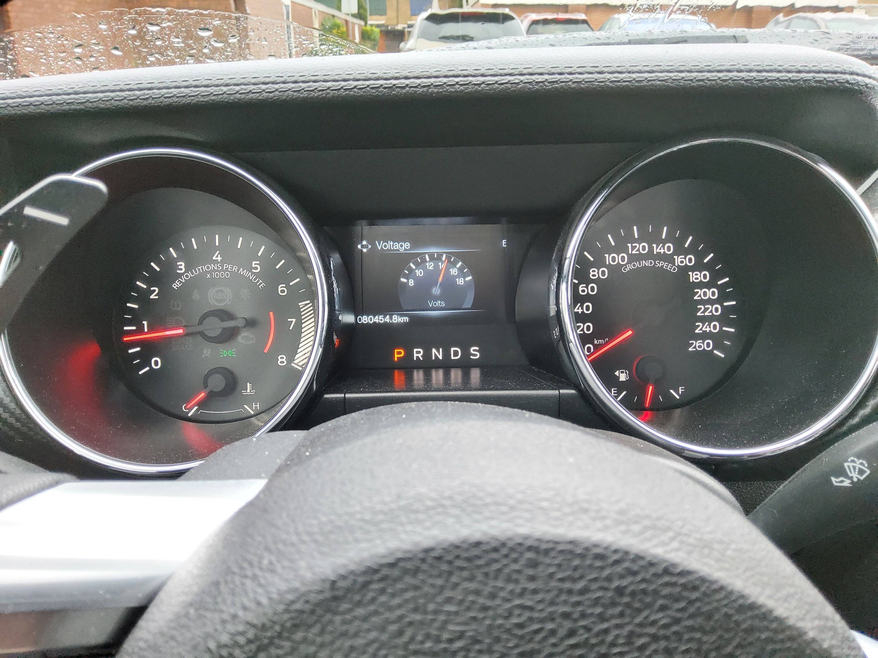

here are the fofos as promised, lights on...no indication
the dimming function is visible

you were right...with high beams on I can't activate fog lights Sorry
