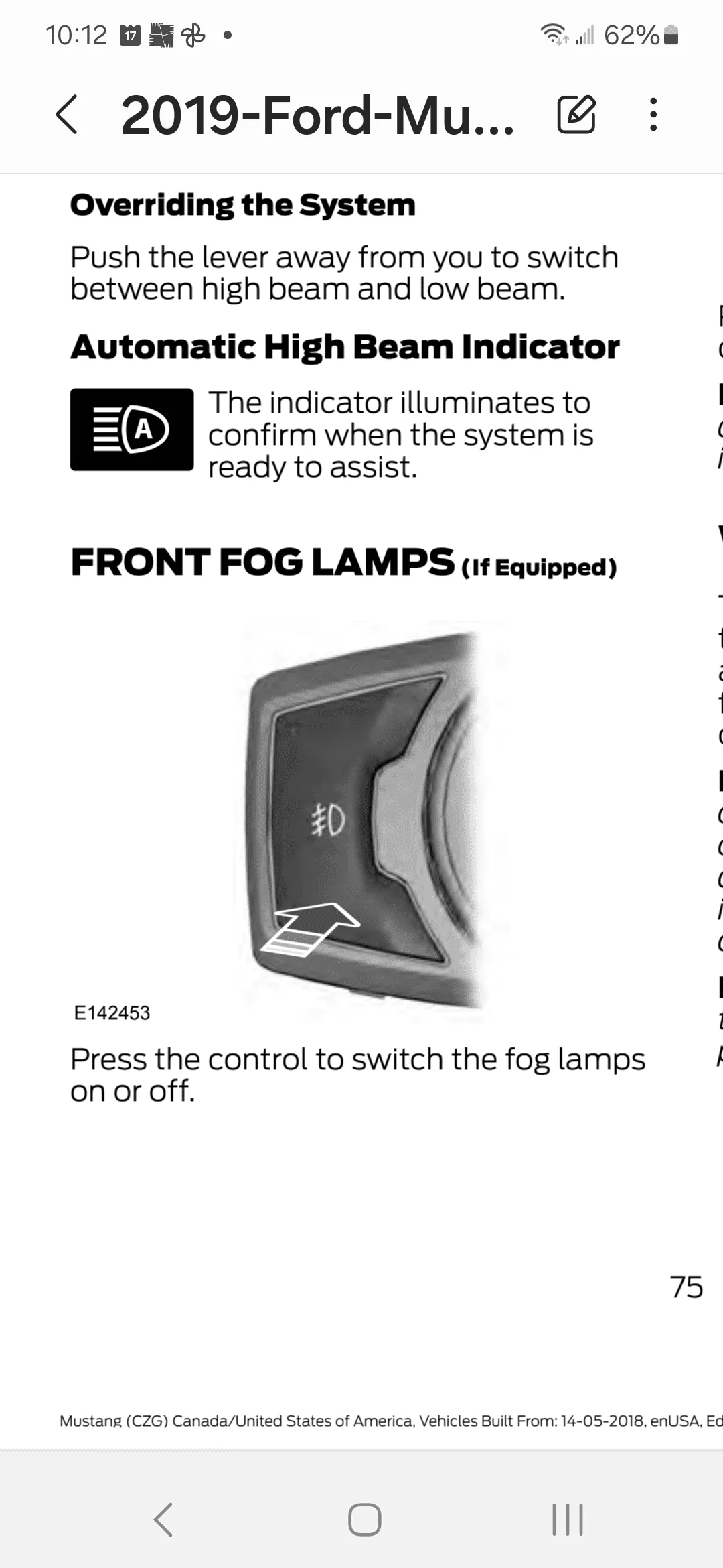

Just as a lark you can turn on off by flipping the fog light on off switch
Here's a pic of switch.maybe that resets indicator light

Thank you very much for the tip Tried it right away, with ignition on, with ignition off, and with moror on, motor off, unfortunately no results.
Fog lights turn on and off, but no indication is visible

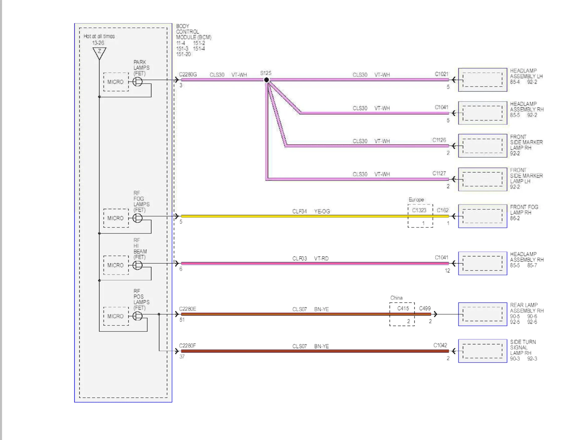

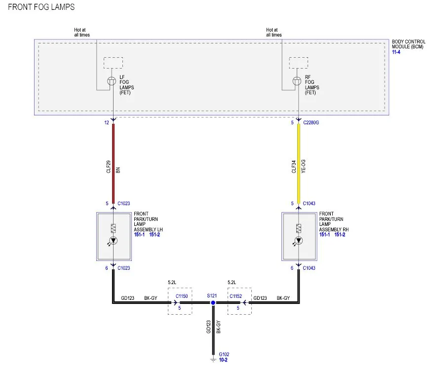

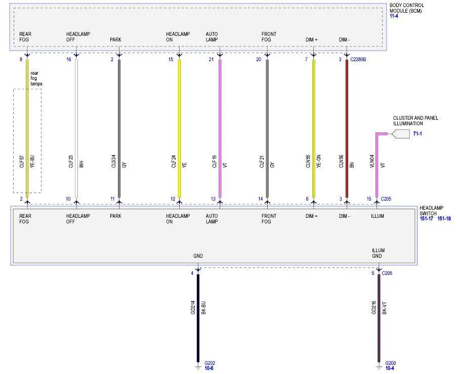

I've attached some schematics, to show relationships.
There are basically two pathways:
- One path goes from the Body Control Module A, (interior, right side, near floor) to the fog lights
- One path goes from the Body Control Module A to the headlight switch
https://www.fordservicecontent.com/...A&div=f&vFilteringEnabled=False&buildtype=web
I don't see where there is a dedicated fuse for fog lights, in either the 2015 or 2022 manuals They could be tied to the headlight circuit. IDK. I've never dug into this before.
Everyone is going to be different in how they approach things. Me, I'd leave it be. Maybe it'll work again. Maybe never. The problem started with a failed battery, which was replaced. I would not begin wire testing. I'd end up making it worse. :crazy:YMMV.
I've read a few other older threads from other sites. It's often like a logic hang. One poster had FORSCAN access: he toggled off a related feature, toggled it back on and the problem resolved itself.
I'm qualified at the Fisher Price level :giggle:, and will pause. But I am interested to see if the issue gets fixed.
