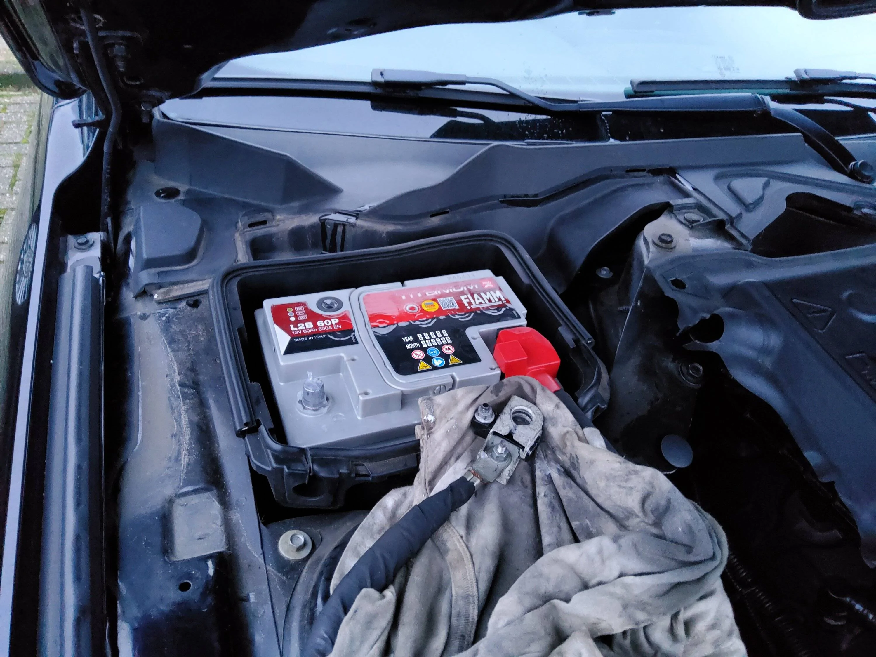

negative pole loose now wait
After connecting, wait 8 hours for test, and only then reset BCM?
Le Mans
Le Mans
Dec 20, 2022
57
3181ET
Rene
550 convertible 2015
Well..
just reconnected battery. lights out first.
Then BMS reset.
Battery indication flashed neatly 3x
Unfortunately.... no indication :(
Still having to reset everything I was afraid of: Language...Bar / psi. ..Sync.
I'm even more afraid of all the previous failures...rear window defroster. Seat heating. Air conditioning. etc etc
But just maybe.... maybe they'll come back after 8 hours
pffffff.
