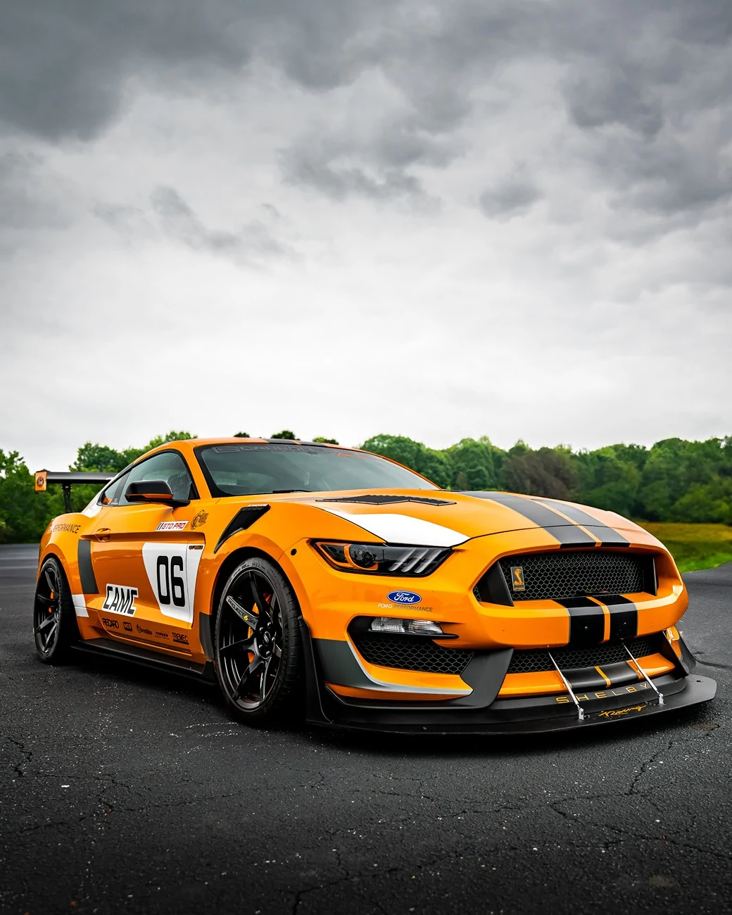

F that is a beautiful car.
I hope one day I can work up the courage to cut into my fender and hood to install the Race Louvers I bought that are just sitting on a shelf in my garage.
Look for another hood. I bought one off marketplace for $100 with slight damage, it was black so color neutral.
Good idea. That is what I did with my GTI. It's really the fenders that get me. But the pic of his Shelby certainly motivates me.
Thank you. Luckily I'd had previous experience cutting hoods so wasn't as nervous this time around.
