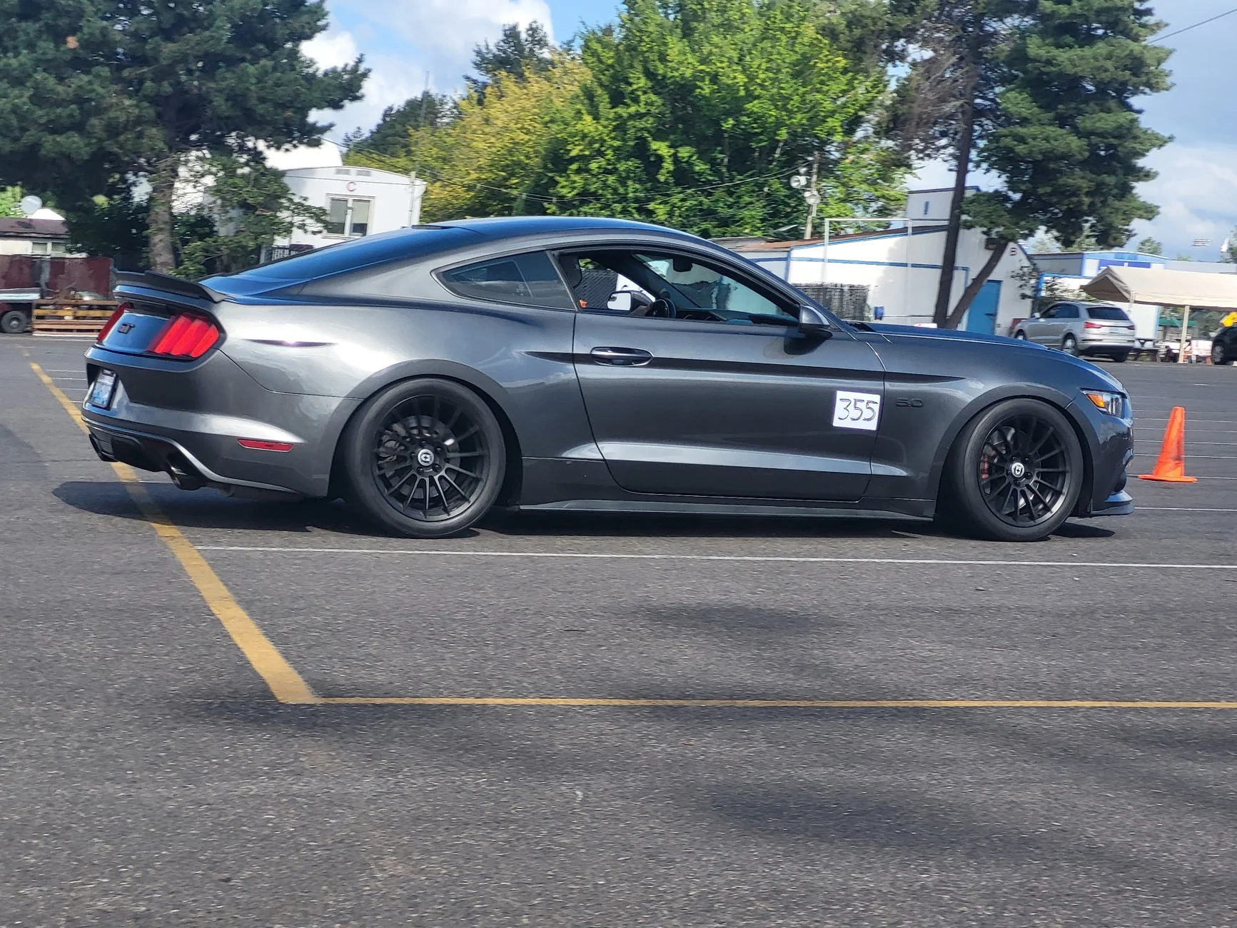

Current set-up: 16 GT PP with Brembos. Pedders coilovers and shocks sitting low, Pedders camber plates in front with max negative camber. Adjustable front sway bar links, but stock sway bars front and rear. Stop the hop kit for the IRS. 18x10.5 HRE wheels with Nitto NT01 305’s (I know not an ideal tire, but will likely get the Re71rz next season).
What do I do next to shave some time? I’m pretty competitive, but can be faster. Any ideas on the next couple of worthwhile mods? TIA

Beautiful car! I appreciate the information. I think you have given me a good start for the off season. I’ve probably got two more events that I can get to this season though so I’m tempted to start work on it now, lol! It would be nice to keep the 10.5” wheels I already have, but it seems like the 11” is just the way to go. Thanks again!
