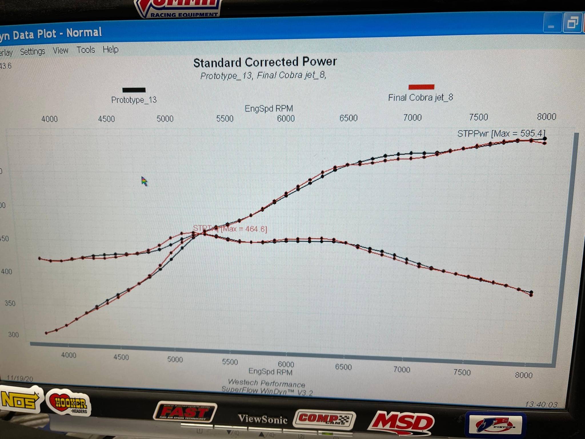

I'd really like to see the dyno sheet on it.

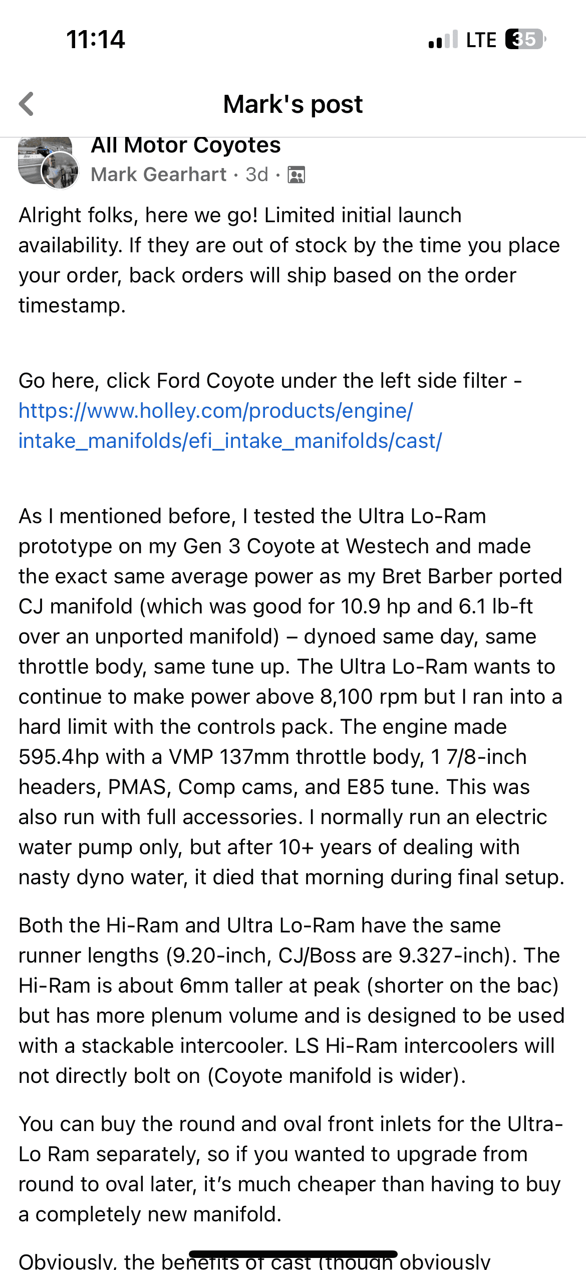

Only dyno sheet currently floating around attached with the post by the guy who did the testing (not a Holley employee btw).

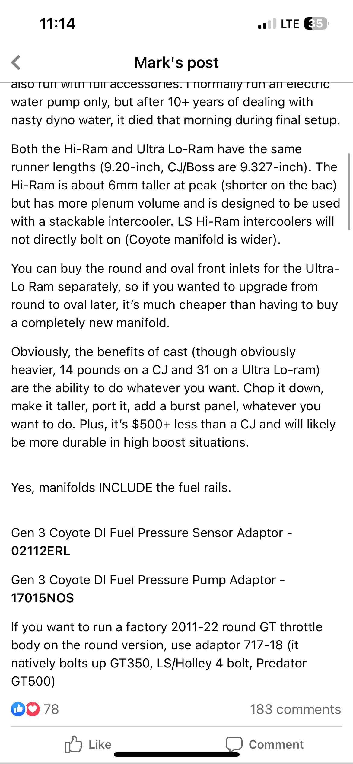

They said that it could be used for LS applications that’s why I mentioned the LS based motor and what has been proven to work. If it is shown to get good gains for our cars then send it.
I think you misunderstood. The round inlet uses the GT350 throttlebody bolt pattern but also LS throttlebodies.
