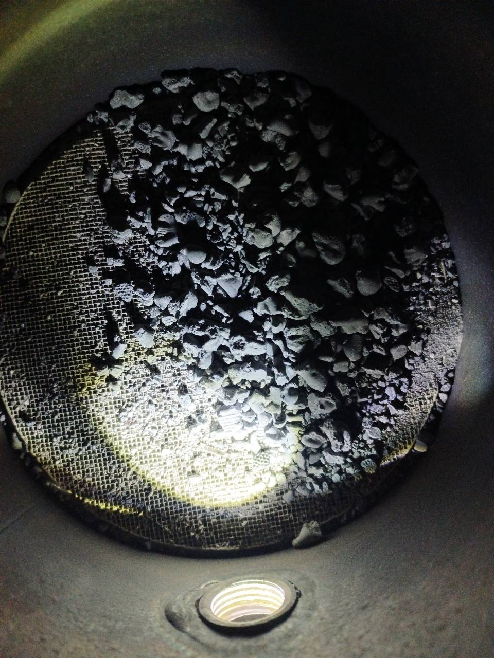

I've had a Gen5 Whipple for 2 years, roughly 20k miles since boosted about 80k total. Got a P0430 code, cleared it was fine for a few days. Now when doing WOT pull anything above 5500 RPM will throw a misfire code, P0430 came back as well. At first I was thinking bad plug injector maybe sensor before the misfire code. I contacted Whipple they said my one of my cats is most likely toast and i should replace both since the other one might not be far behind. Which makes total sense now that i think about it. bad cat clogged= misfire codes. Car is basically stock other than the blower and a cat back exhaust. From what I understand the header and cat is one piece on driver side and if I'm going to all the work pulling that i might as well throw LT's on it. I'm asking for options as it seems regardless which option i go with it wont be cheap. Haven't priced out stock cats but I'm sure they would be similar or a little less than a LT setup.
  1. LT's /Offroad pipes, Clutch (stock clutch on its last legs) Injectors BAP 132mm TB Custom tune $4k
  2. Replace cats, Clutch, stage 2 kit (whipple tune included) $2500ish ???
  3. Same as option 1 but with return style fuel pump. Only issue with this option id probably need driveline, shafts, and some engine modifications which will add a bit more to the price
Edit: Went with LT's/Offroad and clutch i'll add as needed later on. Just wanted to get the car back running again. So I pulled the headers WOW. Drivers side was totally plugged up.

Before you spend money on new cats, make sure your injectors are good. If 1 or more are flowing too much fuel that can prematurely burn out and/or clog your cats. Also throw on a set of fresh o2 sensors, if the cats are starting to clog, I can guarantee the o2's are contaminated and giving false readings.
The fact that you stated you felt it was down on power is a common result of cats that are clogging up. Modern cars have very precise fuel control compared to 30 years ago so if your cats are clogging, there is a reason. Most likely bad injectors.
Good point, I'm new to boost so I just didn't know if cats going bad sooner is normal or not. Like you said they wouldn't get clogged for no reason.
