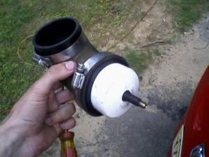

If your worried about a boost leak, make a leak tester. All you need is a short silicone coupler that fits over the inlet of the supercharger, 2 hose clamps, a PVC cap that fits snug inside the coupler, and a threaded schrader valve (available at any auto parts store).
Like this only bigger
pressurize the system to 10-20 psi. then spray your couplers, intercooler, intake etc. with soapy water. look for bubbles
