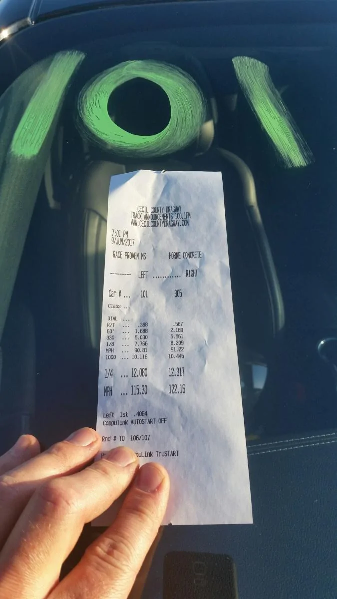

Get some slicks and a tune. I run hoosier's and pp2 tune. I back into the water box, light them up enough that smoke starts rolling off, let off brake and roll out of burnout, stage, Rev to 5k and let clutch out when I see the last yellow light. I'm shifting just over 7k. I would recommend running skinnies. Here's a pic of my best run so far. I'm in the left lane and a new zl1 is the looser in the right lane!:first:
