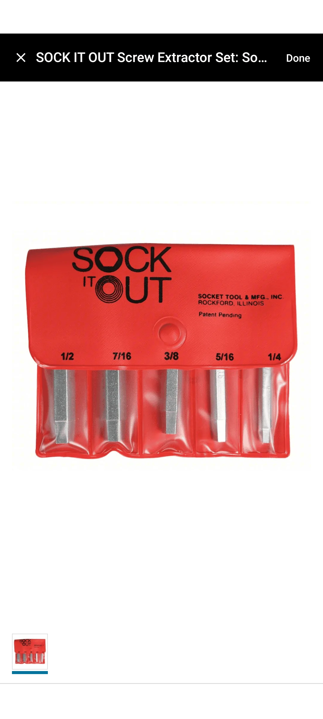

These work really well. Kind of hard to find. They are tapered. Tap in with a hammer and use a wrench or socket to remove. I use them often at work.

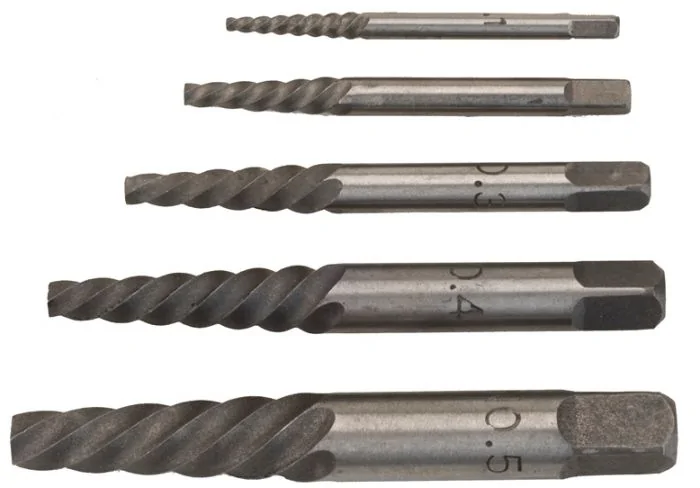

You could also try drilling through the center of plug and then use an easy out. I prefer the square easy outs, but that is just a personal preference. I have had better luck with them than the spiral ones.

I have tried easy outs but since the metal
Is so soft it can get a bite and strips
It even more. I don’t want to drill all the way through because I don’t want metal shaving inside. Sucks but seems like I am just going to send back to vortech and have them do it. Hopefully won’t be too expensive.
