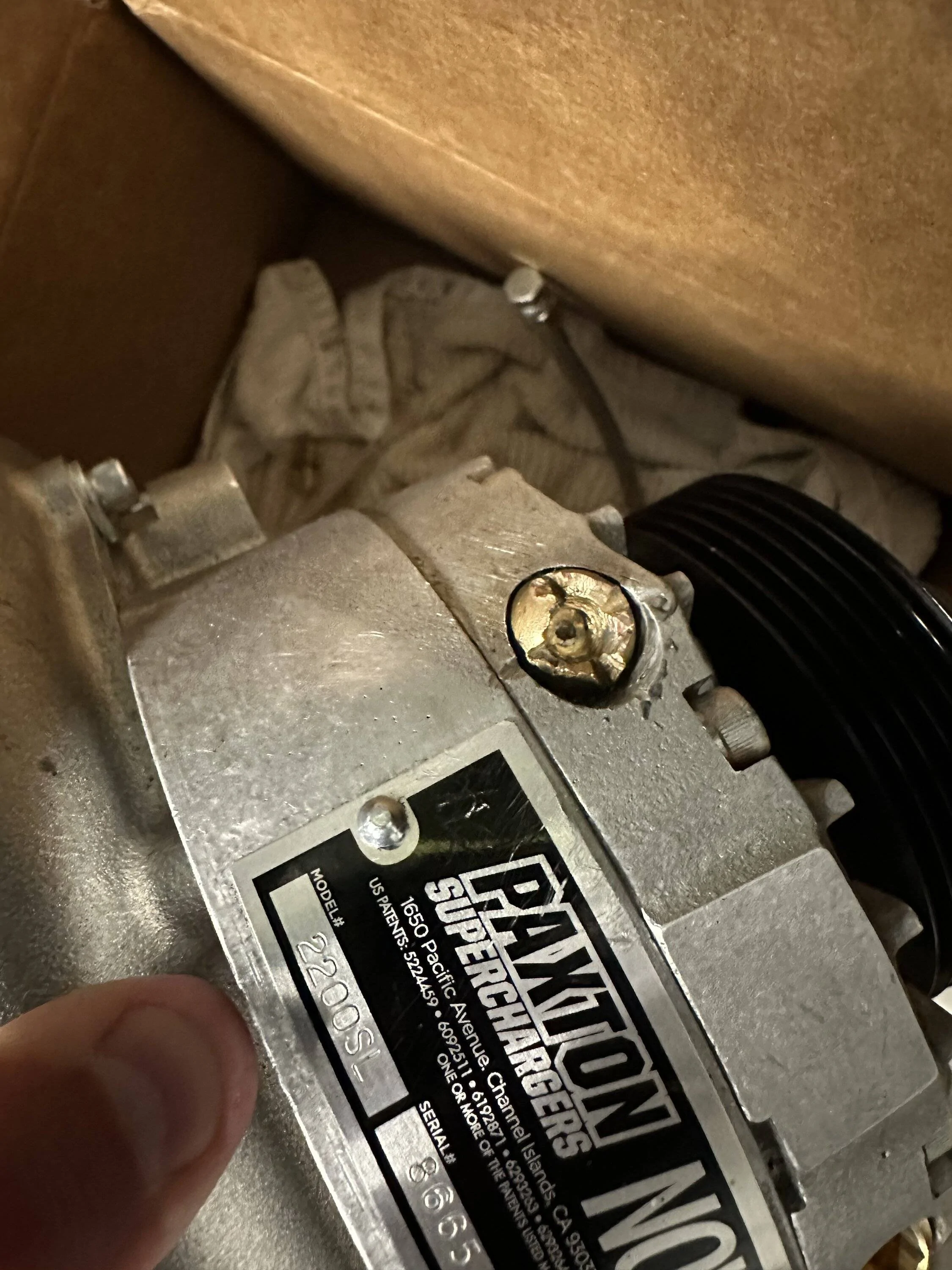

Do you have a photo of what it currently looks like? That may help with suggestions.
It’s possible nothing is adhering because you’ve tried so many different approaches. (Understandable of course.)
Brass is so soft, I can understand why this has gotten difficult, and frustrating.
If, you can get something to even bite a little on the plug, try blasting it with a can of compressed air. If you’ve ever used it, you’ll notice how if you keep blasting in the same spot it gets cold. That may be enough to shrink the brass just a little and help you wiggle your plug out.

Can you get a flat blade screwdriver across what you’ve already done? If so, I’d Fill the edges with PB Blaster, let sit 15. Jamb a flat blade in, and hit it with compressed air to freeze it. (From one of those little cans not your compressor.)
Between the lubricant and freezing, you might be able to wiggle it out.

I can’t get a good bit with a screw driver anymore. I can’t grind anymore because it’s starting grind into the case.

I can see why an easy out won’t work without a through hole drilled into the brass.
An induction heater might do the trick.
Work at getting the slot a bit better for a good grip and use an induction heater.

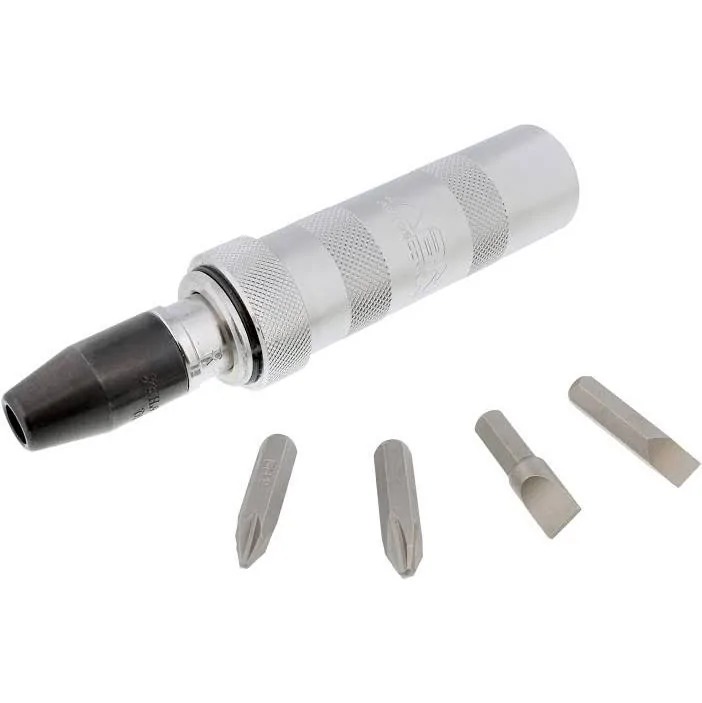

A good impact screwdriver is your friend.

I would cut a slit as far down as I could, then use a Good Common screwdriver which fits perfectly onto it and remove. I've been in similar situations just like what you are in now.
If I grind it down anymore it starts to get into the aluminum case of the supercharger.

I'm guessing pipe thread? Make a slot or jam a torx bit in the hole thats already there. Heat up the housing with propane, when nice and hot take the can of compressed air and spray the brass fitting then try to twist it out.
