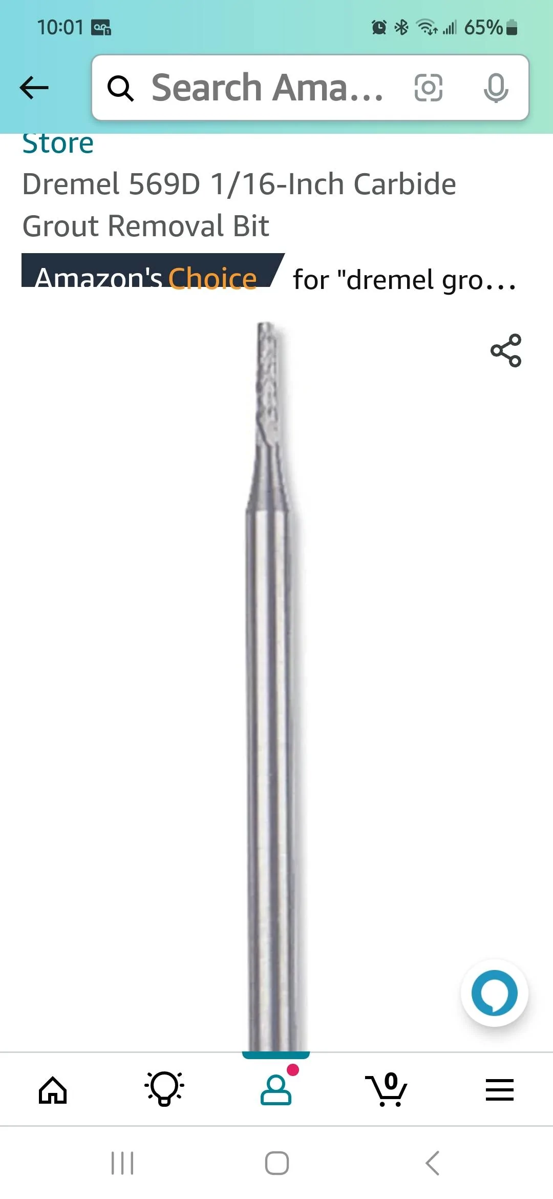

If I grind it down anymore it starts to get into the aluminum case of the supercharger.
Buy a diamond tip dremmel bit and cut the slit
I would use this, grind side to side until the slit is deep to where a good common screwdriver will fit snug.

You are amazing, that worked!
Thanks everyone for your assistance
