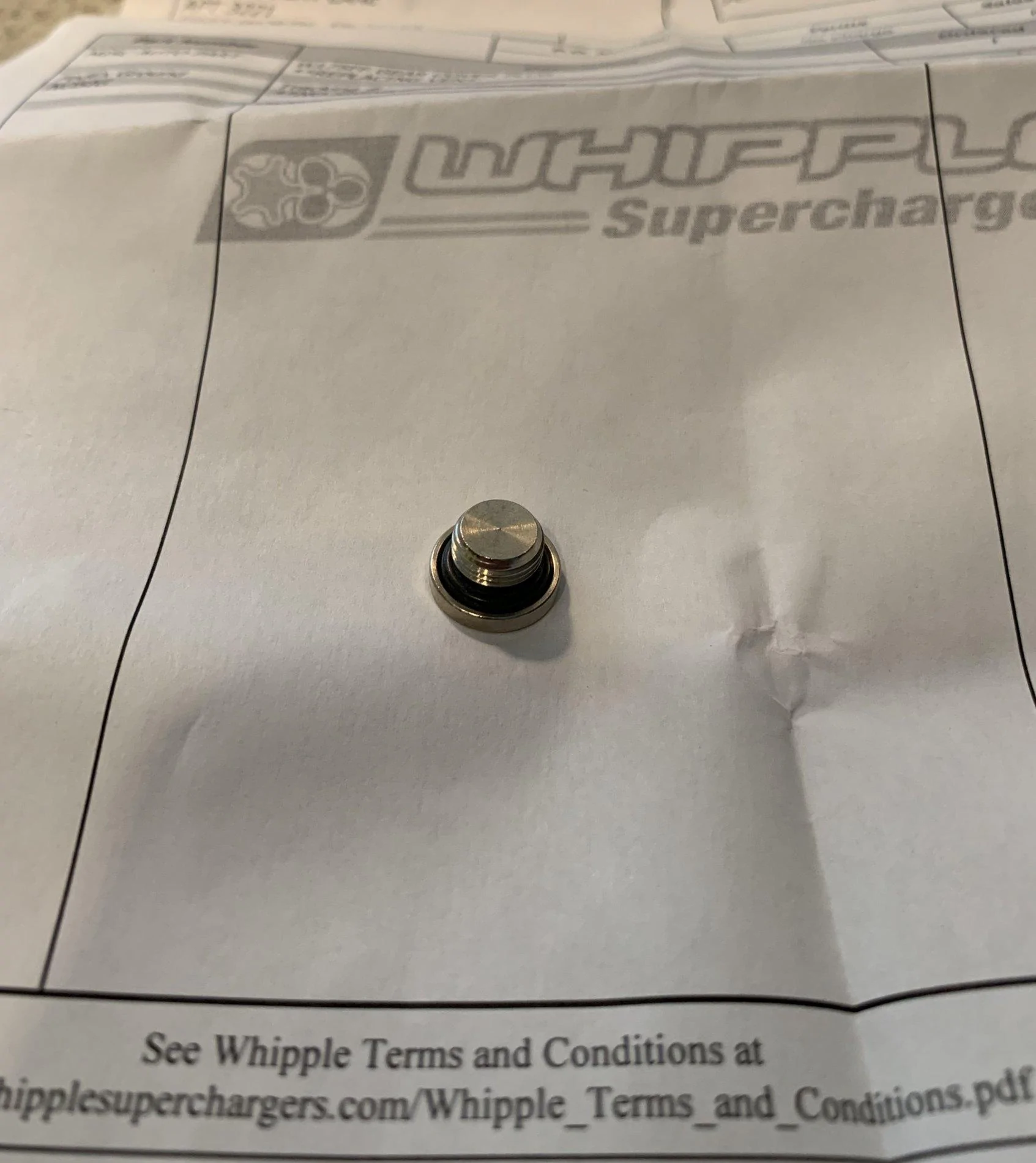

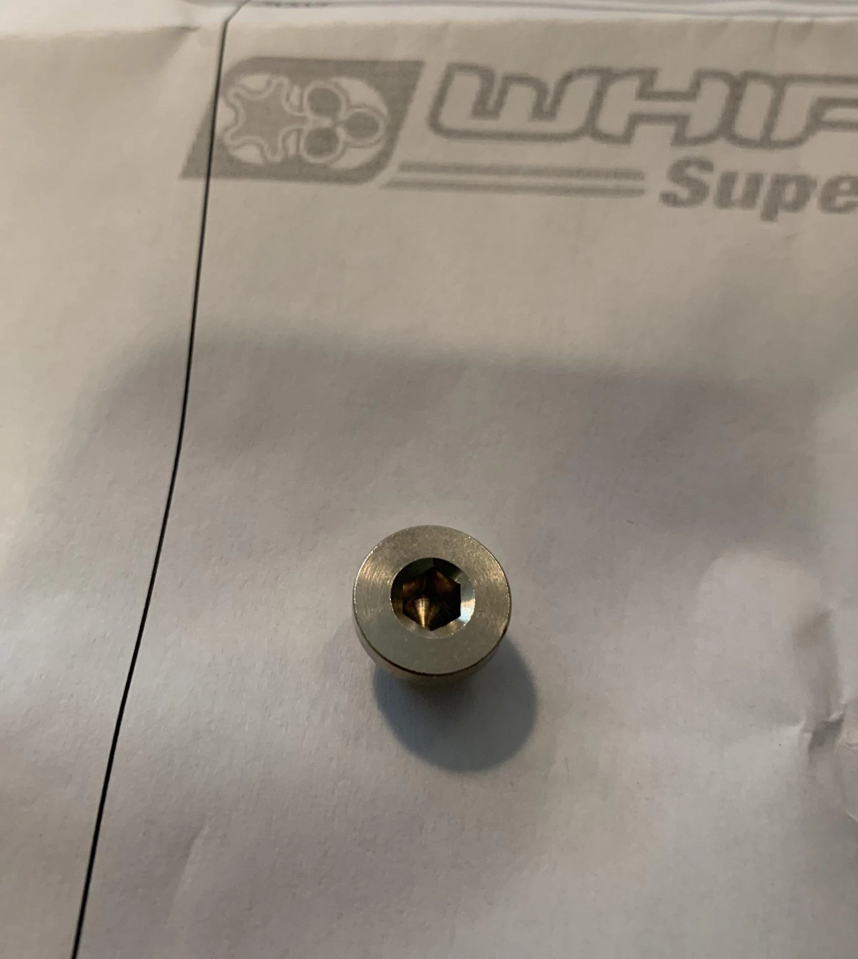

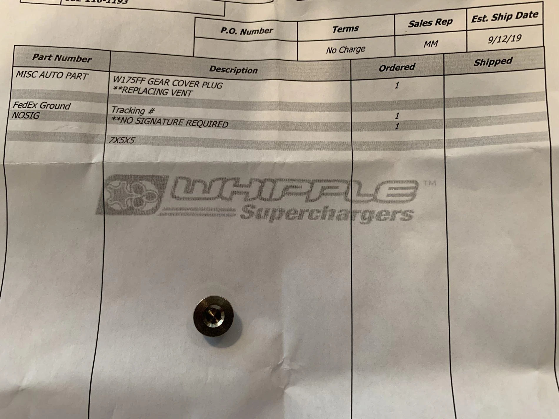

I contacted Whipple directly about this today. They’re sending me out their plug for this for free. I have a Gen 3 on the 3.375”. They had no concern regarding plugging it.

For anyone interested in the plug directly from Whipple
