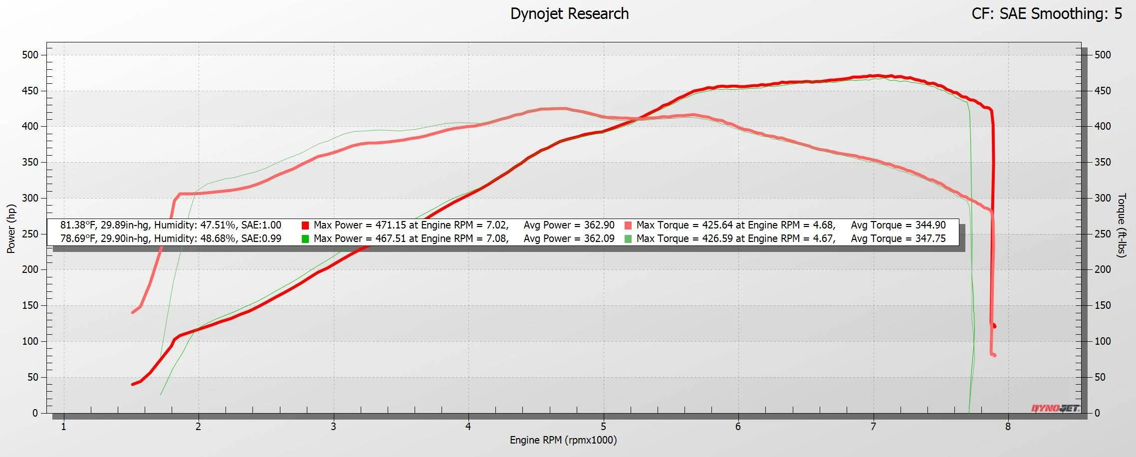

I made just over 470hp FBO "E72" w/ 10r80, long tubes with cats, no CJ, no cams. I think you're doing just fine. 10r80 or 6-speed ? Cats ? Would be good if you could display results in SAE not STD. Here's my results.
