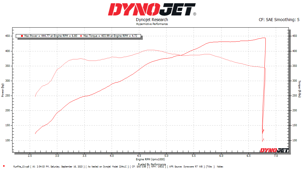

How much was it to do all that? Wonder if a supercharger would be more cost-effective. The Coyote seems to love boost.

Something is not right. With a CJ and those cams it should increase power to 7600 or higher.
My thoughts are either the tune or a piss poor job on the intake porting.

93 more HP is a lot more power.
What others claim, is just that. What others claim.
I don't understand why your original dyno-pull was stopped at 6500RPM
mine done pretty much the same, who was your tuner? ill post my sheet in a few

Seems odd that it falls flat at 6500. If you are thinking of another tuner, give Wengerd an email.
He ran it in 7th gear for the 10spd auto. He hit the speed limiter.

Umm humm mine 6 speed so 4th gear

Yep I got the 3.55 gear.

starting to wonder if doing a 3.73 gear swap would be worth it.
His after graph. HP peaks and flatlines at 6500. Seems like its not breathing up top. Probably stock exhaust diameter

I think mine is in the tune. I’m 3in header back.

I done two pull in 4th both times around 6700 it just stop pulling like it was being governed or something. I done another pull in 3rd and ran up to 7200. So at that point im like WTH
